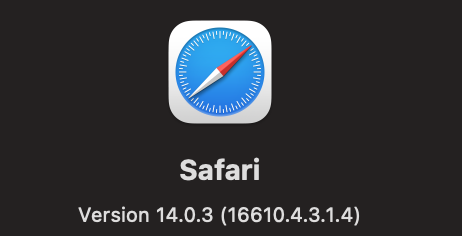

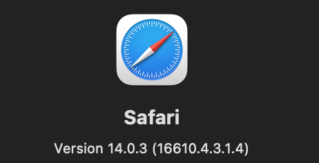

My iMac late 2012, 13,1 is configured to dual boot into two different versions of macOS. The fusion drive runs version 11.2 at the moment and 11.2.1 has just been installed on an external HDD drive using BKN's patcher version 0.5.1. The installation went smoothly, if rather slowly, via USB. Patch-kexts.sh restored the WiFi functionality.
Safari does not run and generates the attached error that the Safari version is not compatible with macOS 11.2.1, The Safari version is 14.1 compared with 14.03 that runs without problems under macOS 11.2.
Has anybody else seen this problem?
You may have installed the latest beta Safari, I was tempted to but it didn't like BS 11.2.1. This is my Safari version that does work with BS 11.2.1-

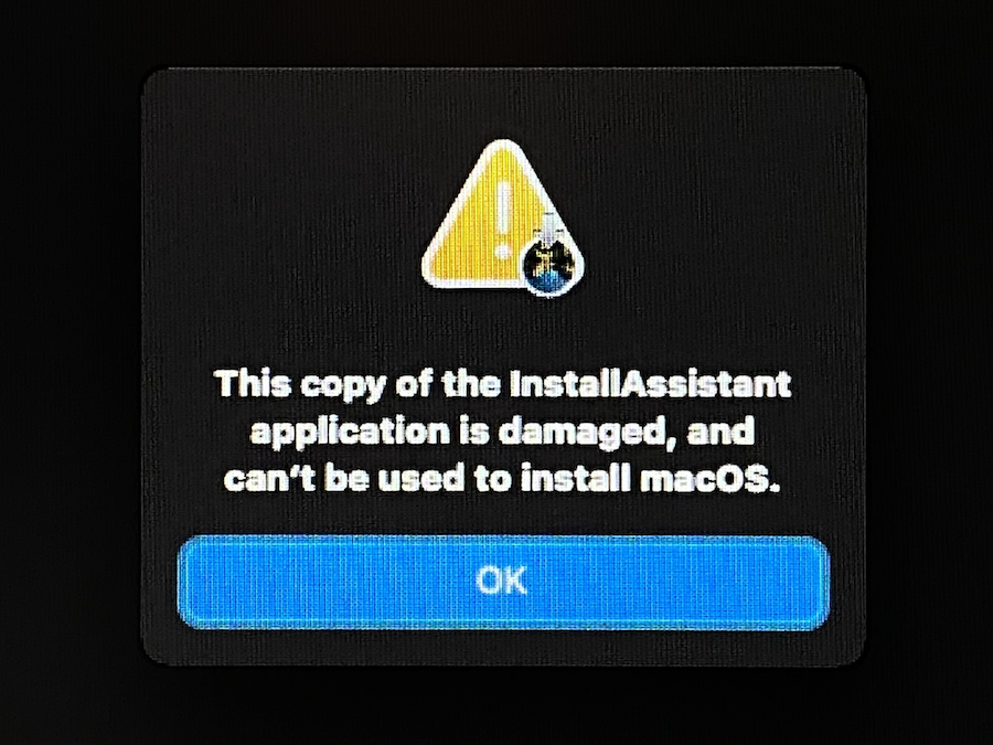

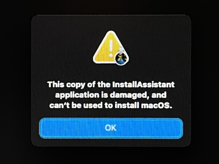

This is how you create a bootable installer from a pkg, but keep in mind if you are trying to create a bootable installer with 11.3 beta 2 you might run into an error like I did that said the installer was damaged (not sure why because this never happened to me before with any betas or regular releases). I had to instead make a bootable 11.3 beta 1 installer and use opencore to update to 11.3 beta 2 successfully.
Same thing happened to me with 11.3 beta 2 after making a bootable installer, when I was about to install it it told me the installer was damaged. I had to install 11.3 beta 1, then update to 11.3 beta 2 with opencore.
Two pages back the micropatcher 0.5.1 worked with the 11.2.1 - so something you may have missed.
Thank you very much, i did exactly the same as your tutorial, and of course, as you say,i had the installer damaged error
I was talking about 11.3 beta 2

Hi! If I add this to Barry's 0.5.1 patcher in order to install the 11.3 beta 2 might work? Thanks!
Go back three posts. There is currently no evidence that the micropatcher is broken if you get an „installer damaged“ error. Just wanted to make sure that you do not claim things which are unproven, yet. Your posts are persistent and may confuse others.
A message like „I have problems with Big Sur X and micropatcher Y„ will describe the true situation much more appropriately.
Reactions: David403
Please just download and test again or change the USB device. The micropatcher 0.5.1 works fine with this version of Big Sur according to this post.
Ok, sorry but...relax, no need to be so aggressive
Edit:
Even @dosdude1 put a warning like this on his own download page. Downloading 12GB of data and creating an USB installer is not a complete error free process. A single bit flip may cause such problems and the file systems we use cannot detect such problems (unlike ZFS and possibly the new APFS).
HI! Just tried again downloading the installer and the 0.5.1 patcher and when trying to install got the same error... The USB I am using is new... Do you have by any chance a link for the installer? Appreciated...

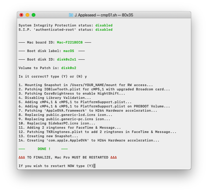

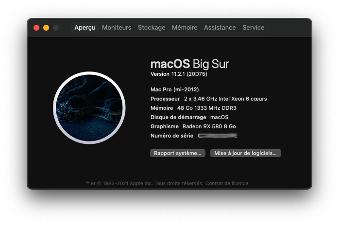

I can confirm that I have successfully installed 11.2.1 with Barry's micropatcher 0.5.1 since 5 days and all is working well.
I also wrote a script to automate some tasks:
To check if SIP is disabled
To mount snapshot to RW access
To replace "CoreBrightness.framework" (thanks @jackluke) to get functional NightShift,
To disable Library Validation
To add cMP5,1 board ID with PlistBuddy in "SystemParameters.plist" into "IOBluetooth.framework" to get Continuity
To add cMP5,1 board ID with PlistBuddy in "Info.plist" into "AppleGVA.framework" to enable H264 Hardware acceleration
To create "com.apple.AppleGVA" to enable H264 Hardware acceleration
To add cMP5,1 board ID with PlistBuddy in "/S/L/CoreService/PlatformSupport.plist"
To add cMP5,1 board ID with PlistBuddy in "PlatformSupport.plist" on PREBOOT Volume
To copy 2 ringtones for Message & FaceTime in "/S/L/PrivateFrameworks/ToneLibrary.framework/Versions/A/Resources/Ringtones/"
To add 2 ringtones for Message & FaceTime with PlistBuddy in "TKRingtones.plist" into "ToneKit.framework"
To create a new snapshot
To restart automatically after executing all these tasks

Download the pkg, install it. After installed go to Applications folder, right click the "Install macOS Big Sur Beta" and click "Show Package Contents" then open "Contents" folder, then "Resources" folder. Open terminal and type sudo with a space after it, then drag the "CreateInstallMedia" from the Resources folder into the terminal window. Put a space and then write --volume with a space after that, then drag your Flash drive (USB stick or whatever) into the terminal window and hit enter, that's it. If you're using the multi patcher don't forget to patch the flash drive after it's done.
Not sure where the Safari beta came from; was probably with a beta of Big Sur. The HDD was installed so that various software could be installed without risking unwanted changes to the fusion drive. The HDD was reformatted and now runs Big Sur 11.2.1 and Safari 14.03 without problems.
I just want to mention that up to now I have never had any issues updating to a new version of BS betas. Thank you.
Hi everyone.
I'm running smoothly Big Sur 11.2.1 (20D75) on my MBPr mid 2012, but when I tried to install BS 11.3 beta 2 I got the same error as furdi (EDIT: I meant using micropatcher 0.5.1). No errors are prompted while patching the USB drive. I downloaded BS via gibMacOs.
To get functional Continuity, to add my cMP5,1 board ID with PlistBuddy in "Info.plist" into "AppleGVA.framework" to enable H264 Hardware acceleration
