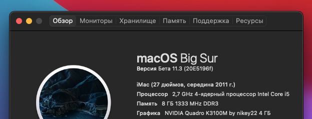

Updated MacOS Big Sur 11.3 Beta4 via OCLP 0.0.9 (OTA Update) to 11.3 Beta5 on Mac Pro 3.1 without issues
Reactions: yezza and Dr_T
1. MicropatcherAutomator + Big Sur 11.2.3
2. Patched-Sur + Big Sur Beta 11.3
3. Happy End
