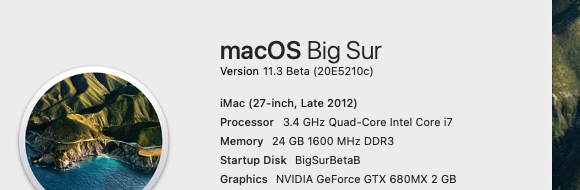

Reporting successful installation of Big Sur 11.3beta4 on late 2012 iMac 13,2
Method used: @Barry K. Nathan micro patcher 0.5.1 - see page 351 post# 8767 for installation details and cross-references.

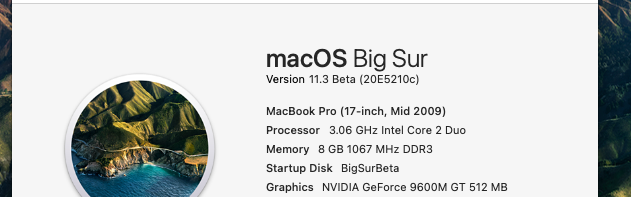

Successful installation of Big Sur 11.3beta4 on 2009 Mac Book Pro 5,2
Method used: BigSurFixes by @jackluke and @ASentientBot's Hax3lib - see page 351 post# 8767 for installation details.

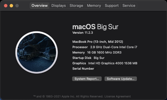

I'm reporting a successful installation of Big Sur 11.2.3 on my Mid 2012 13-inch MacBook Pro with functional wifi.

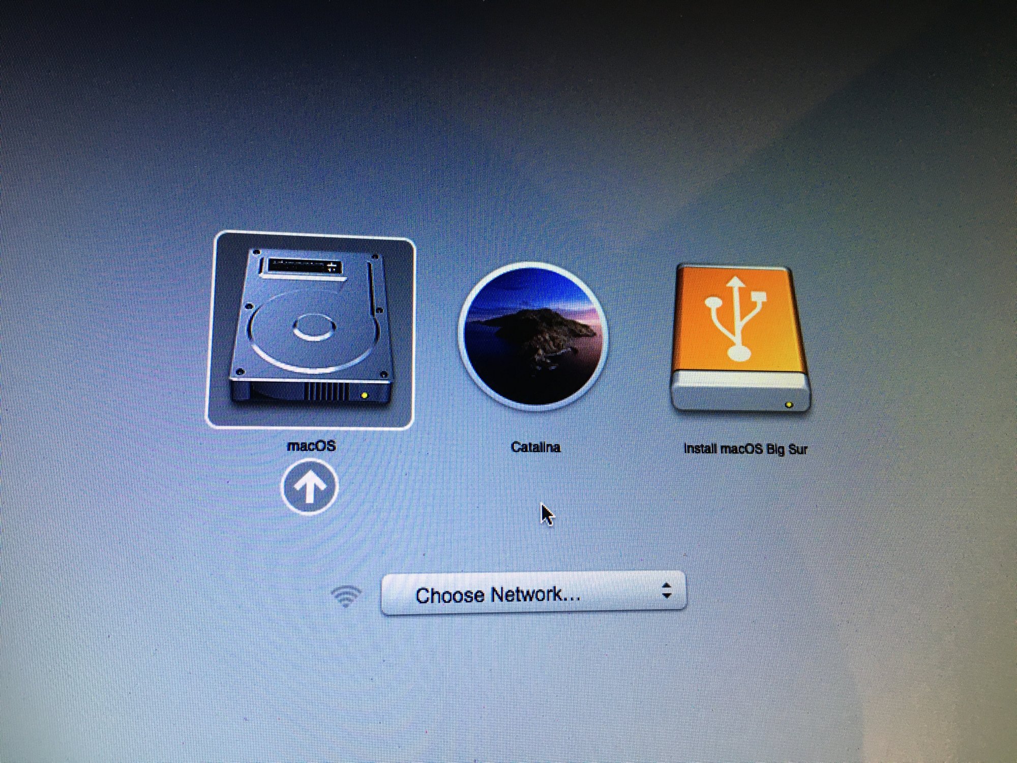

I am attempting to install the latest Big Sur using MiscroPatcher Automator and after I create the USB and restart, when I hold down option I have no “efi boot”, I only have “Install macOS Big Sur”. I was wondering if there is an issue with the newest release or if this is the way it is now.
Any help would be greatly appreciated. Thank you!
Check the partition scheme of the USB!
Step 2 of the docs:
  1. Format your USB drive as Mac OS Extended (Journaled) with GUID Partition Scheme using Disk Utility.

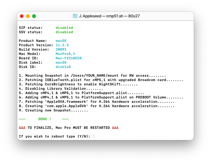

I finally finished my script for cMP5,1 with upgraded Brandcom card
I gladly share it in order to add it to the different Patcher, if necessary.
I ran it after the various installs from 11.1 to 11.2.3 without any problems.
It checks if the started Volume is really Big Sur
It checks if SIP & SSV are disabled
It creates a folder in "Home" to mount the snapshot, then:
It patches "IOBluetooth.plist" for cMP5,1 with upgraded Brandcom card
It adds "CoreBrigthness.framework" to activate NightShift (thanks to @jackluke )
It deactivates Library Validation
It adds cMP4,1 and cMP5,1 to "PlatformSupport.plist
It adds cMP4,1 and cMP5,1 to "PlatformSupport.plist" in PREBOOT Volume
It patches "AppleGVA.framework" for H.264 acceleration
It creates "com.apple.AppleGVA" for H.264 acceleration
It recreates the Snapshot
Finally, it asks to reboot the cMP
The use is very simple, after the normal installation of Big Sur and access to the Desktop, all you have to do is unzip the "_cMP51_PATCH_.zip" archive on the Desktop, run Terminal, type "sudo" and Drag & Drop "cmp51.sh" contained in the unzipped "_cMP51_PATCH_" folder on the Desktop. And restart when requested...

Hello to all
Hi @Ausdauersportler
It adds cMP4,1 and cMP5,1 to "PlateformSupport.plist
It adds cMP4,1 and cMP5,1 to "PlateformSupport.plist" in PREBOOT Volume
Many thanks alphascorp! I noticed a typo: PlateformSupport.plist vs. PlatformSupport.plist. I'm betting the later is correct. :)
