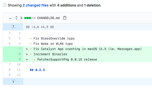

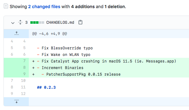

Apparently Messages needs a metal GPU on 11.5, see issue #405.
Looks like the most current 0.2.4 build of OCLP has fixed Messages.app crashing in Big Sur 11.5.
(Don’t know if this is especially a fix for non-metal graphics or a more general one, though.)
Confirmed - latest OCLP TUI Nightly returns the apps 10.5 killed since Beta 1 to normal operation. Looks good, so far. Big thanks to @khronokernel and @ASentientBot for implementation. 🥳

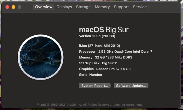

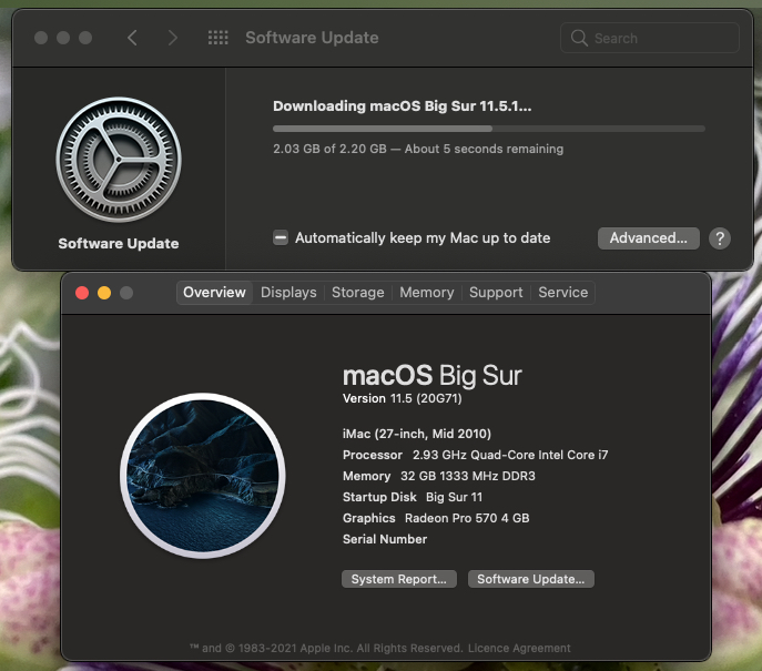

The July26 midnightly OCLP 024 TUI holds up nicely on macOS 11.5.1. Everything intact from OTA update over 11.5. Brilliant. 😎

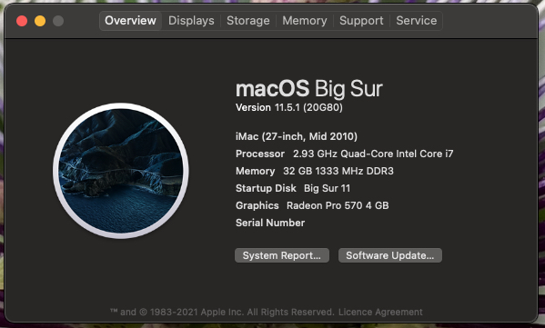

macOS 11.5.1 is working great so far on an iMac 12,1. Amazing to be able to run this on a machine that's about ten years old.

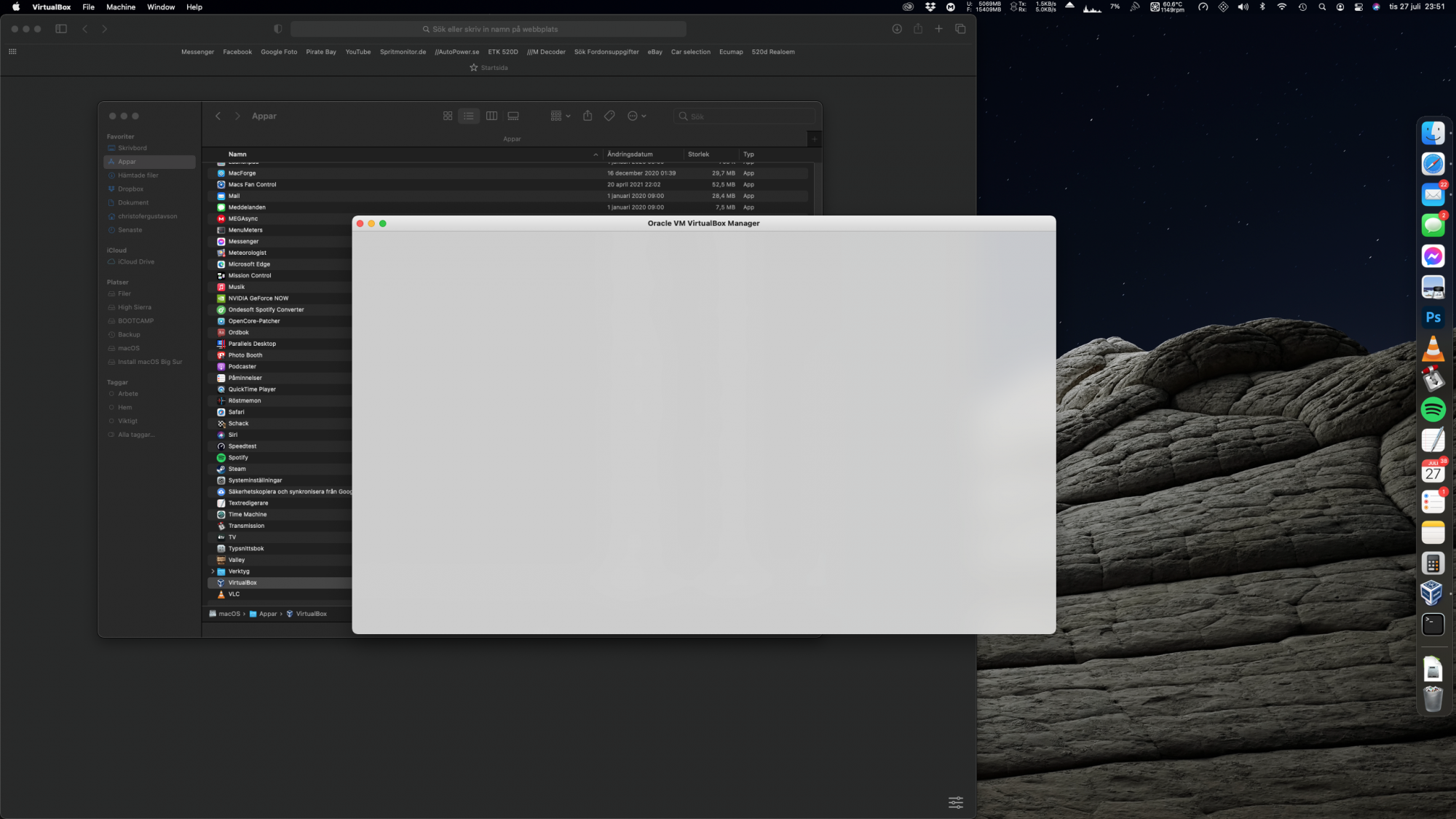

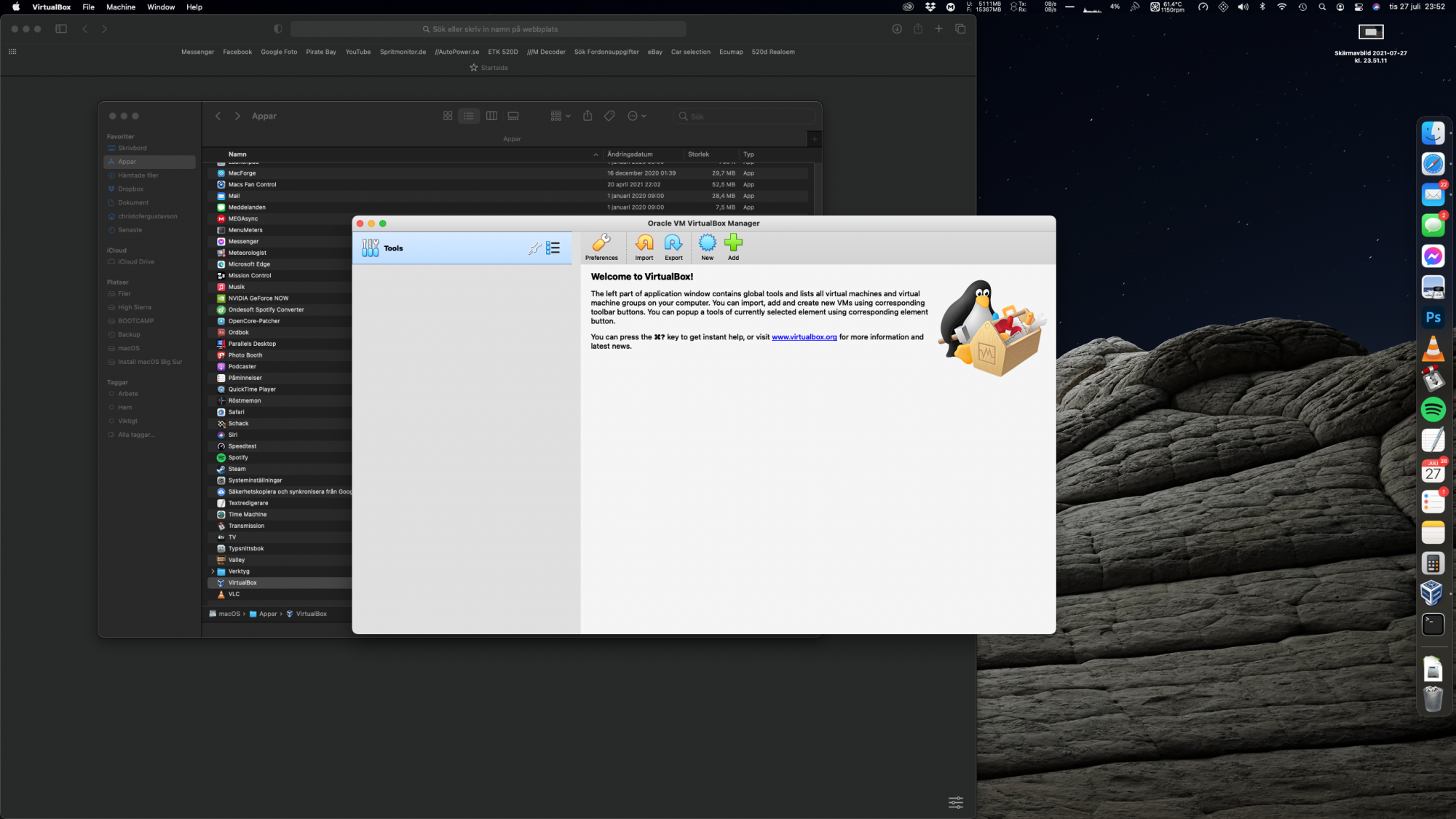

I´m having problem with some apps. its a 1/10 that the app actually displays anything in the window. I have to restart the app over and over again to eventually get anything else than a empty gray or white window.
Anyone else with the same problem?
After like 10 tries it eventually shows the app.
