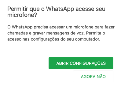

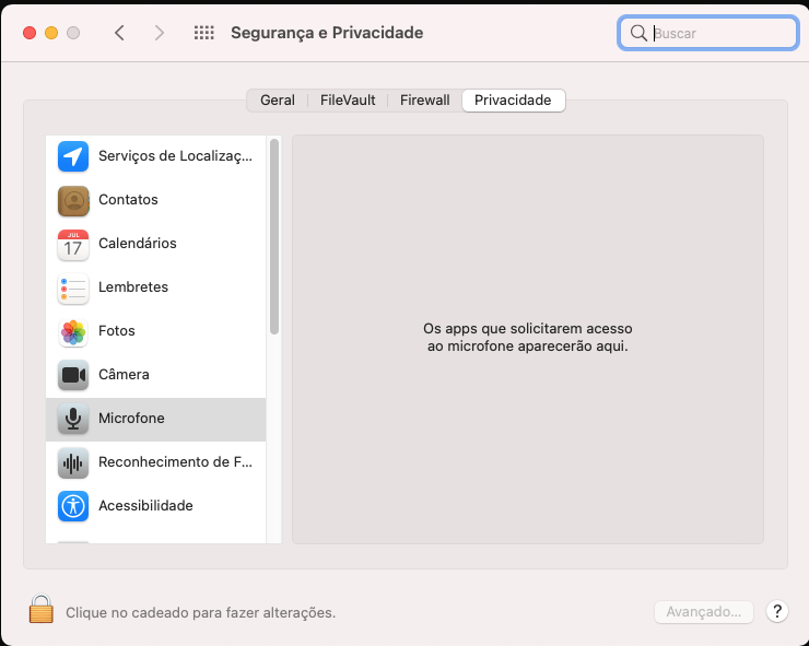

Pessoal, instalei o bigsur 11.5.1, mas nenhum app tem acesso a minha câmera e microfone. Mesmo indo em Segurança> Privacidade, no app parece permitir, você sabe como resolver isso? poderia ser o efeito da atualização 11.5.1?
Portuguese translation, courtesy of Google:
"Guys, I installed bigsur 11.5.1, but no app has access to my camera and microphone. Even if you go to Security > Privacy, the app seems to allow it, do you know how to fix it? could it be the effect of the 11.5.1 update?".
Try to read the OCLP online docs on Github - it is a more valuable source than you can imagine!
And: enable AMFI again
