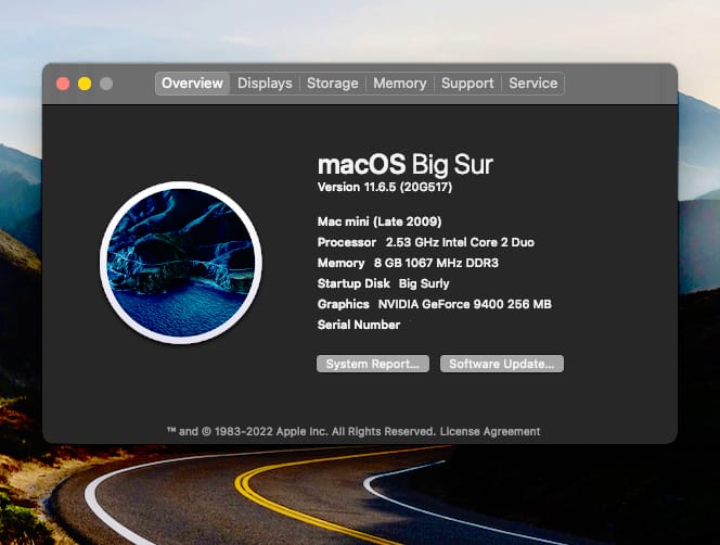

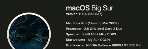

MBP5,2 updated to 11.6.5 release candidate(?) OTA from 11.6.4 which was installed from InstallAssistant.pkg. Using OCLP 0.4.3 nightly from 14 Feb. Using an external SSD for betas or non-final releases.
I thought I saw the 20G517 earlier as a 11.6.4.

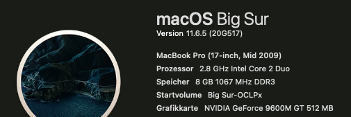

Ach so.
Alles gute.
Oh, and I just had a look at 0.4.3N without installing it: There's a new option in the non-metal settings. You can check "Dark menu bar". So the issue is known and already solved.
EDIT: Now I removed the spelling mistakes. Auto-correction went crazy, just because I answered to two lines in German. 🙈 Zum Mäusemelken!

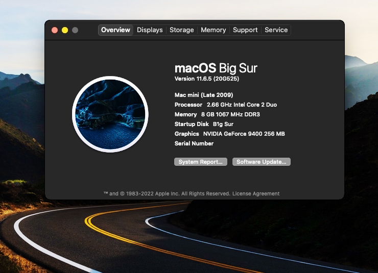

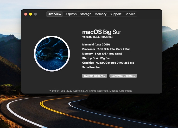

macOS 11.6.5RC1 atop 11.6.5b2 OTA via OCLP_043N, always impressive. :cool:
MBP5,2: 11.6.5RC (20G525) installed over previous version. Using OCLP latest 0.4.3n version as boot EFI and for post-install patching.
The system is on an external SSD connected via USB3 (nanoTECH expresscard with FL1100). It can be booted from there thanks to OCLP XHCI Boot setting. So despite external SSD things run quite fast.
(The OCLP EFI used is on the internal disk not on USB3 as the Apple boot selector can't see it there.)
