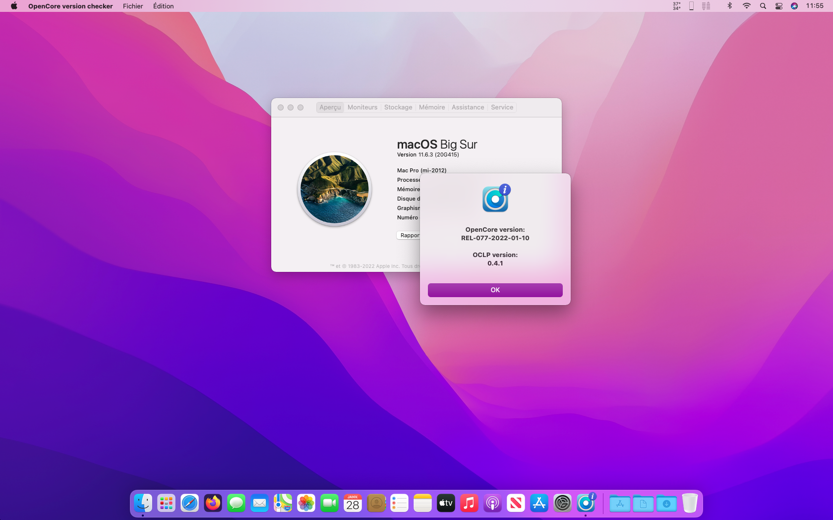

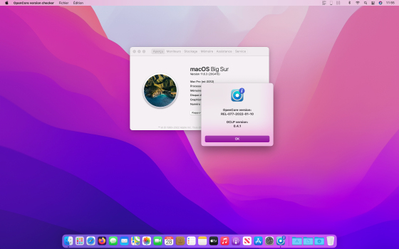

Hi all
cMP4,1>5,1 successfully updated from 11.6.2 to 11.6.3 with OCLP 0.4.1 via full installer on USB stick.
I haven't been very present on this forum in recent months but I was able to follow the progress of OCLP with great attention.
Once again I would like to say a big thank you to everyone for all the great work done with OCLP.

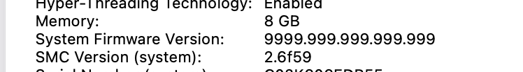

Hi, I've updated to OCLP 0.4.1R. My iMac 13,1 is fully supported by Big Sur. However I can't upgrade to 11.6.3. The OTA download completed, prepared and proceeded to installation. After rebooting and 10 minutes counting down, I was presented with the login screen. After that, there was a notification saying that the update was not possible and I'm still on 11.6.2. Any clue as to what's wrong?
My OPLP settings use the new default spoofless mode. Should I set it to minimal?

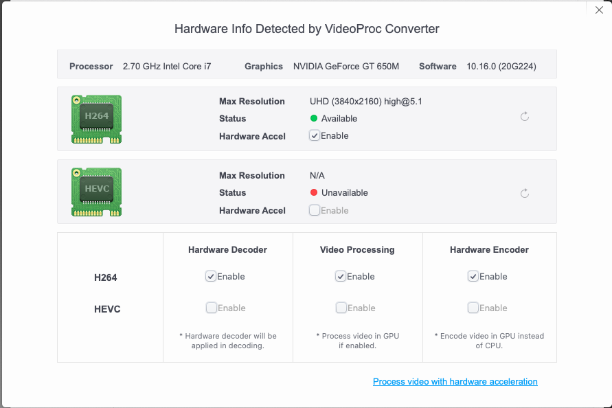

Is there any reason why my daily driver might not have the HVEC acceleration? Is that only with the Mac Pro Radeon cards that OCLP does that? It's not important, just hoping something might fill me in. The computer itself is a beauty with Big Sur. Just about to do some video editing, and wondered if this machine had full HWAccel with the new OS.
Thanks!

Paul, you might want to state what machine you're referring to by putting it in your user profile signature. This will save everyone the time spent scrolling back through to find previous posts where you might have mentioned it. And you might get quicker replies.
Reactions: TimmuJapan
That would be ideal if I didn't have multiple machines I'm asking about (I refurbish Macs), also for the last message, I attached a video proc image that has the exact model I was talking about. I thought that was enough.
Reactions: rehkram
Thanks!
Yes, HEVC is a feature you get only with modern Intel iGPU (not 100% sure, but at least 2012, maybe later) or AMD dGPU (2016/17 Polaris and later). No Nvidia support within macOS.
Nevertheless it would be a nice move always to provide the full system information. I hate guessing and after some years here on the thread I decided simply not to answer if a request comes in incomplete or off topic.

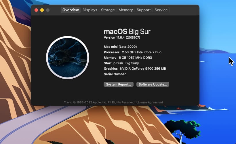

It is with some nostalgia ;-/ that I can report that Big Sur 11.6.4 RC (20G507) is pushing through BIOS updates again (or at least just did so to my MacBookPro10,2 spoofed as a MacBookPro11,1).
I got the classic semi-brick: black screen, powers up external peripherals only. Requires disassembly sufficient to disconnect battery, then hold power switch for ~10s to ensure all capacitors fully discharged, then reconnect and reassemble.
I have been running without patched System Firmware Version (I guess I must like to live dangerously ;) - or at least keep an eye on what's going on behind the scenes) but I have not seen this for a while, i.e. months.
So before applying this update, I would recommend making sure that your System Firmware Version as reported in macOS System Information is 9999.0.0.0.0 or 9999.999.999.999.999 - or have your pentalobe screwdrivers ready!
