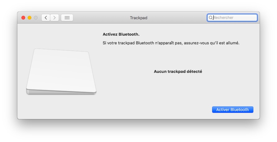

I installed BigSur in my macbook7,1 using OCLP. All is working great expect the trackpad.
In deed, I cannot configure pressure because I don't have access to the usual panel of configuration.
I only have this one attached (searching for an external BT trackpad).
Does someone have an idea please ?

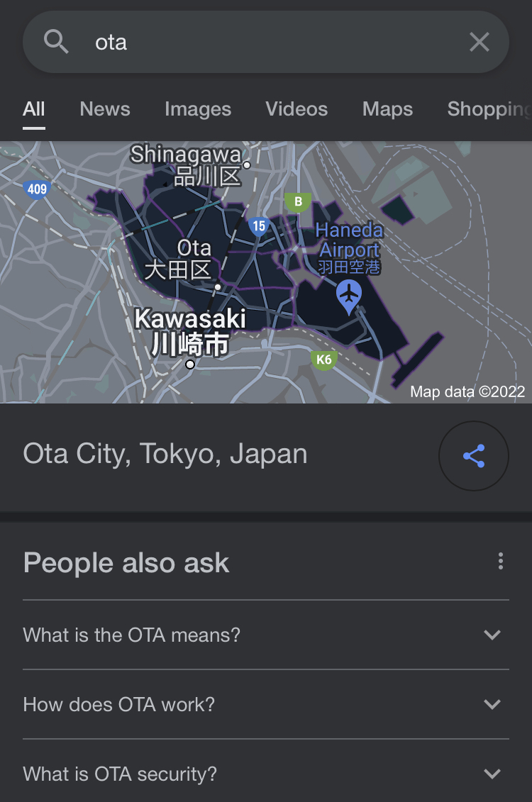

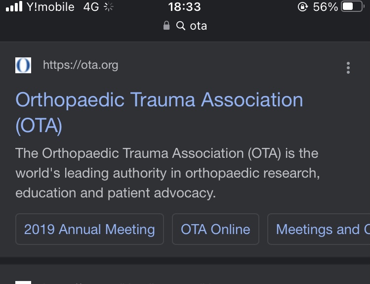

If I google OTA, top hit for me is “OTA-ku “ in Tokyo and the “orthopedic trauma association”
—so much for “reading”🤣🤣🤣

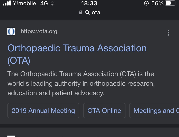

You can’t blame everyone for thinking “what the hell are these MacRumors people talking about?” when the top hit for OTA on google is the Orthopedic Trauma Association.
Just make sure the next time you update via OTA to stop by your local orthopedic trauma association. They do macOS updates like no one can.😂😂😂😂😂😂😂😂

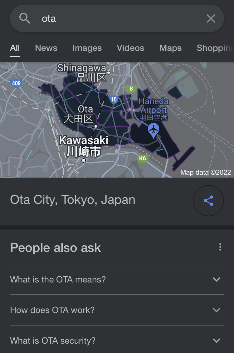

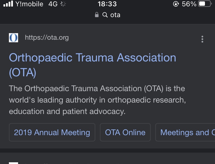

View attachment 1949977View attachment 1949994
You can do better than this! Try apple OTA update again. You can be lucky not to use logical operators, the usual search machines do this automatically.
BTW: If I start typing apple ota auto completion suggests to add update….

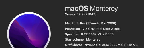

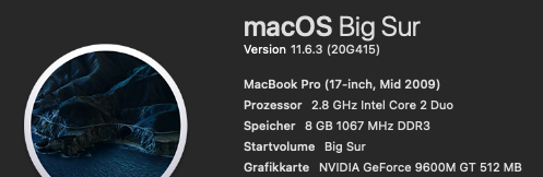

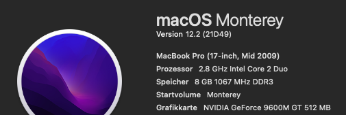

MBP5,2 17".
Installed 11.6.3 over 11.6.2 from InstallAssistant.pkg.
Using OCLP 0.4.1 for booting the installer, installation, post-install volume patch.
This is on one partition of the internal SATA SSD.
Likewise, installed 12.2 over 12.1 on the other partition of that disk.
So I now have two very useful macOSs on this mid 2009 machine. Looks like a plateau of good stability of Big Sur, Monterey and OCLP is reached.
Great thanks to all OCLP contributors.
