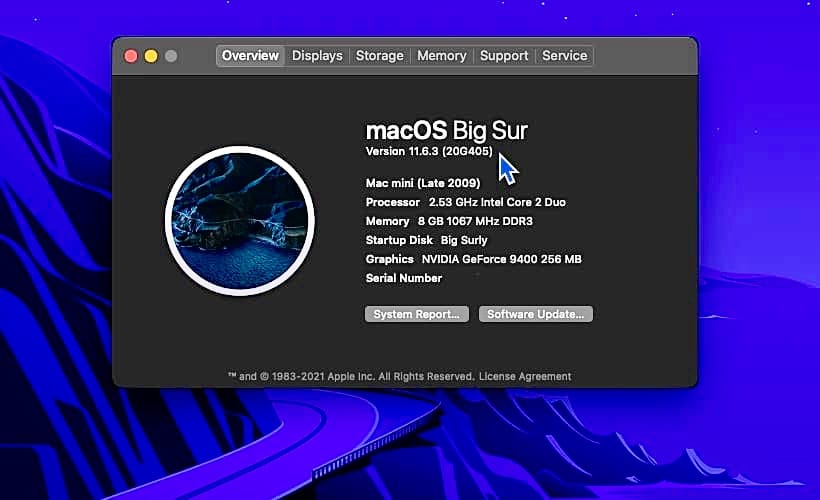

MBP5,2: same procedure used, 11.6.3 running well (apparently not a beta, but no full installer available so far).
PS - the Post Install Volume Patch done with OCLP 0.3.4n from source of today, just as a test, which worked well.
Just checked the Paradise on Discord - Updates states 11.6.3 on 20 dec is a Public Beta Build 20G405. Also, noticed features disabled in Acorn, Seashore, GIMP also Photoshop with this Beta. :rolleyes:

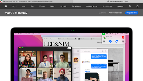

Gonna bite the bullet and try Big Sur on the mac mini on a spinning drive.
there was a video online that seemed easy, just the patcher was confusing, but i can figure that out.
who knows, maybe this will run auto like on my spare MacBook air in September?
UPDATE
i cannot find a copy of big sur to download, so I'm gonna try the Montereys
hopefully i can get these fine people depicted below to be my friends!
