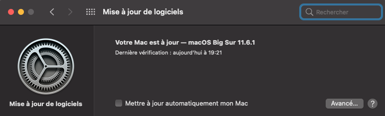

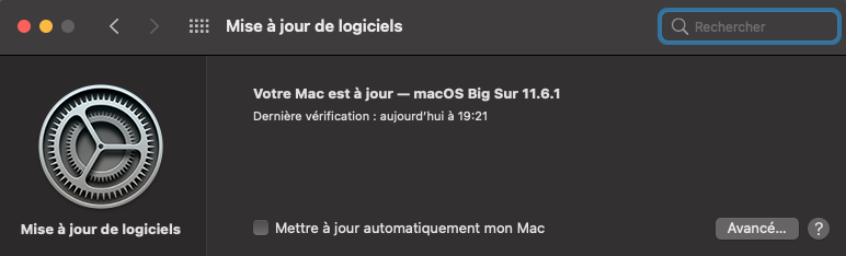

Unfortunately, since I updated OCLP 0.3.1 to 0.3.2, I can't find the 11.6.2 update. It worked in the previous version, so I should have stayed in this version :/
MBP8,1/11.6.2/0.3.2 works very well. - Did I miss something? Yesterday Maps was still useless, now the app shows accurate graphics (map and satellite)! 👍🤝

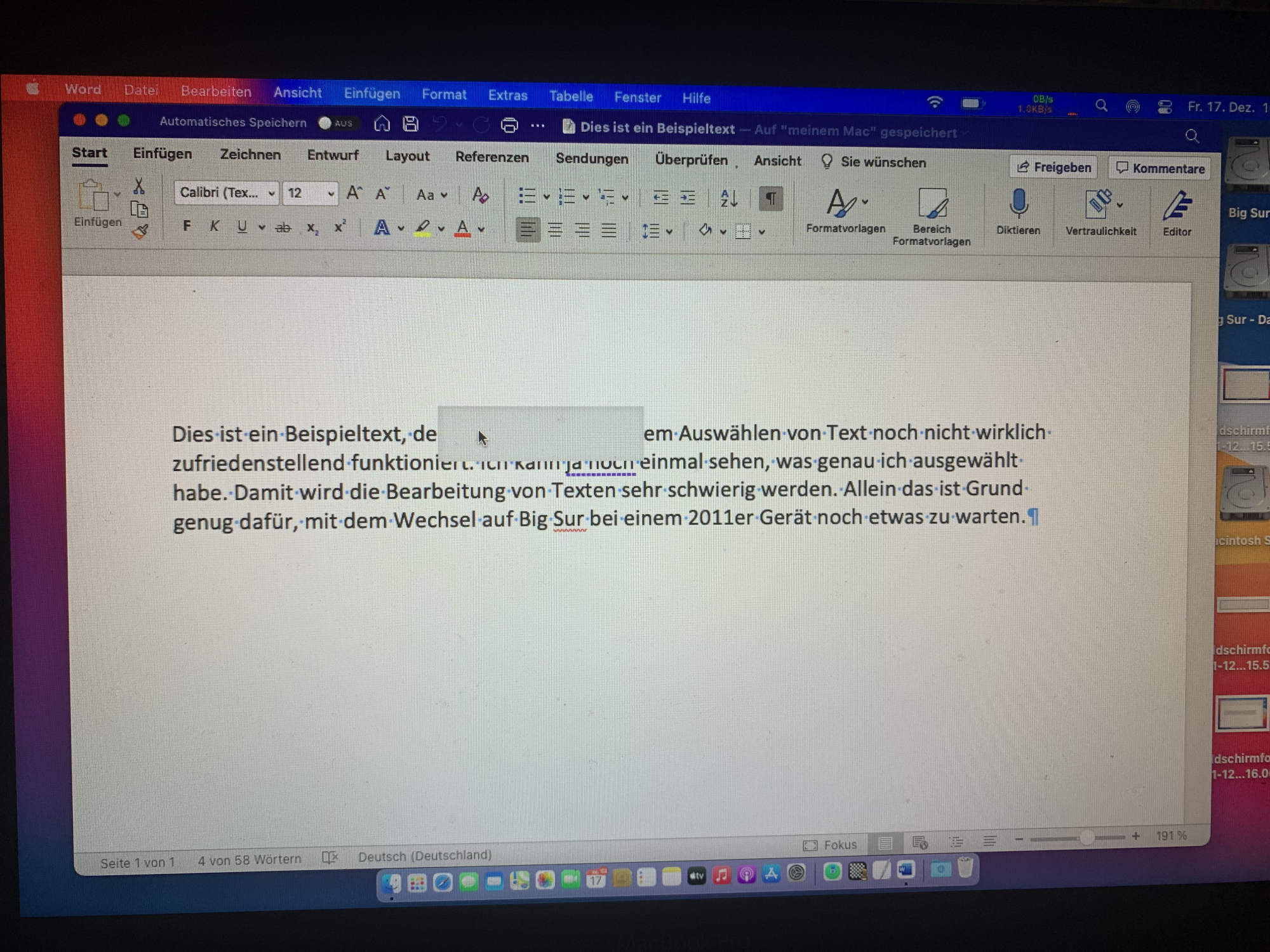

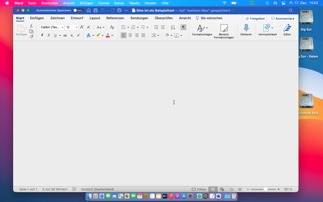

In case I overlooked something in this thread or on the OCLP page, just ignore this post. I tried to use Word on my 8,1 for the first time. Selecting text produced grey areas. I'll attach what I saw and what a screenshot captured at the same time.
Is exactly this application version running flawlessly on the last supported macOS version on the same hardware?
If you have installed a new app version supported with macOS Big Sur you might just found proof of the needing a metal GPU. The only way out if this mess is either sticking with old supported macOS versions and old application versions or buy a new Mac.
Yes, is is. Moreover: With Catalina Patcher it's just perfect.
I know. But because OCLP's getting better and better, I was tempted to assume, I could more or less work normally with Big Sur on my 8,1. If Catalina's EOS will part us, I'll weep for a moment and then be happy to have a reason for a new machine...
This post was more about letting you know, because I'd read most about Finder glitches and problems with Apple's app which require metal.
What version of word are you using? Did you try the BlurBeta fix? Perhaps it is a non-metal graphics glitch?

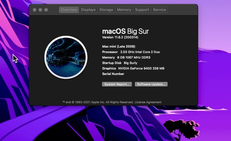

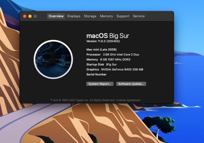

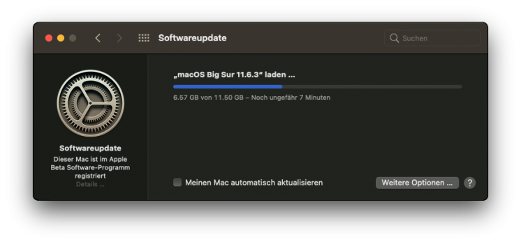

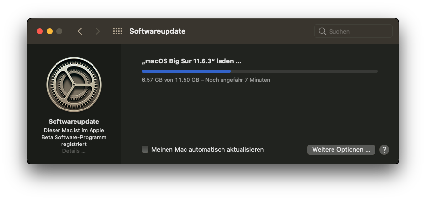

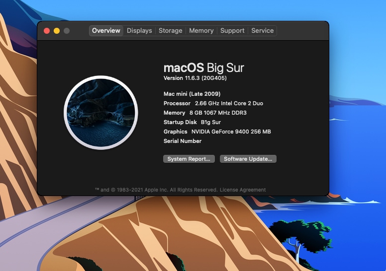

'09 Mini3,1 up to macOS 11.6.3b1 atop 11.6.2 OTA, fast and carefree via OCLP-033RTUI. So far, so good. :cool:
MBP5,2: same procedure used, 11.6.3 running well (apparently not a beta, but no full installer available so far).

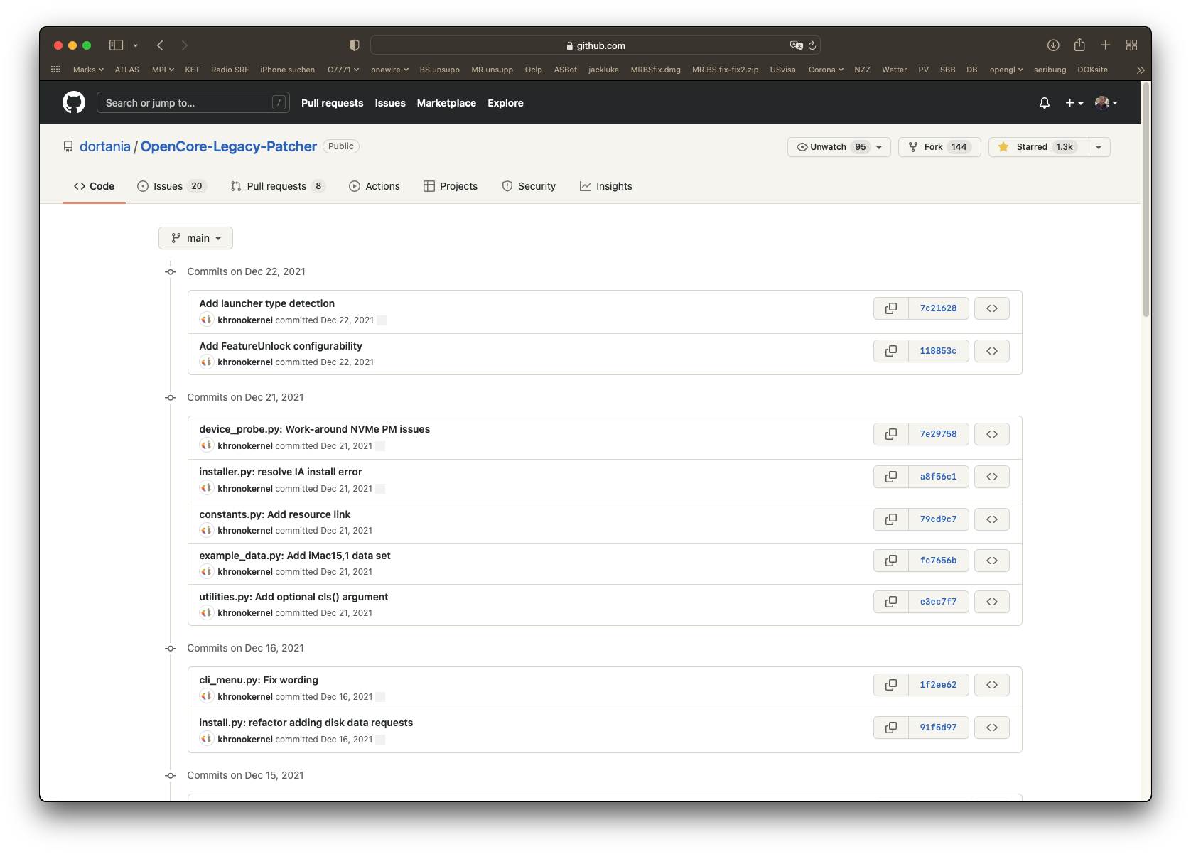

PS - the Post Install Volume Patch done with OCLP 0.3.4n from source of today, just as a test, which worked well.
