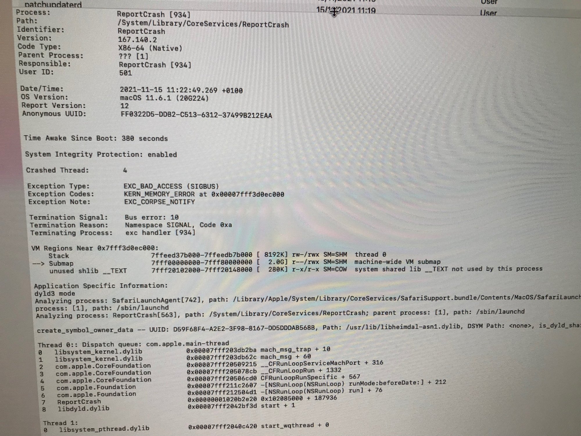

I have recently installed macOS Big Sur 11.6 (from Catalina) on my MacMini 2012 6,2 using OpenCore Legacy Patcher and everything went well during the installation, but now i cannot use my mac.
After login to my account, i can use applications during about 1 minute, then everything crash and i can no more launch apps.
In OpenCore settings for installation, SIP is set as disabled, but when i check SIP status after installation, it's in Unknow status, even if i change it to disabled (after reboot)
In Console, i see a lot of messages like this when apps crash :

Hello,

You cannot change the SIP status with OpenCore other than editing the config.plist or rebuilding and rewriting OpenCore through OCLP. Check the docs and even GibHub issues about this ongoing discussion. SIP is controlled by OpenCore only as long as you boot and use it.
There is a known problem with fast crashing apps mostly coming with the famous "Hash mismatch" error message.

What i don't understand is that SIP is disabled in OpenCore settings when i install it
Again, read the docs. It is clearly stated your system would need root volume patching and SIP disabled with Monterey. Since the software cannot feel, smell or hear what macOS you are planning to install it goes the way of the least resistance.
Since you and only you can know what is to be installed next you and only you can choose SIP enabled when running OCLP.
This is a complex topic, but you are entering the world of unsupported macs. There is only one person left who will support your system now - this is you! Get prepared for this job!

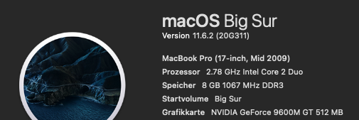

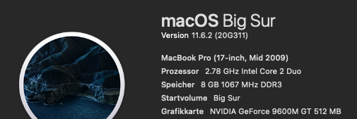

Updated 11.6.2 to 11.6.2 again. It is now the next release candidate (20G311).
Installed it OTA using OCLP 0.3.1. Root patch done with 0.3.2 nightly from 28 Nov (BlurBeta and Safari fixes included).
Running fine.

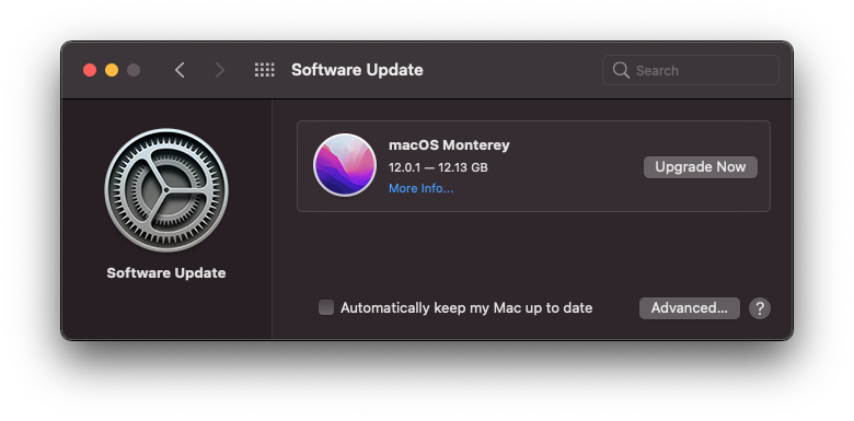

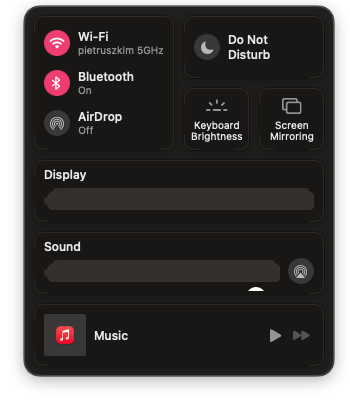

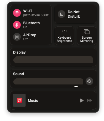

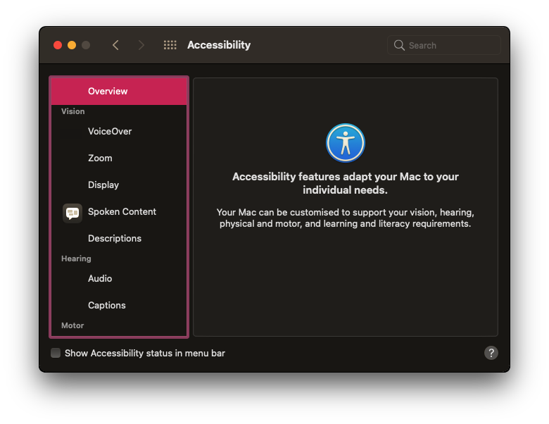

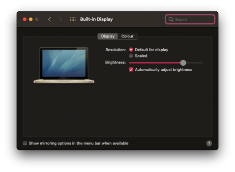

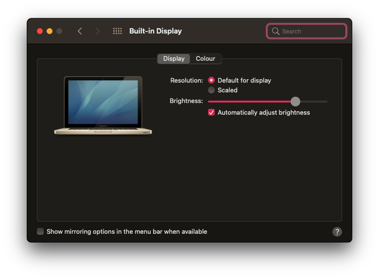

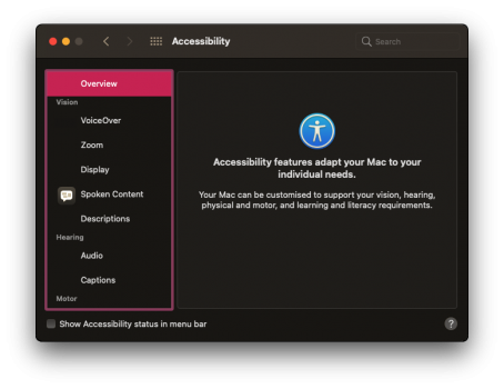

Hi, so I did it. Using OCLP 025 I installed BS 11.6.1 on my MacBook Pro 2009, after installing PostInstallPatches everything moved smooth, but I found 4 issues: 1. Display and sound strips looks ugly in Control Center. 2. No icons in e.g. Accessibility contol panel 3. No NightShift tab in Display Control Panel 4. No visible possibility of update to 11.6.2 in Update control Panel. Do you have the same issues in your MacBook Pro? Firts I installed PostInstallPatches from OCLP 025, having above mentioned issues I installed Patches from 032 night build but nothing changed... BR.
I have the same three issues 1,2,3 as you mentioned. Used the latest OCLP 0.3.2 nightly for post install patches. - There is not identical, but similar behaviour in Monterey (but night shift is there); in both cases using the same non-metal acceleration code, i.e. the latest SkyLight framework.

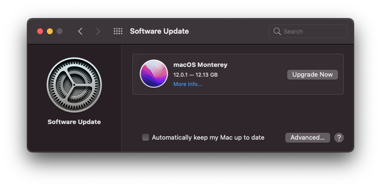

I did see the 11.6.2 in the update control panel when booting with OCLP 0.3.1, but not with 0.3.2 nightlies, and used it to update 11.6.1 to 11.6.2 meanwhile (didn't try 0.2.5). There might also have been a transition effect between multiple release candidates of 11.6.2, all called 11.6.2 but with different version codes (20G311 being the latest). There should be a release of 11.6.2 before long I guess, hopefully coming with a full InstallAssistant.pkg.
Affirmative for issues 1, 2 and 3 (MacBookPro5,2 17" Mid 2009, 3.06 GHz Penryn T9900). Interestingly, the very same "Spoken Content" icon is correctly displayed in the Accessibility Features on my machine while all others are not.
Hi, thank you for your quick reply. now I know that I am not alone with these issues :) So I am wating for 11.6.2 a full InstallAssistant.pkg. Have a nice weekend. BTW BS 11.6.1 does really his job in MacBook Pro Mid 2009. Thanks once again for an inspiration to do that.
