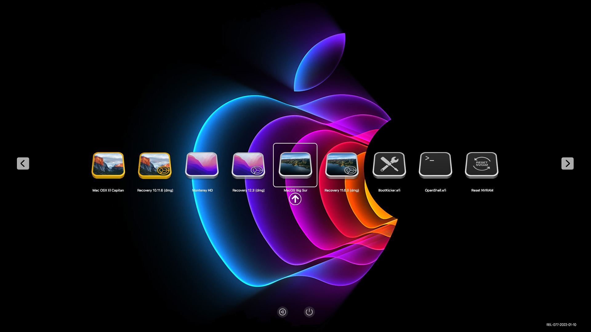

11.6.5 by OTA Update from 11.6.4 (OCLP 0.4.2 spoofless) on Mac Pro 5.1
(just a machine in progress, most untouched, stock wifi, stock bluetooth)

I updated my MP 5,1 to 11.6.5 as well OTA. For some weird reason I didn't see the 'Macintosh HD' psuedo dissolving update volume on reboot, and I had to do a PRAM reset in order to get the update thermometer to progress; two cold boots seemed to kick some sense into the updater and eventually I booted to 11.6.5 successfully.
Don't know why it was glitchy this time around, the update to 11.6.4 didn't give me any trouble.
Also running OCLP 0.4.2 but with minimal spoofing; 11.6.5 also seemed to fix some issues I was having with WiFi Sharing.

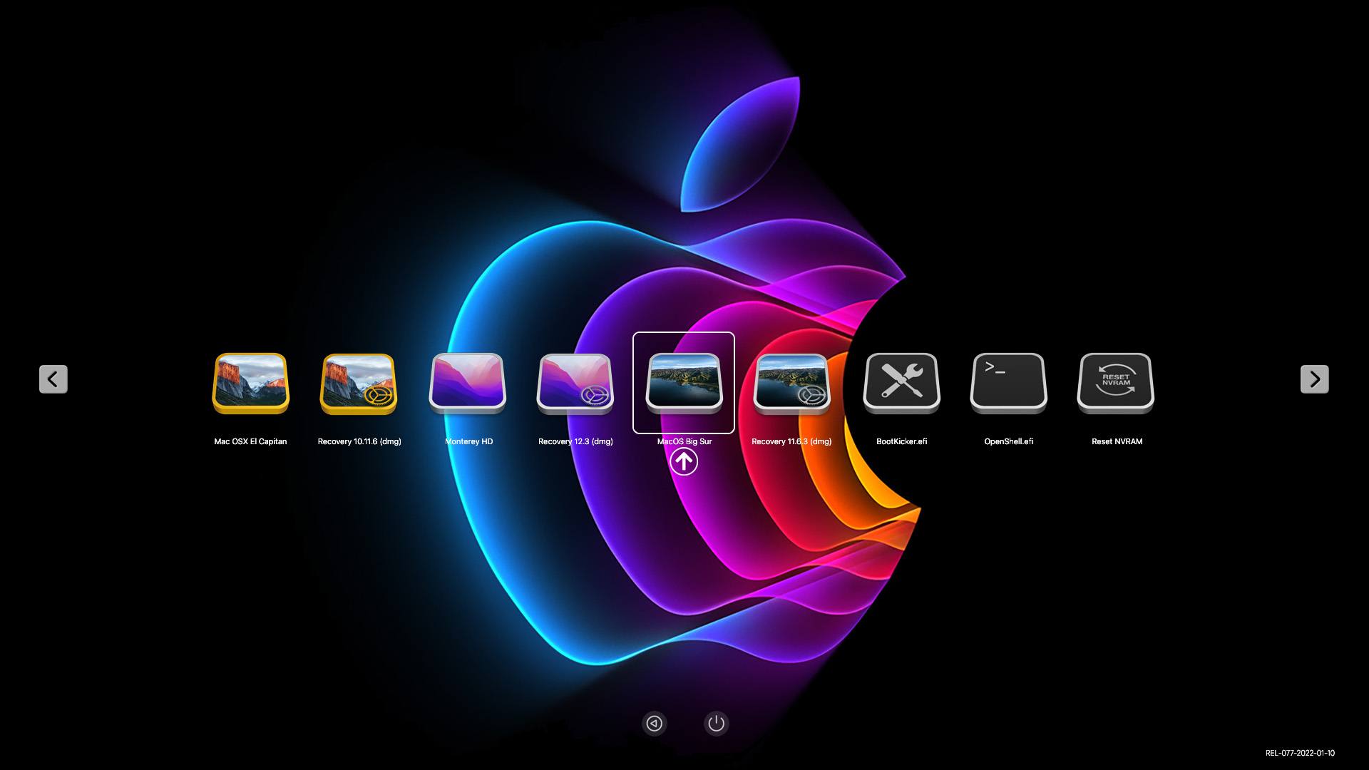

MBP5,2 17“ mid 2009: Updated OTA from 11.6.4 to 11.6.5, and from 12.2.1 to 12.3 on two partitions of the internal SSD. Using OCLP 0.4.3 release in both cases. Went smooth and automatic (and showing the Macintosh HD in the OCLP boot picker on 1st reboot).
I had exercised the release candidates for a while on external SSDs before.
The books.app of 12.3 does not run well without Metal. Replaced it with the BS version 3.2.
I can go back and forth between BS and MR relatively easily by using a set of scripts with rsyncs to keep important user data in sync. BS is perfectly stable und MR is getting better and better.
It is great to have OCLP. Many thanks!

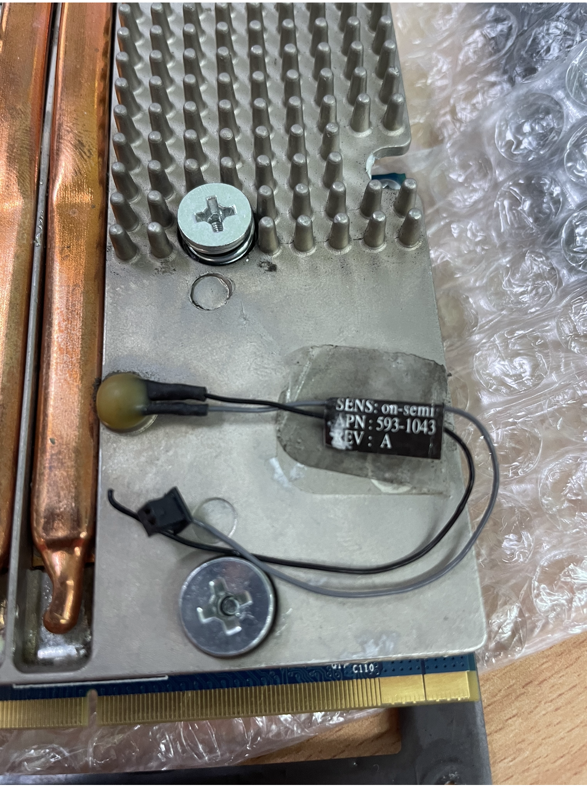

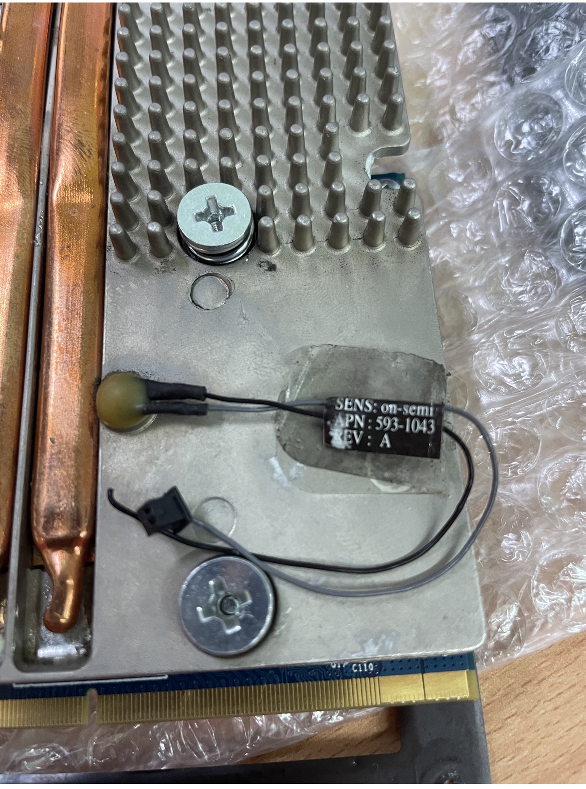

Hi, I have installed big sur with the latest version of OC but the performance of my imac 27 mid 2010 i7 is low
I noticed that the GPU sensor cable has broken
Could this be it?
