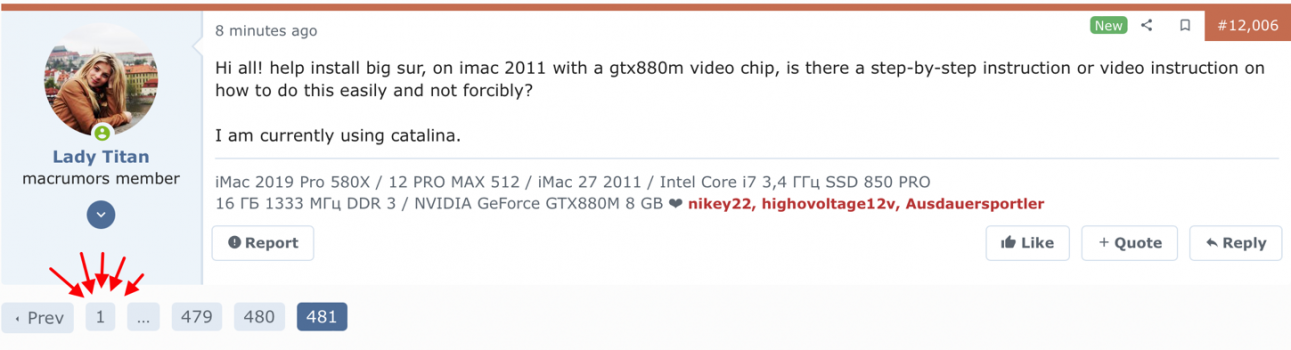

Hi all! help install big sur, on imac 2011 with a gtx880m video chip, is there a step-by-step instruction or video instruction on how to do this easily and not forcibly?
I am currently using catalina.
this link helped me from page 479 on this thread
then i chickened out or could not find BigSur to download.
there is a great video on that youtube thing that explained in detail how to install monterry
i might do that then install Mojave along with that
on our Mojave thread, someone advised using this link as well.
i know the way to install Mojave an catalina was much easier and used terms we understand.
good luck and let us know how this proceeded.
Really: Read the first post thoroughly. That will get you to the OpenCore Legacy Patcher site. There's a step by step introduction. The software is great, but you need to understand the concept, that differs very much from Catalina Patcher.

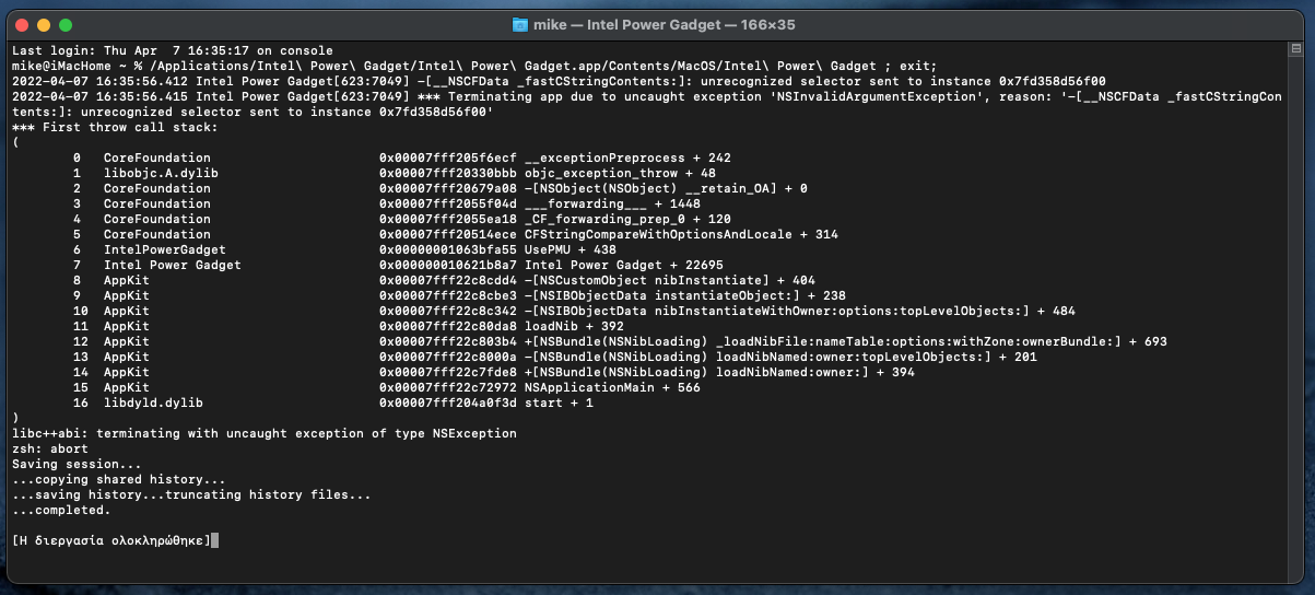

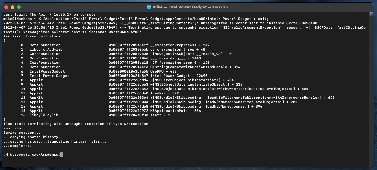

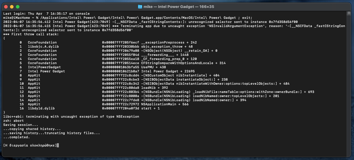

In an iMac 2011 I updated the Cpu to i7-2600s and the Gpu to Nvidia K2100m.
Then used OCLP to update the system to Big Sur.
I install intel power gadget, it installs fine but when I open it, the terminal opens instead, showing an error.
Does this have anything to do that I updated the cpu to i7 2600s?
Or that I updated the gpu to k2100m?
Or is there any setting in opencore that I should change...?
Any ideas on this? Is intel power gadget working in your unsupported macs updated to big sur?
Intel Power Gadget works on my unsupported MBP10,2 running Big Sur. It should just work. (It should definitely cope with an upgraded processor.) Maybe post the error here?

Thank you for your reply.
Here you go:
Here you go:
Hmm. It's news to me. This is from starting the app normally (double-click in Applications folder), right?
I definitely believe the app should work fine on your machine. As I'm sure you've already tried too, Google doesn't seem to throw up much. Apart from the obvious (remove app, clean reinstall) I don't have much more to offer, sorry. :-(
It was working fine in high sierra i.e. before I upgraded to Big Sur using OCLP. This is why I suspect that there must be a setting in opencore that is causing this.
Reactions: TimothyR734
I think your machine can run Big Sur without OpenCore. If I'm reading this post by @Ausdauersportler correctly, it would be without sound or ethernet, but still running.
To boot without OC you need to boot into Recovery, run sudo nvram boot-args="-no_compat_check" from the Terminal, then reboot your Mac, hold down ALT during boot to get the native Apple bootpicker, and select macOS directly. This will boot into macOS without OC, to let you check the theory. (I'm still pretty sure the theory is wrong, OC doesn't change anything relevant to this.)
To get back to booting via OpenCore, probably your machine will do so automatically when you reboot again, but if it does not, simply reboot your Mac again, hold down ALT to get the native Apple bootpicker, and then select OpenCore while CTRL is held down to make it the persistent default boot option.
