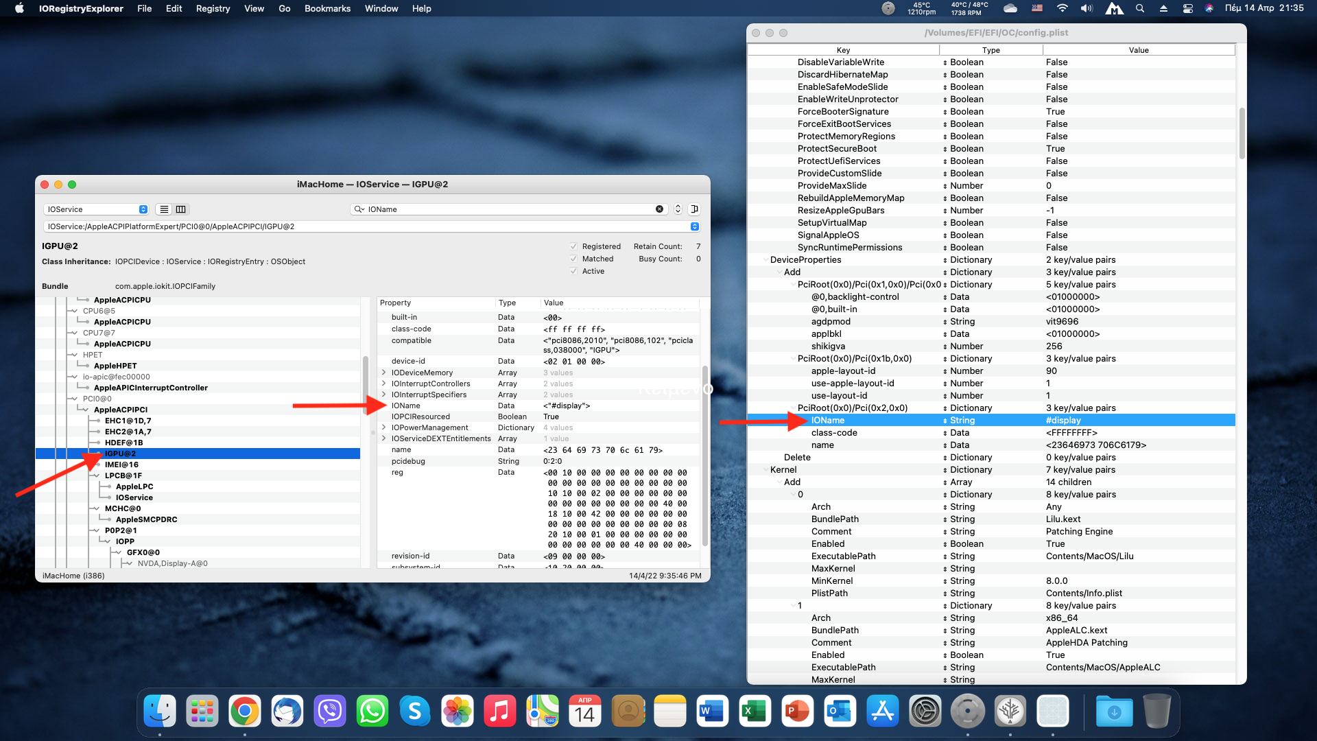

Hmm. Starting to wonder whether this is a misconfiguration in your OpenCore, after all. Maybe this? (You might be able to search your config.plist file for the incorrect setting, rather than searching the entire IO Registry.)

You may be on to something...
I checked my config.plist and the IoregistryExplorer. See the screenshot. Whilst the config.plist states the IOName value as "string", the IoregistryExplorer states the value as "data". i.e. exactly what the post you linked states as problem.
However, I have three questions.
1. How do I fix this? The post says "Find what sets that wrong type and change it to the correct type, or disable that patch". Could it be that "display" has the "#" sign in front of it? Should I delete it altogether? How do I find what sets that wrong type?
2. Is it like this on purpose by OCLP and so if I make any changes to that value I may face a problem booting etc?
3. What happens if I mess with my EFI? How can I make corrections to it? Will I be able to boot without the EFI folder so as to mount the EFI partition and fix it?
Many thanks my friend either way!

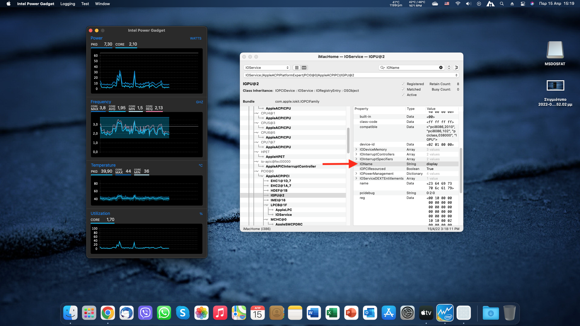

Please leave this untouched, it just disables the iGPU of your SandyBridge CPU which would not work anyway with Big Sur and later.
But enabling it would crash the system on wake (it breaks simply the sleep/wake ability of your iMac).
And it is most likely interfering with the Intel Power Gadget (because it does not run on my similar equipped OCLP/Monterey iMac 2011).

In an iMac 2011 I updated the Cpu to i7-2600s and the Gpu to Nvidia K2100m.
Then used OCLP to update the system to Big Sur.
I install intel power gadget, it installs fine but when I open it, the terminal opens instead, showing an error.
Does this have anything to do that I updated the cpu to i7 2600s?
Or that I updated the gpu to k2100m?
Or is there any setting in opencore that I should change...?

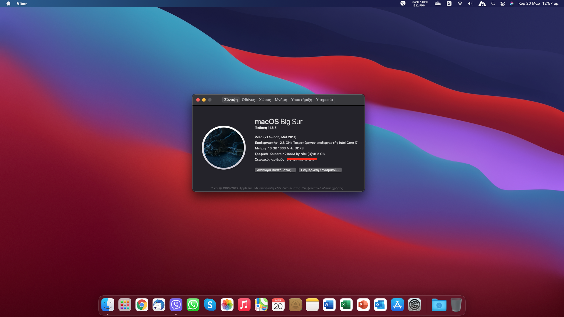

@Bmju you assumed correctly. I replaced the oem AMD HD6770m GPU to a metal supported one (Nvidia K2100M) so as to have native gpu acceleration in Macos Big Sur. I also flashed the K2100m with a new apple supported bios (Nick[D]Vb bios). See the screenshot.
If @Ausdauersportler is certain that any change to this setting will break the sleep/wake functionality, I will not mess with it.
I could experiment (I mean delete the setting, see if there is any problem and if there is, re-apply the patch in config.plist) but I wanted to make sure that I could boot back to the desktop to fix things if I mess with the config.plist.
I'm giving you instructions as to how to boot into macOS without OpenCore - why don't you try them? If you can boot into your macOS without OpenCore, then ofc you can use that to fix any problems you might make in your OpenCore config.
I do this all the time on my MBP10,2 which - I think like yours - can boot without OpenCore, as long as boot-args="-no_compat_check" has been set, by one method or another (which just tells macOS to not bother checking whethe it 'thinks' it is compatible, and to try starting anyway).
I will try this and report back.
However I would like to apply a proper solution to this problem rather than just deleting the patch (which is there for a reason).
I understand the problem is that in the config.plist the IOName is stated as "string" but when it is injected it changes to "Data". And from what I understand, I need to create a DSDT to fix this and keep it to string even after been injected.

So, I installed the OCLP EFI to an empty USB. I opened config.plist and deleted the IOName patch. Saved it and then restarted and booted off this modified USB EFI.
Intel Power Gadget installs and works fine. Also I checked the IORegistryExplorer and now the IOName entry is correctly shown as "string".
I tested sleep/wake and it is working. However, I believe that maybe Deep sleep is not working. This is because when I wake up the iMac, it wakes up very fast whilst I remember it used to delay a little... Is there a way to check if deep sleep is actually working?
