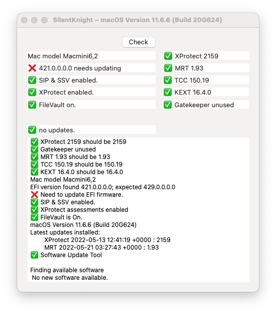

Hi again! Just getting around to finally doing this. Question on the firmware update... once I update to the latest OCLP, it should unspoof firmware. Then wouldn't the Big Sur update automatically add the latest firmware, or would I still need Catalina b/c the 2012 mini is "officially" unsupported on Big Sur?
Also, if the firmware update is gonna be a regular thing, can I just add a Catalina partition to the internal SSD?
Last, is there a way to set OCLP to update automatically? Thanks.
I have same model mini on Big Sur w/ OCLP 0.4.2 running smoothly.
a. I would update OCLP to 0.4.2 or 0.4.3(latest) and reinstall Big Sur over the top (will keep data and files).
I think this will also move from OCLP spoofing method to spoof-less method.
b. Also suspect that your firmware is not up to date.
Download SilenKnight, run that and tell us what is firmware version.
If outdated firmware, you should look into creating a small partition (internal or external disk of 50GB) to install official supported macOS Catalina and run through all software updates which will in turn update mini to latest firmware.
Update: Attached is my latest SilentKnight screenshot. Looks like I was on firmware 421 all along. So could the issues just be from OCLP 0.3.0? I updated to OCLP 0.4.4 just now.
You will need to boot to Catalina and perform a software update to get the latest firmware 427.
Bingo. Big Sur updates would not be touching/updating 2012 mini firmware.
Yes, you can if you want to (create a separate partition).
No, as far as I know. You need to update the OCLP app, build and install that version to the specific boot EFI.
Latest firmware is 429.xxxx

Thanks for the reply. I updated OCLP to 0.4.4 and updated firmware to 429.xxxx via a new internal Catalina volume (surprisingly easy for future access). It was all a lot easier than I thought it would be. I was just really anxious about doing it b/c I didn't rmr how I setup OCLP and didn't wanna mess it up.
