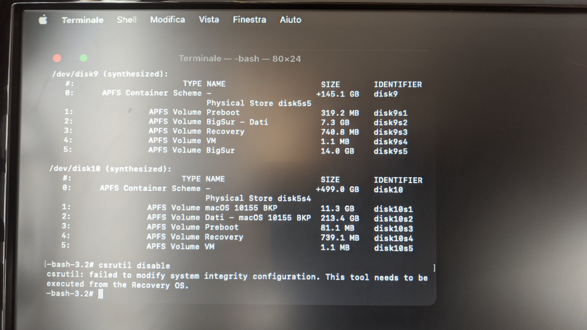

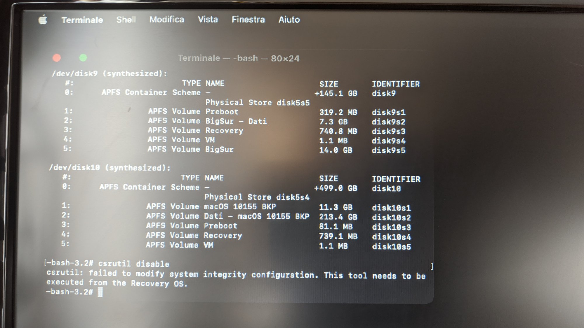

Even if csrutil status shows disabled, run csrutil disable and reboot. It’s worked for me hundreds of times.
I before said...SIP is disabled on my mac since what....forever. :cool:
And it still holds true
I had to restart for another reason, so I decided to give you the benefit of doubt, guess what, it did not work.
It worked for you for a different reason (might be a bug or any other reason), If you switch of a light bulb there won't be light emitted from the bulb, same here, if you disabled with csrutil disable it is disabled, that's a fact.
