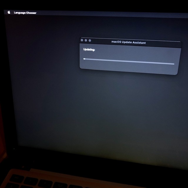

I’m using Hax3 to install BS Beta 2 on a fresh partition, but the usual loading bar changed to this Updating… screen and got stuck.
Hax3 BS Updating…Is there a Hax 2 or 4 to test? Or should I return to Hax 1?

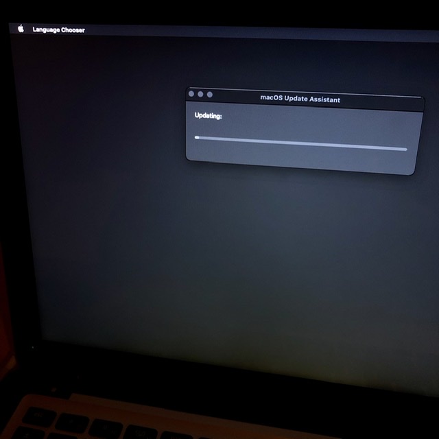

View attachment 932338Is there a Hax 2 or 4 to test? Or should I return to Hax 1?
That screen is OK. (I don't know why it appears sometimes but not other times. I had a theory, but if you're seeing it on an installation to a fresh partition then that definitively disproves my theory. By the way, I've seen it with beta 1 but haven't yet seen it with beta 2.) It may look stuck for an hour or more, but just let it sit there and give it time! That progress bar moves at geological speed and makes it look like it's going to take 12 hours or something, but I assure it won't really be that slow.

If things turn out the way I expect, then wait a couple days after beta 3 comes out in case the public beta comes soon after. (If things don't turn out as I expect, then I'll have to actually take a look at the public beta in order to have an informed opinion.)

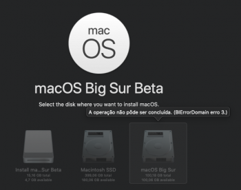

Hey @Barry K. Nathan, I did try install Beta 2 from scratch with your patcher, but when I start the installer to choice the partition, get the error "Operation cannot be completed (BIErrorDomain error 3.)"
I don't know if you try in Beta 2 from scratch, but don't works
You need to restart your Mac from the patched USB drive (restart the Mac, hold down Option/Alt, choose "Install macOS Big Sur Beta"). After it starts up, you need to go to the Utilities menu (I'm not sure what it's called in Brazilian Portuguese, sorry), open Terminal, run the command /Volumes/Image\ Volume/set-vars.sh (you can probably type /Vo<tab>/Im<tab>/se<tab>, where <tab> is the Tab key), then quit Terminal and run the Installer.
