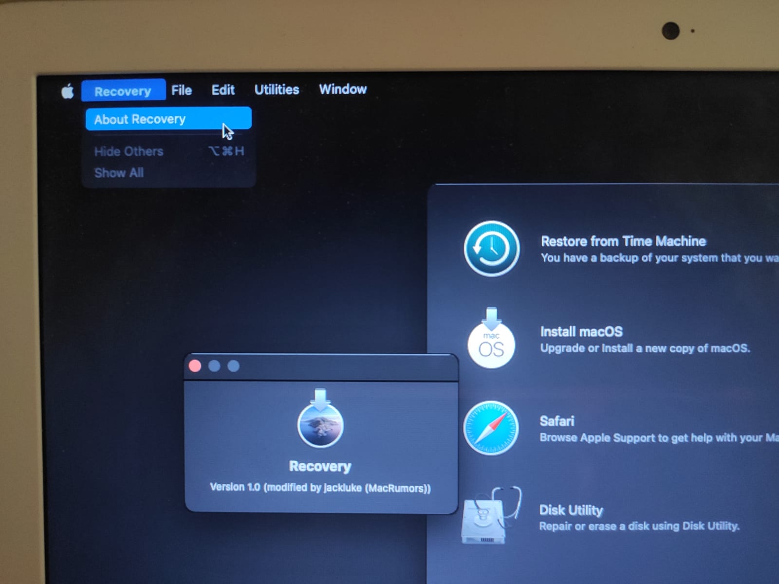

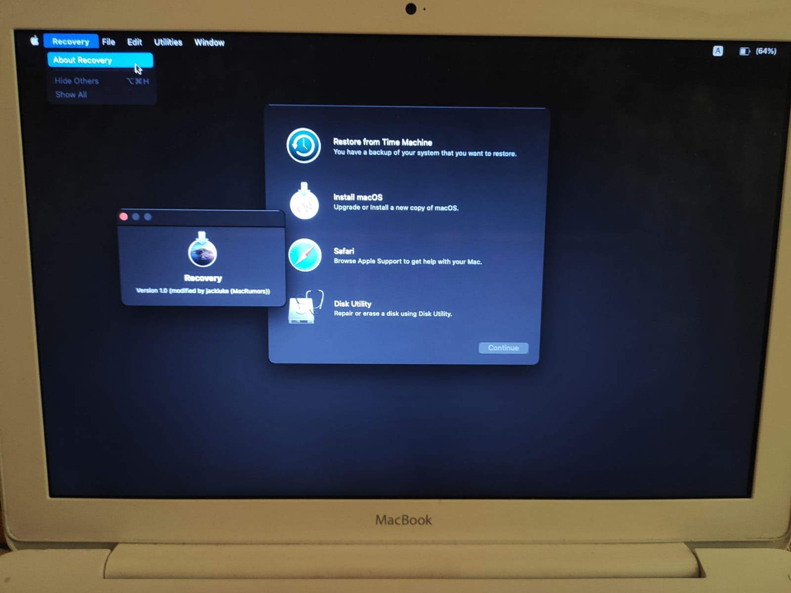

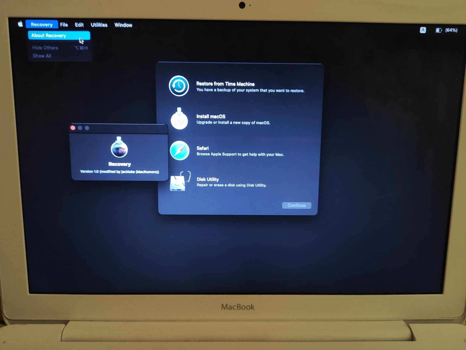

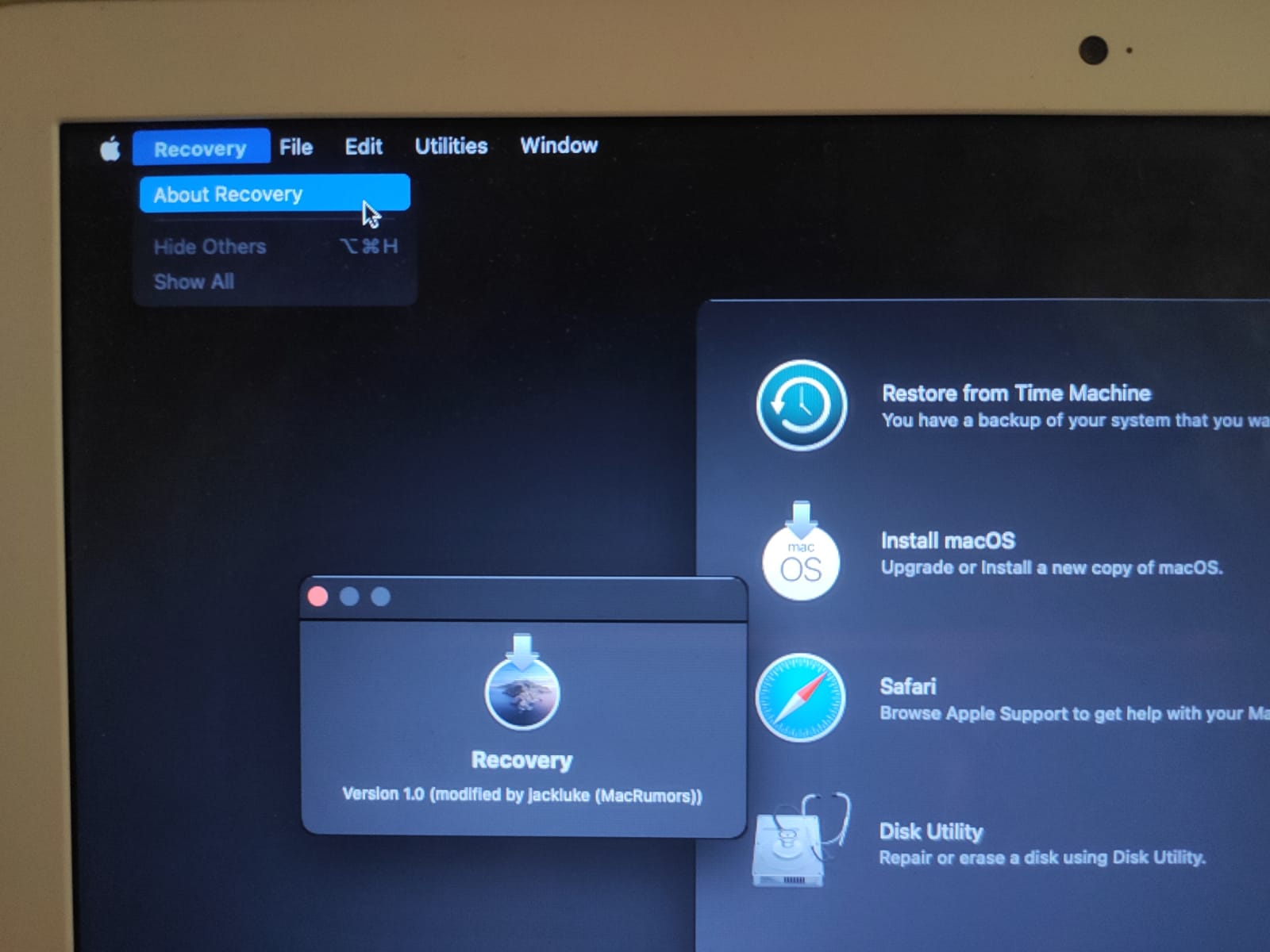

I already tested and worked for APFS HighSierra Mac with recent IOUSB (I attach two funny pictures of a patched BigSur BaseSystem.dmg), while from my attempt to use it on non-APFS Mac (legacy USB) it stuck on "IOConsoleUsers: gIOScreenLockState" verbose message or IO80211Family loaded driver.
My "prelinkedkernel fix" doesn't worked for an USB BigSur Installer (or Recovery).

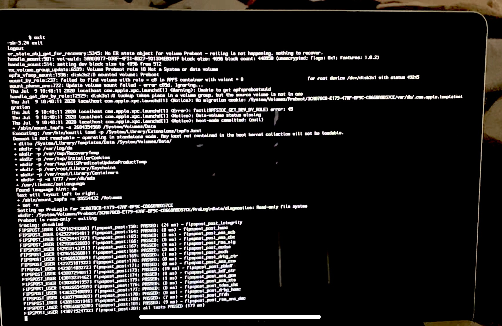

Sorry for the bad image but I don't get an error with mount_tmpfs ...

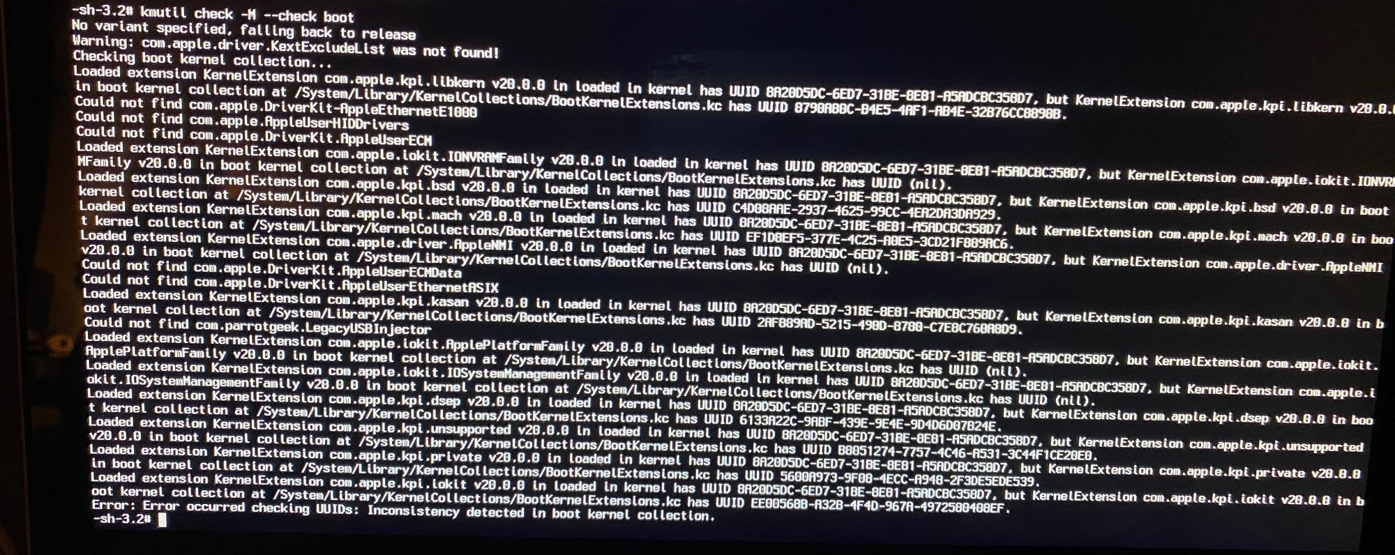

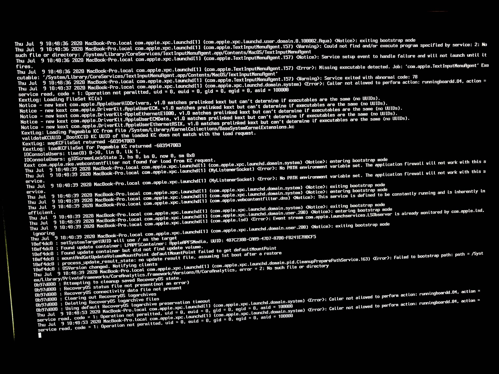

Right now I'm stuck here:
I think the problem could be the lines with "KextLog" (UUID of the loaded KC does not match with the load request)
I use the original unmodified BaseSystem.dmg by the way. I think it's all a problem of creating the proper kernel cache. Some kexts from the BaseSystem are different than their counter parts from a BS installation (UUIDs not matching)...
My idea is to fix the kexts from the BaseSystem and try those. But this should be done from someone with better bash (or whatever) skills than me otherwise it would just take too long to copy each binary to the right place.
Of course the BaseSystem SLE kext are different (I called them the forked kext) from a full installation, I meant to restore a BaseSystem.dmg to an empty Volume so in this case if should not use a ramdisk (this worked for Catalina BaseSystem.dmg).
I guess is not simple to make a generalized BootKernelExtensions.kc because of that mach-o UUID , instead a generalised "legacy prelinkedkernel" for some reason worked even with a not matching kextcache UUID.
I am not much skilled on bash, zsh and any unix shell console usage.
Okay, get the point 😉
But I think you could also mount the ramdisk as rw from Single user mode and then get somehow a similar behavior after typing exit. Because then the recovery disk is also allowed to write, as it would with a „extracted to disk“ dmg
