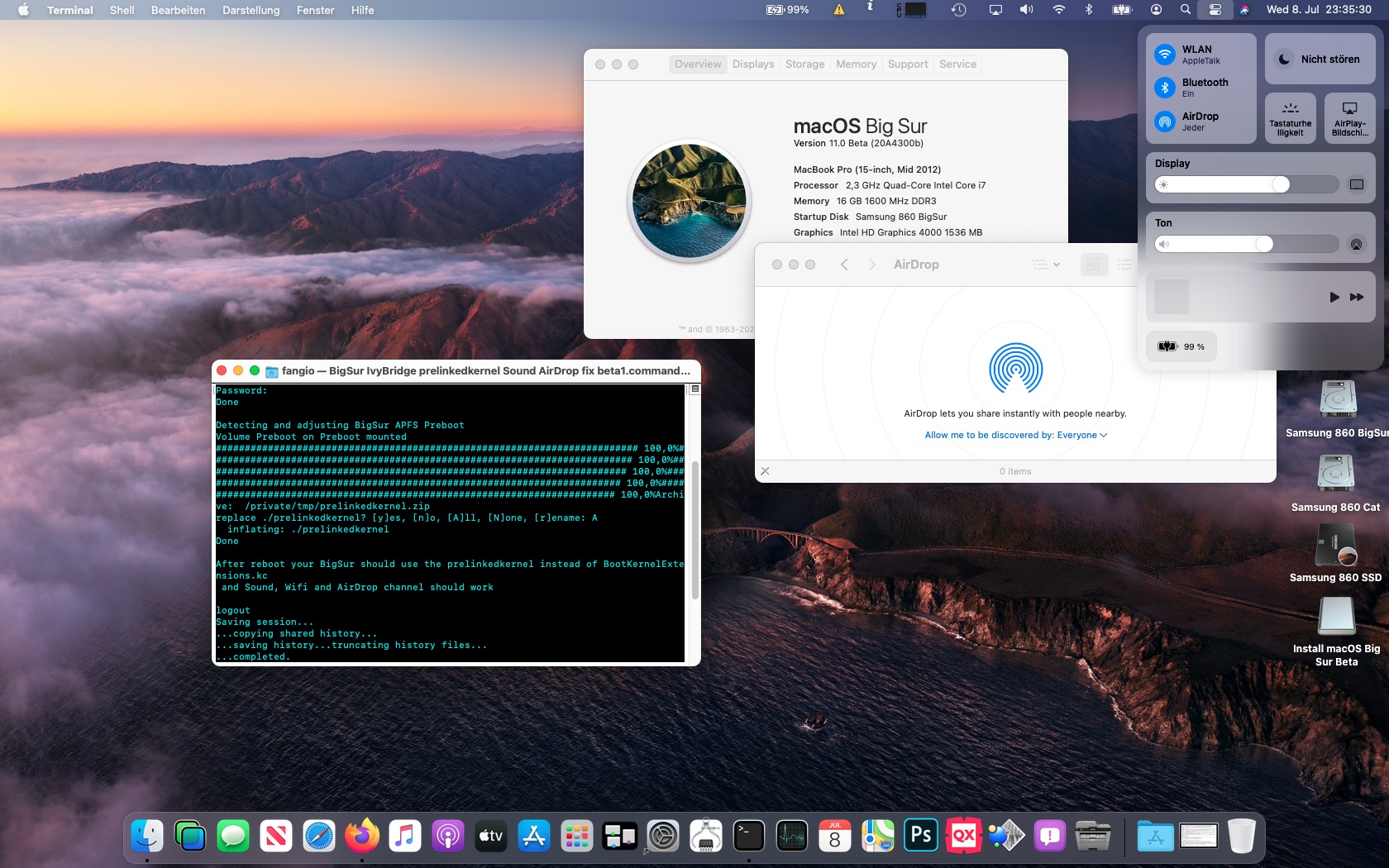

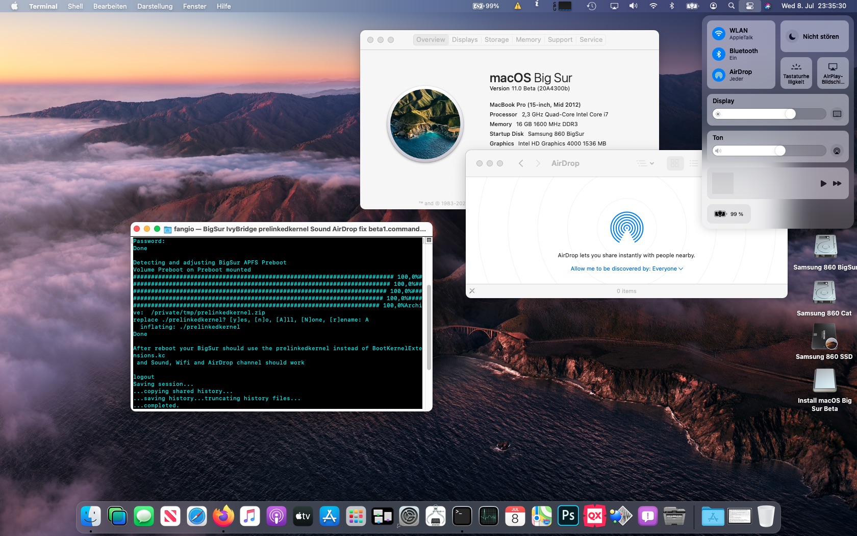

What has helped me in my MBP mid 2012 (not retina) is to follow this method:
After installing the Beta you do not have WiFI in addition to other things ..., that has been solved with the help of @jackluke and its magnificent:
"BigSur IvyBridge prelinkedkernel Sound AirDrop fix beta1.command.zip"
Everything works perfectly for me, in fact, much better than in Catalina.
