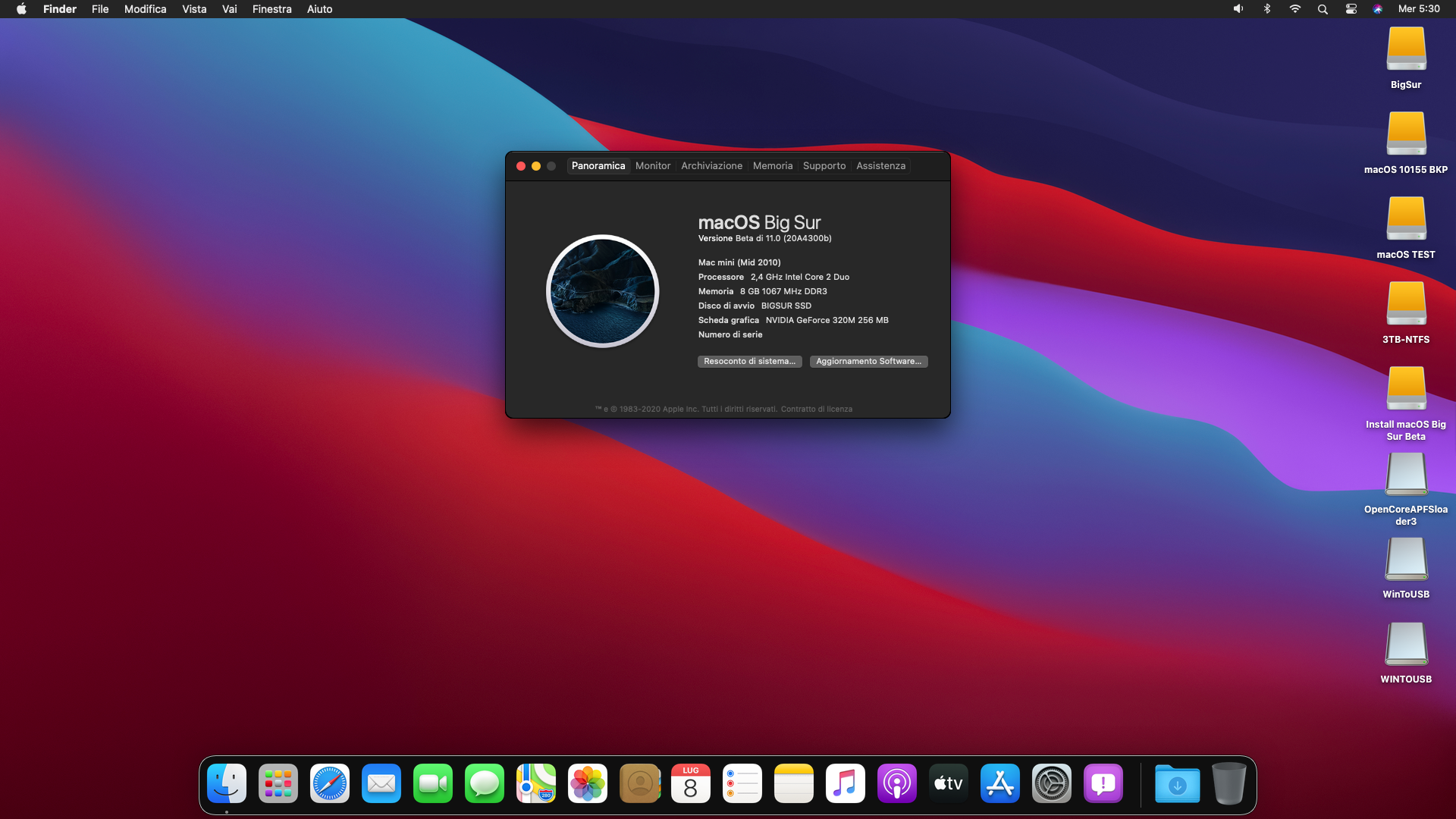

SUCCESS installing Beta 2 on Macmini 2010 (Macmini4,1) 100 GB internal SSD:
- Patched installer with @ASentientBot Hax3 from Catalina internal SSD.
- Started first install from macOS beta installer beta without @jackluke OpenCoreLoader3 due to BIE error 3.
- When installed I have used @jackluke fixes 2-3 for prekernel, USB and WIFI, loading Big Sur SSD with OpenCoreLoader3
FASTER DUE TO INTERNAL SSD (BUT VERY SLOW IN INITIAL CONFIGURATION PANELS)
OK WIFI, USB KEYBOARD AND MOUSE, BLUETOOTH AUDIO OUT, USB WEBCAM (video & mic), TOP ICONS BUG FIXED.
NO ACCELERATION
10 DAYS FOR 1ST INSTALLATION, 4 HOURS FOR INSTALLING BETA 2 thanks to @jackluke , @ASentientBot @parrotgeek1

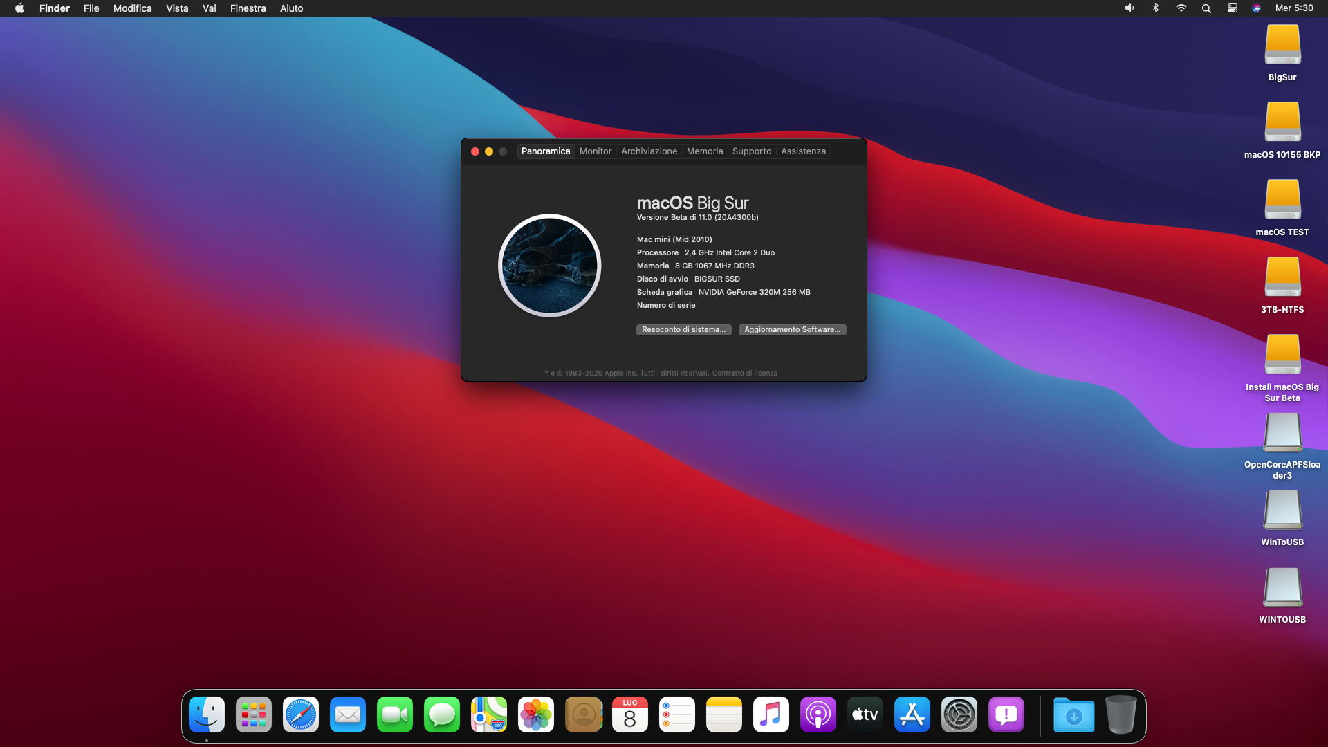

Installing Beta 2 on Macmini 2010 internal SSD:
-When installed I will use @jackluke fixes 2-3-4 for prekernel, USB and WIFI, loading Big Sur SSD with OpenCoreLoader3
From BigSur Beta 2 after installation, you need also to reduce the transparency prior booting, otherwise non-Metal Nvidia Tesla crashes after loginUI : https://forums.macrumors.com/thread...unsupported-macs-thread.2242172/post-28652497
I don't know yet if this additional step is required also for IntelHD3000 , but surely any Legacy Nvidia GeForce Tesla requires it.

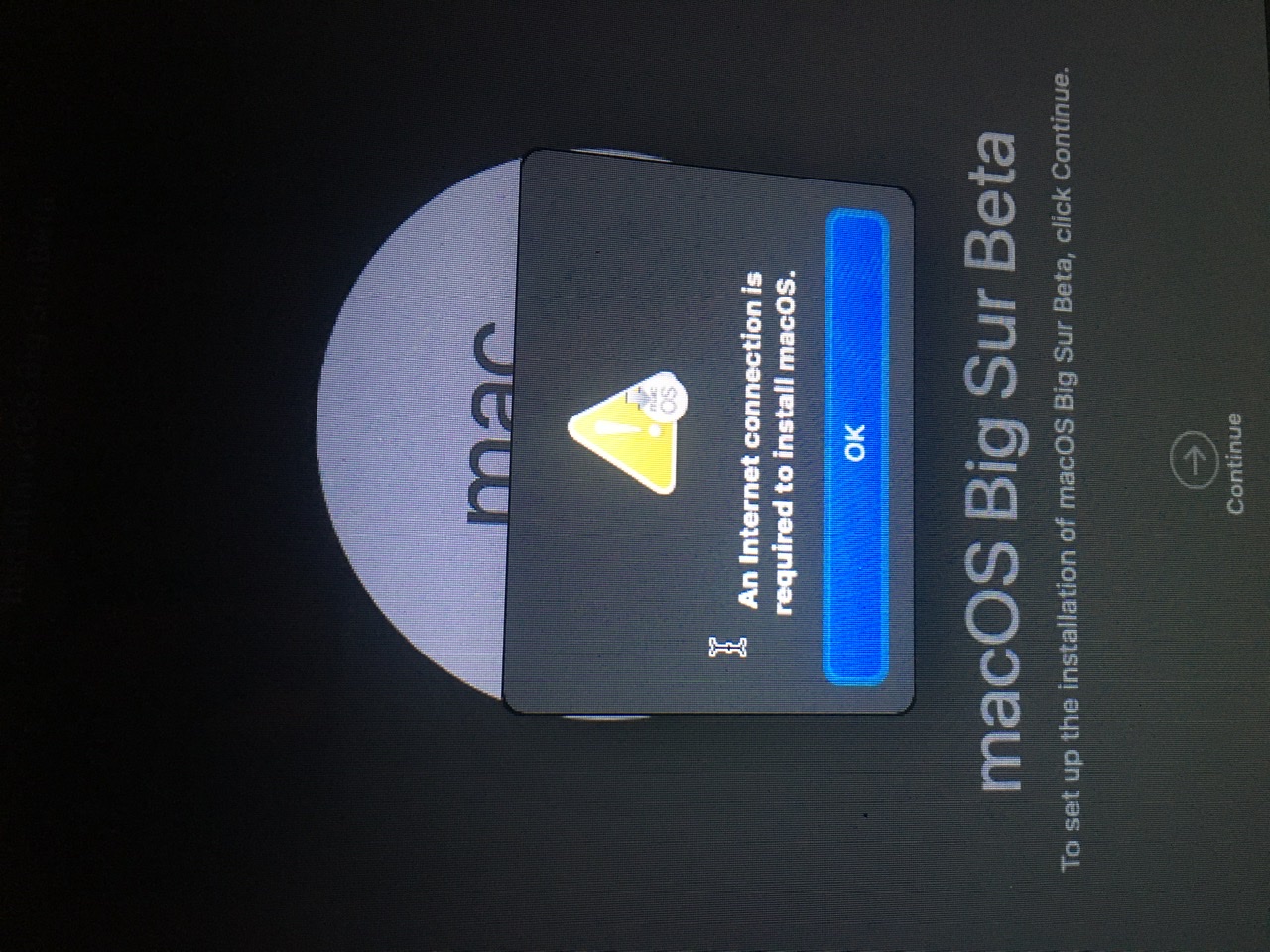

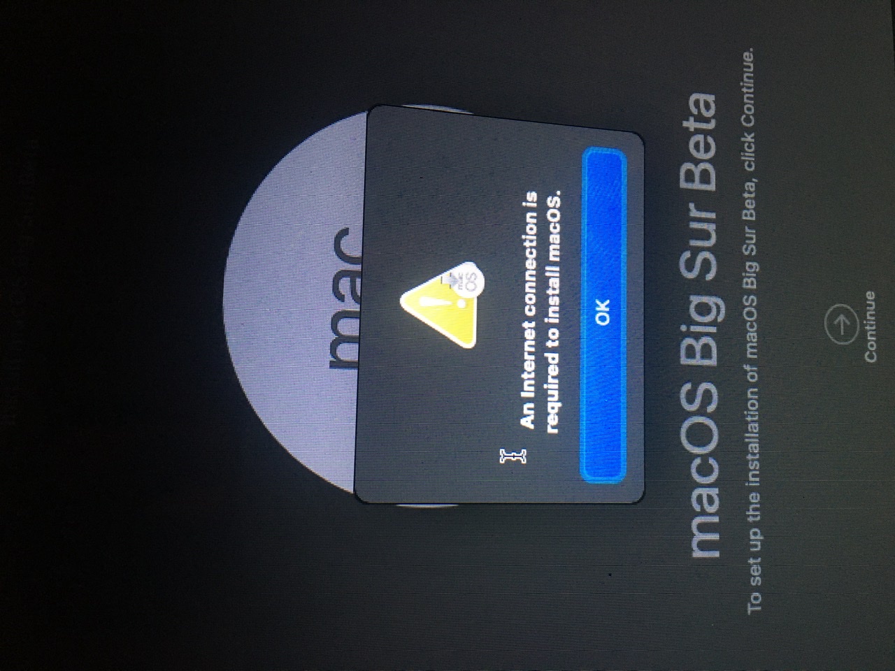

“An Internet connection is required to install macOS”. I am having this issue on 13’’ mid-2012 macbook pro. Can any body help me??

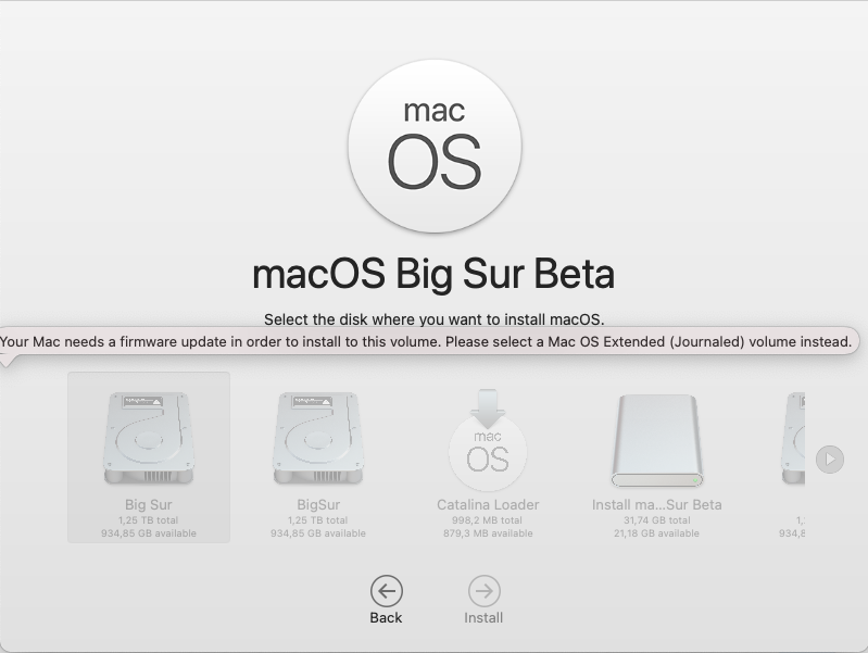

@Barry K. Nathan My friend i will install Beta 2 with your script 0.0.10
but it say : Your Mac needs a firmware update in order to install to this Volume,pls select a Mac os Extended Volume.... :( set-vars.sh doesnt help... can you help me....
Imac 2011 with OpenCore K2100m Card
the pic is from desktop... recovery say same error ;)
///my mistake i loaded the usb stick via opencore instead of the alt key...
Reactions: Barry K. Nathan
I guess with a plain text editor you should simply edit "patch_installer.sh" renaming all the instances "Install macOS Beta" to "Install macOS Big Sur Beta" , because ASentientBot Hax.dylib method worked correctly, his method also fixed the apple request to download additional packages "An Internet connection is required to install macOS."
Perfect, that has been the solution, thank you very much.
