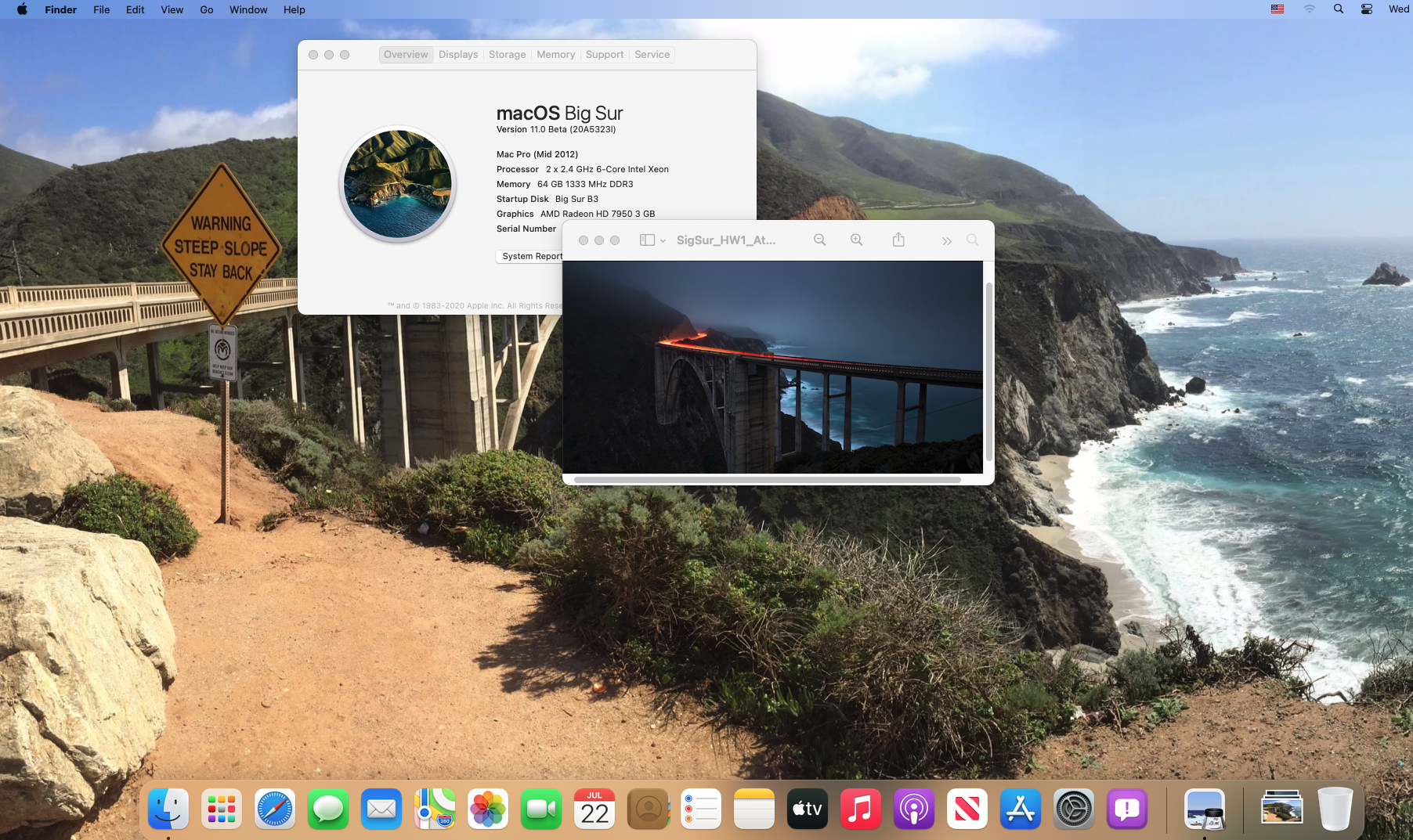

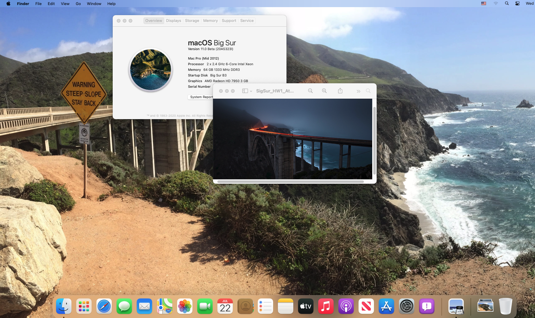

Thank you to jackluke again, beta 3 for cMP mid 2012 installed. No WIFI and I don't needed.

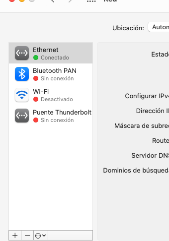

MBP 9.2 mid 2012 (not retina) - I have reinstalled beta 3. Now it does not start with Kernel Panic ... I do not have WIFI although it does appear among the network options. Any suggestion? Thank you very much for the help.

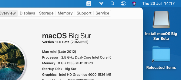

Just updated my late 2012 Mac mini to beta 3. As expected no working WiFi after installation but just like Beta 2 all I had to do was to boot into the USB installer, mount the Big Sur volume with write access, copy over High Sierra's IO80211Family.kext and run the following commands:
Code:
kmutil install --volume-root /Volumes/volume_name --update-all --force
Code:
/Volumes/volume_name/usr/sbin/kcditto
Code:
bless --folder /Volumes/volume_name/System/Library/CoreServices --bootefi --create-snapshot
Edit: Note that I'm still using @ASentientBot's hax to prevent sealing of the volume.
The kexts are being overwritten when you're updating the OS. Re-do whatever you did to get working WiFi in beta 2.😋
By doing the same as in Beta 1 and Beta 2, the computer does not start normally. A Kernel Panic appears almost in all the beginnings and when it finally manages to start it continues without WiFi or AirDrop
Hey, Did you try execute the Step 9 at the link https://github.com/barrykn/big-sur-micropatcher ???
I have not managed to fix the WiFi with this step ... Thanks anyway.
