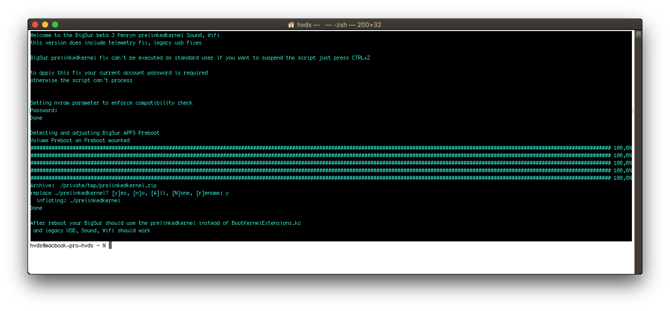

Successfully applied your new prelinkedkernel fix for beta3 for Penryn, working from 10.15.6.
- 11.0 beta3 now boots without OpenCore
- WLAN (and Ethernet as before) works.

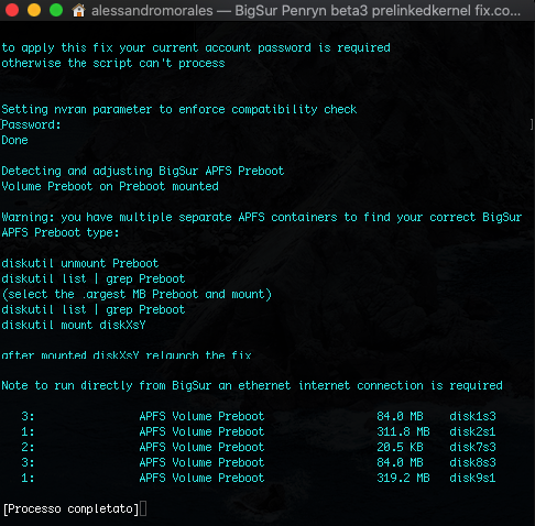

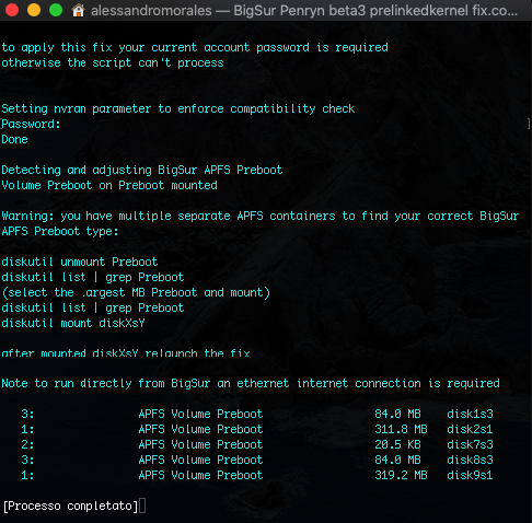

Here is attached the new BigSur beta 3 prelinkedkernel fix for any Penryn Core2Duo included the non-APFS and legacy USB Mac, also Ethernet and Wifi should work.

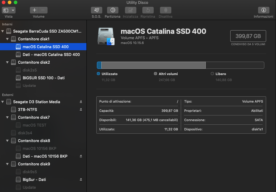

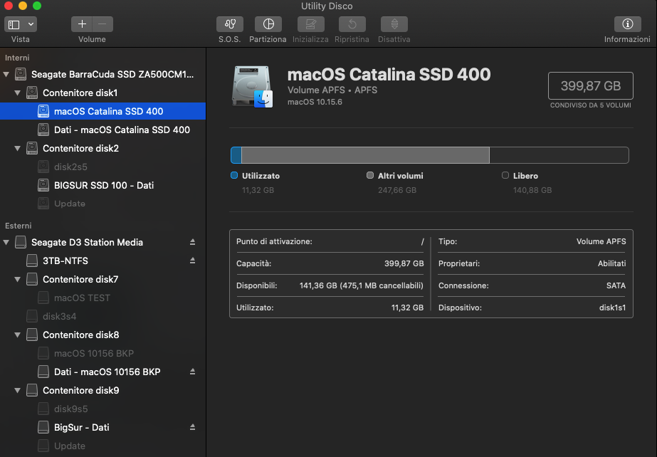

Hi @jackluke I have executed the command, but it doesn't patch my Preboot (mounted as requested) and I think that the correct one is disk2s1 (internal SSD) not the bigger Preboot. Where I'm wrong? Thank you!

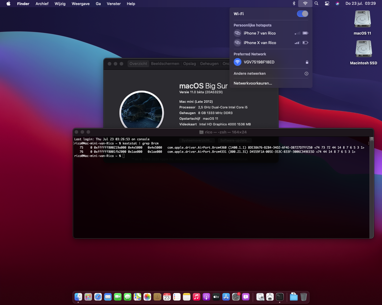

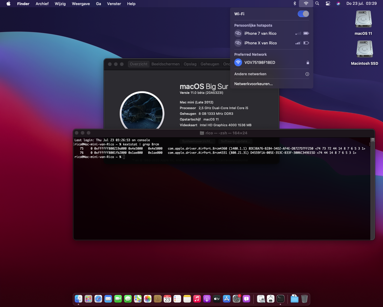

Just updated my late 2012 Mac mini to beta 3. As expected no working WiFi after installation but just like Beta 2 all I had to do was to boot into the USB installer, mount the Big Sur volume with write access, copy over High Sierra's IO80211Family.kext and run the following commands:
Code:
kmutil install --volume-root /Volumes/volume_name --update-all --force
Code:
/Volumes/volume_name/usr/sbin/kcditto
Code:
bless --folder /Volumes/volume_name/System/Library/CoreServices --bootefi --create-snapshot
Edit: Note that I'm still using @ASentientBot's hax to prevent sealing of the volume.
