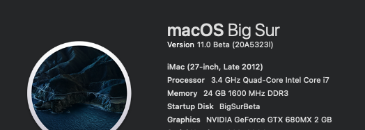

Successful Install of Big Sur Beta 3 on iMac 13,2 (late 2012 model)
I used parotgeek's instructions and his "tool2" to create a bootable USB thumb drive installer (for Big Sur Beta3).
Installation of Big Sur Beta3, over an existing Beta 2 installation, went without problems.
Jackluke's latest Ivy_Bridge prelinkedkernel allowed full WiFi functionality.
In order to access WiFi network, I had to change my router setting to make network "visible".
Thereafter, I had to logout (not reboot) from Big Sur, and then log back into Big Sur, for WiFi network to become accessible from the computer. Note, that once logged into the WiFi network, I set the network control panel functions to "remember joined network" and "ask to join new networks". I logged back into the router and set "wireless network" to invisible again; the WiFi remained functional after toggle to "invisible".
A huge "thank you" to the principals, and the many other individuals who contributed to this thread
Hope this may be of help.

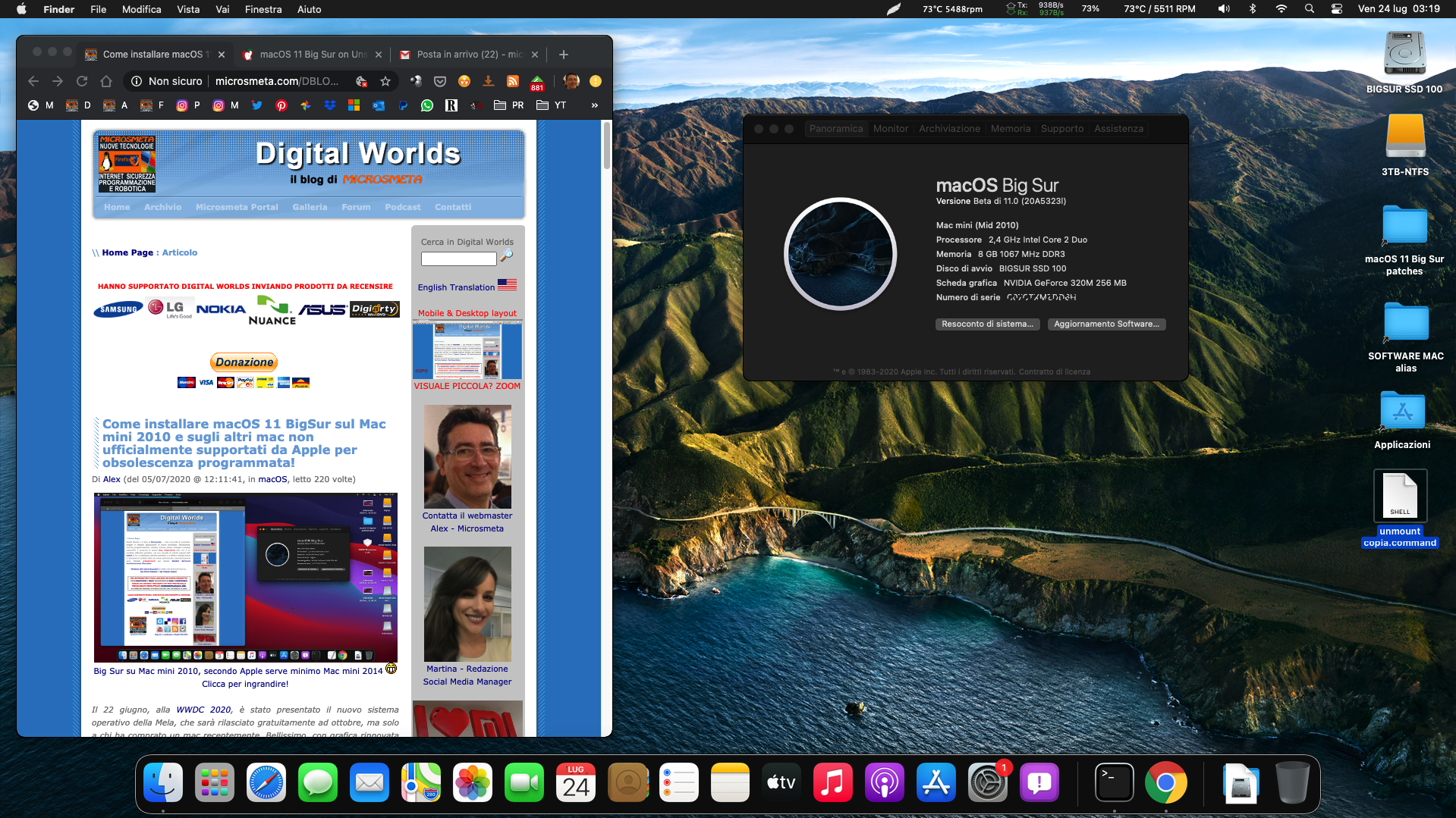

Updated to Beta 3 today on a Mac mini 2012 without making a new partition etc... went as smooth as butter upgrade from beta 1.0 ( I didn't go beta 2 as my MacBook 2017 had lots off issues on that ).
basically made did this ,
I have a 2017 Mac so I grabbed the Beta 3 download off that to start with
made the USB stick only
booted to the USB
Terminal and typed csrutil disable - press return
in terminal again type csrutil authenticated-root disable - press return and close terminal but didn't reboot.
I then get back to the option screen and I chose upgrade/install and followed the few click screens followed by a 14 min to install boot screen.
after it had all done on final reboot it took AGES to come back on and I fair gave up and hard powered the Mac down ( holding power down for 5 seconds )
The Mac then booted as normal and Beta 3 was installed as I noticed the red Music tab at the bottom and all my software was still there.
Reactions: TimothyR734
