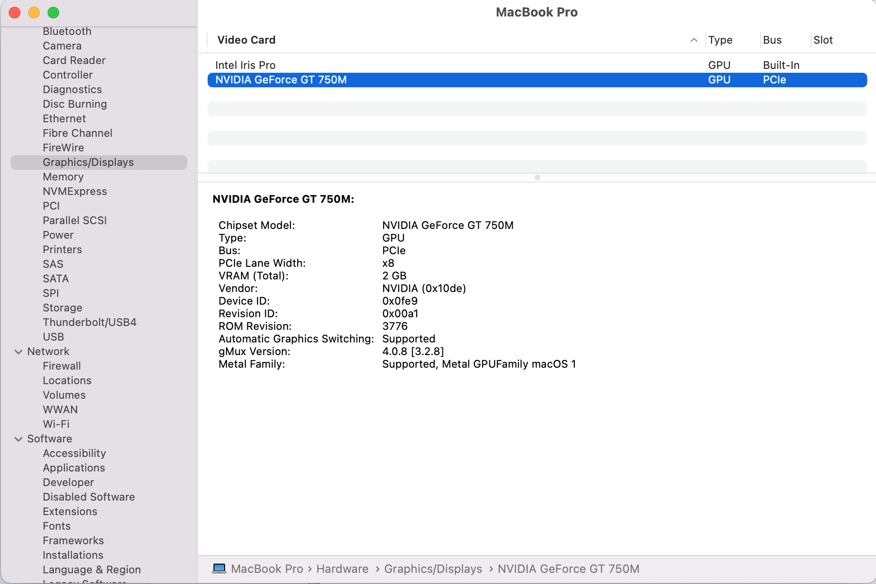

To answer my own question:
I have installed macOS 12.1 (21C5021h) on my MBP11,3. At the final boot stage it would not boot. Then I set this NVRAM variable from Recovery partition:
Code:
nvram fa4ce28d-b62f-4c99-9cc3-6815686e30f9:gpu-power-prefs=%01%00%00%00
After that I was able to boot 12.1 beta.
But NVIDIA is not switchable anymore:

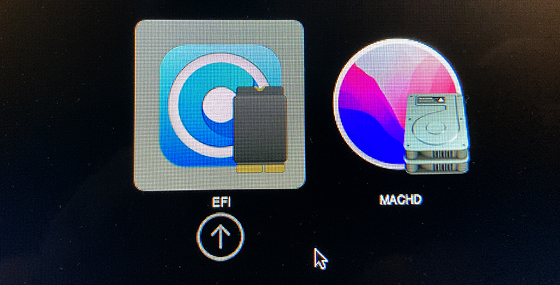

I have also nvidia card, maybe i need, ok i will patch…im waiting 2 hours for update, is it normal?
It is installed. Here is the screen which I see when booting with option key
Right EFI icon is true, but left one is wrong, and in normal booting just left icon appears as default
In order to avoid future problems please do as @Ausdauersportler advised and:
  1. Try to find and delete the OCLP installation you did to some external drive (that's the icon on the left).
  2. Then you should reinstall OCLP on the internal drive.
  3. After that clear the NVRAM.
  4. Then boot using alt/option key, select the remaining "EFI Boot" using ctrl key + enter key.
  5. Finally select MACHD using ctrl key + enter key.
Code:
Nice, this could be the second chance for my 11,3 MBP. I don't care about the heat, the macbook is attached to an external display (which forces it to use the 750m anyway). Is this possible without kepler driver installation and SIP enabled as the Iris Pro only models? https://forums.macrumors.com/threads/install-macos-monterey-12-macbook-pro-retina-late-2013.2307146/ Would you be so kind to describe the necessary steps for your setup?

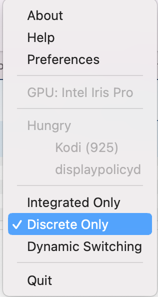

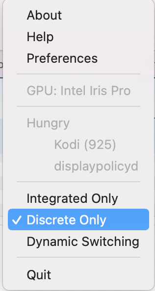

Why does the app go back to dynamic switching when a display is plugged in?
Unfortunately your mac is designed such that in order to use an external display, it has to use the discrete graphics card. And since you plugged in the cable I'm assuming you want to use the display.
How do I disable my discrete GPU?
You can't, your macbook was designed to use both, but gSwitch can trick it into using the integrated one most of the time. However gSwitch cannot prevent your discrete gpu from being accessed by the operating system, and it will be accessed for a short period of time when a process requests the use of it. gSwitch just switches back to the integrated one as fast as it can.
Answers​

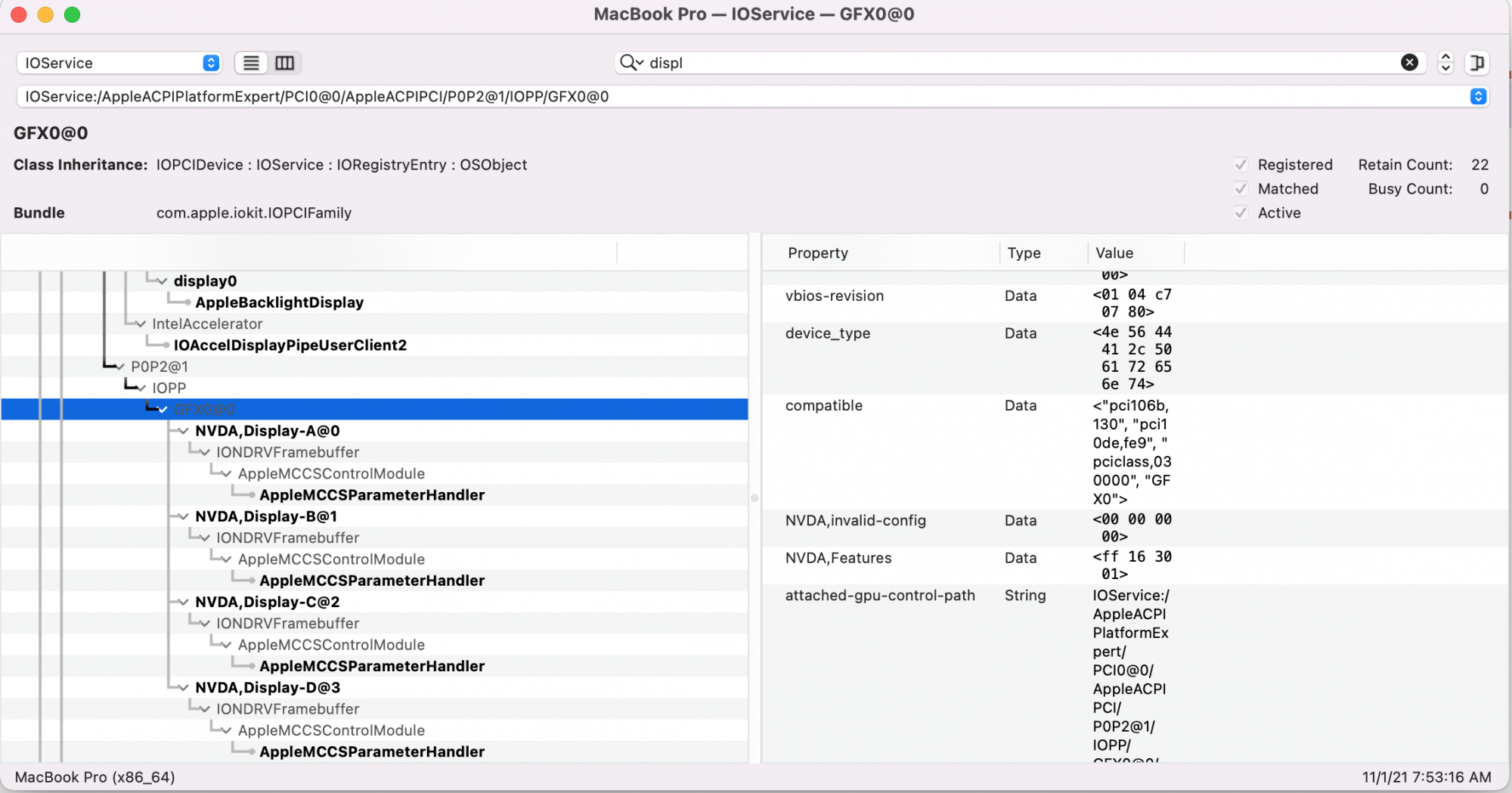

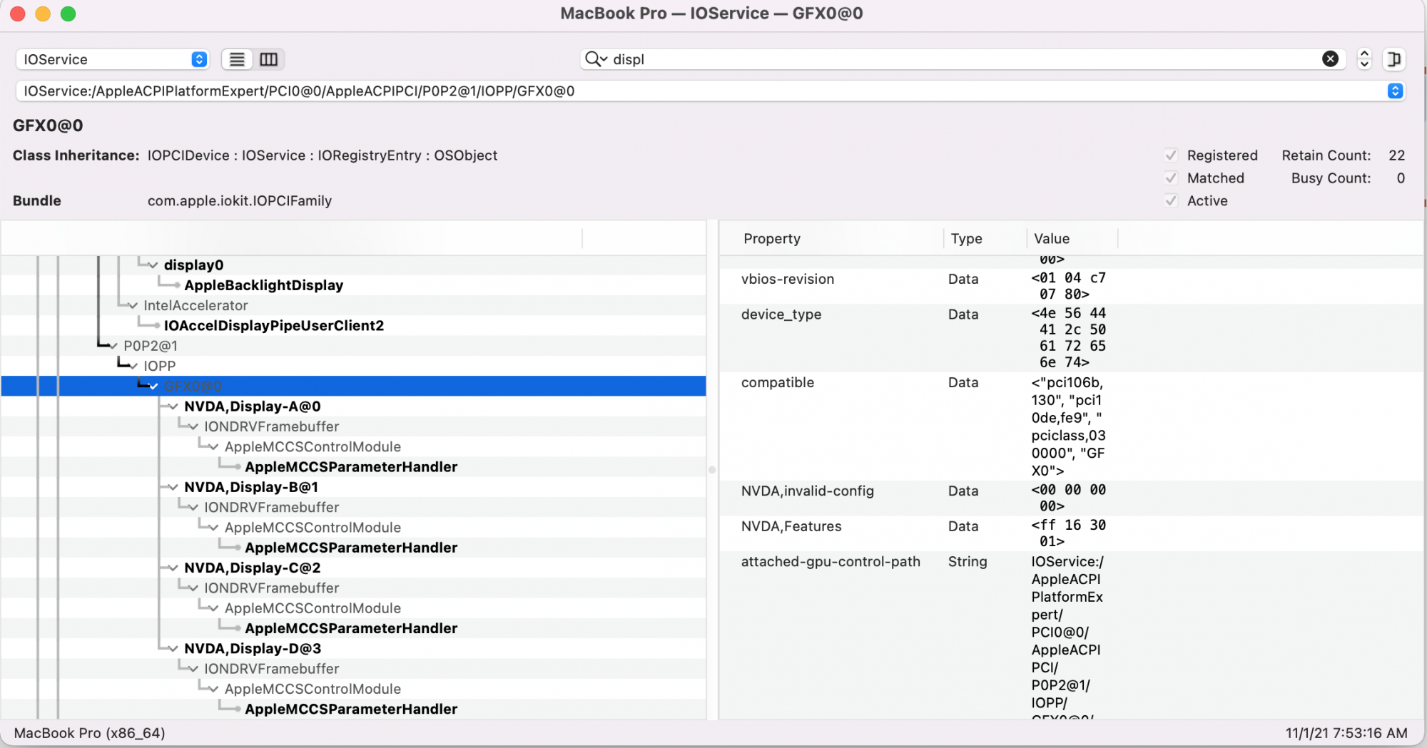

What will happen if I permanently disable the discrete nVidia graphics card from EFI? Will Mac OS think integrated GPU is the one installed and let me use multiple monitors with it?
You will lose any ability to use an external monitor (under any OS). The external graphics port(s) are wired to the discrete graphics chip.
Besides there are no Nvidia drivers loaded.
  • loaded_kexts.txt

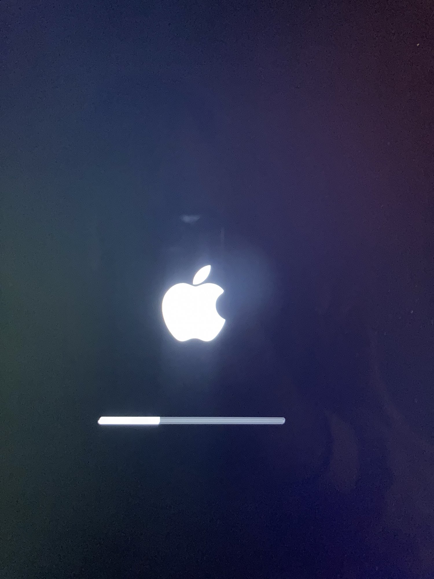

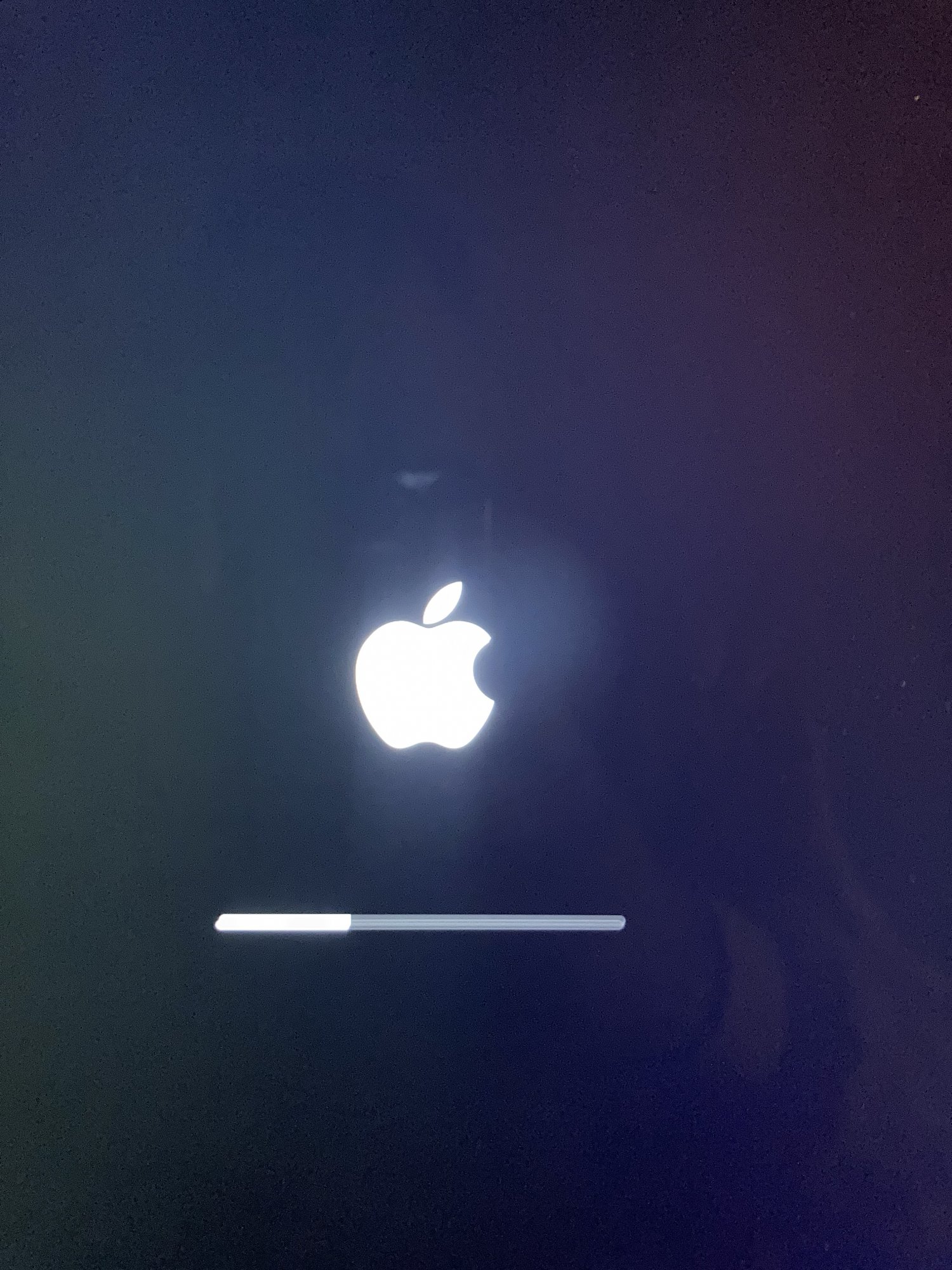

I updated, my MacBook doesnt boot 😭View attachment 1899709
You need to go to recovery mode and set:
Code:
If you want to use NVIDIA you need to patch the system with the NVIDIA drivers from the last Monterey containing it (OCLP can do that). Later you have to reboot to recovery and set:
Code:
nvram fa4ce28d-b62f-4c99-9cc3-6815686e30f9:gpu-power-prefs=%00%00%00%00
