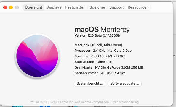

Why not a final release?View attachment 1899904

I still had the version on HDD. The Release is yet to come.Why not a final release?

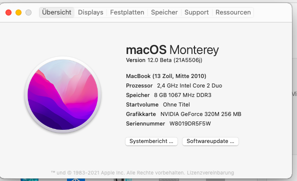

macOS 12.1b runs way better than the early betas, even b6.View attachment 1899904

did you have to do anything special to get 12.1b installed.macOS 12.1b runs way better than the early betas, even b6.
