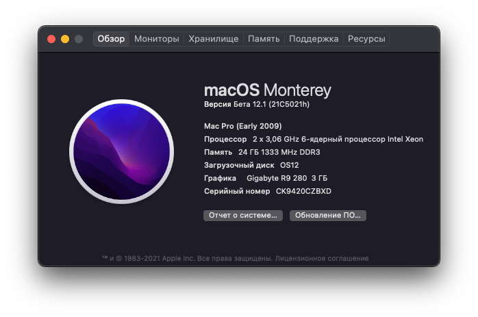

is it possible to instal 12.1. beta on other through USB connected clear disk starting Instal macOS Monterey beta exactly from Application directory? Or it is necessary to do only from created setup disk?
Ive done both and it works great but remember you need the correct OC for this to work on unsupported Macs.
I use OCLP 0.3.2 Nightly build.
Nightly RDRAND OpenCore Patcher (TUI)
Thanks, both of you.

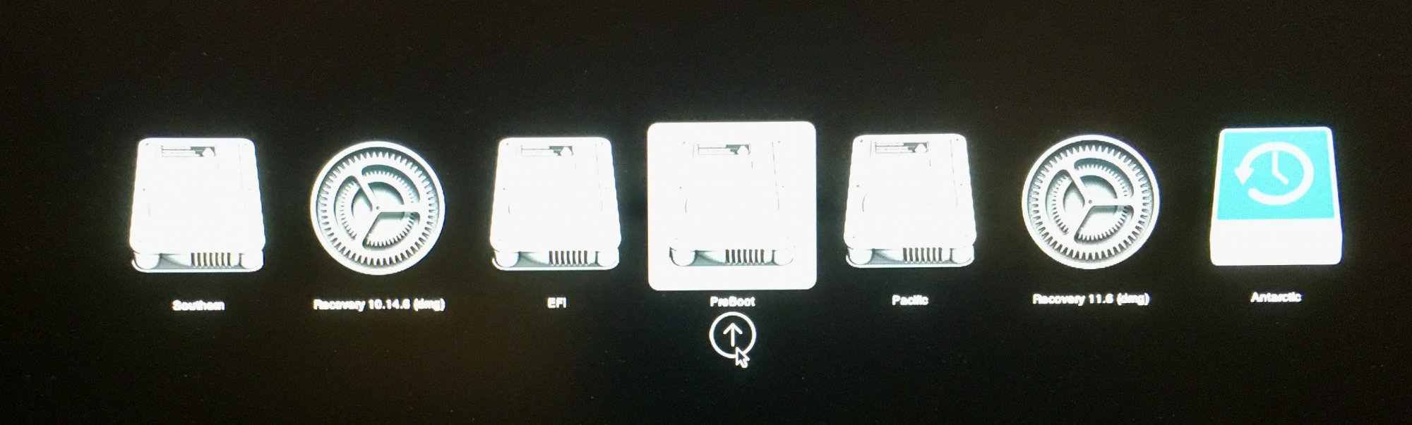

I'm having a weird Monterey upgrade issue on my Mac Pro 5,1 with Martin Lo's 0.7.5 OC package. I'm running 11.6, the update package appears in system prefs, it downloaded successfully, runs the upgrade process then reboots with no errors or problems, but I find myself back in 11.6 exactly as if the update had never happened. Did I miss something?
I watched this more carefully. After finishing the install run, it reboots with the startup volume set to a volume I've not seen before called "PreBoot". That boots, shows the Apple logo and a progress bar, which gets about 1/3 of the way across before rebooting again, with the startup volume set to my normal boot volume.
I had several attempts at booting repeatedly from the PreBoot volume, but it always acted the same way, and so I'm still stuck on 11.6. FWIW, I'm booting from a PCIe NVME card with OC installed on a separate SATA SSD. My upgrades from 11.2.3 to 11.3, and on to 11.6 all worked fine previously.

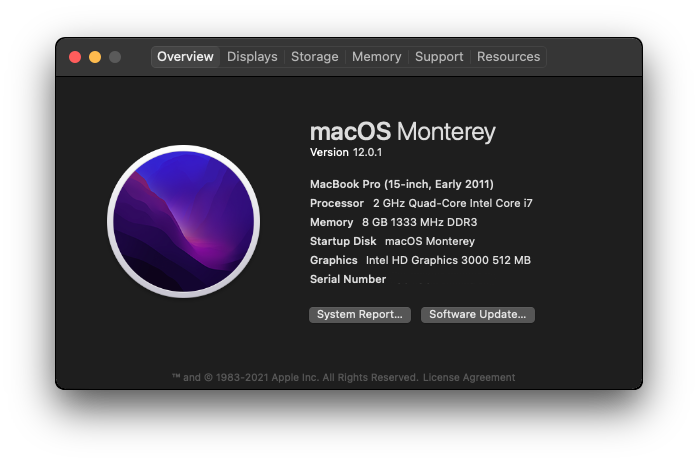

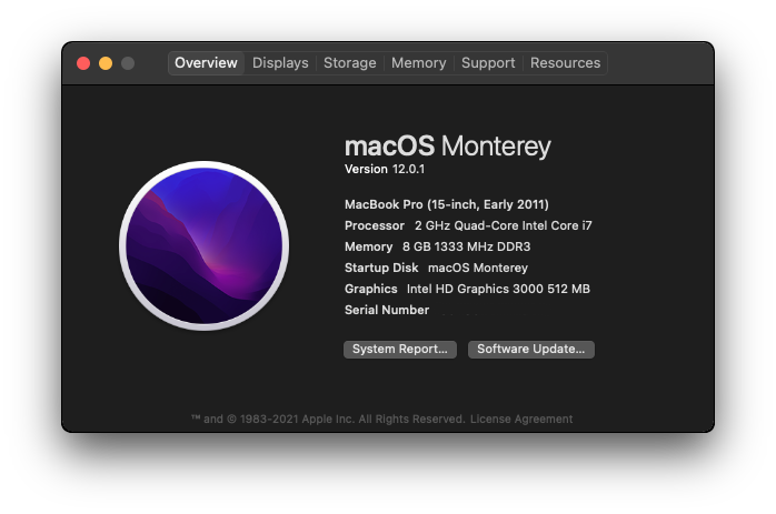

Does Maps work in Monterey on unsupported machines? I mean it works, but the map view is totally white, which renders it useless. In Big Sur the map area displayed on this 2011 MBP. I can't edit widgets either.
Reactions: Psychoakustik
Excuse me, sir. I have the Macbook Pro 8,3. You mean you have Big Sur running? With no artifacts and working everything right? I have tried many times but the graphics don´t work very good. Thanks.
I was only on it briefly. I wanted to see how it compared to Monterey. I'm almost certain that I could see the map area in Maps. Obviously with the limitations of no METAL GPU. Overall though, the usability and artifacts of the OS itself were about the same as Monterey, so I switched back to that. I'm just testing it out on a separate partition. I'll probably go back to Mojave, as it's just less buggy. Most of the artifacts are in Finder windows and the Menu Bar, but not a total mess.

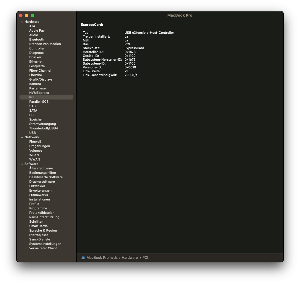

I have a nanoTECH expresscard with two USB3 ports which I use to connect external disks in a faster way than with the onboard USB2 connectors.
Worked upto Big Sur 11.6.1 (and maybe still Monterey 12.0.1, I forgot).
Doesn't work anymore in 12.1b1: card is detected, but when connecting a USB disk to it, the OS fails in that the pointer of the internal trackpad (connected to internal USB) stops moving.
Will certainly affect very few users, and I could also live without it.
Maybe an effect of the beta software, going to analyse further.
EDIT: a mouse connected to this USB3 works correctly.

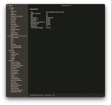

I have a nanoTECH expresscard with two USB3 ports which I use to connect SSDs in a faster way than with the onboard USB2 connectors.
That’s unfortunate, I happen to have the same card in a MacBookPro4,1 and really like it for not needing any kernel extensions so far (only tested up to Big Sur 11.5.x beta yet).
I also have some of the 'cheaper' XpressCard34/USB3 but they always needed a driver (kernel extension) present to work. But in Monterey we wouldn’t get any of those to work either, or am I wrong?
