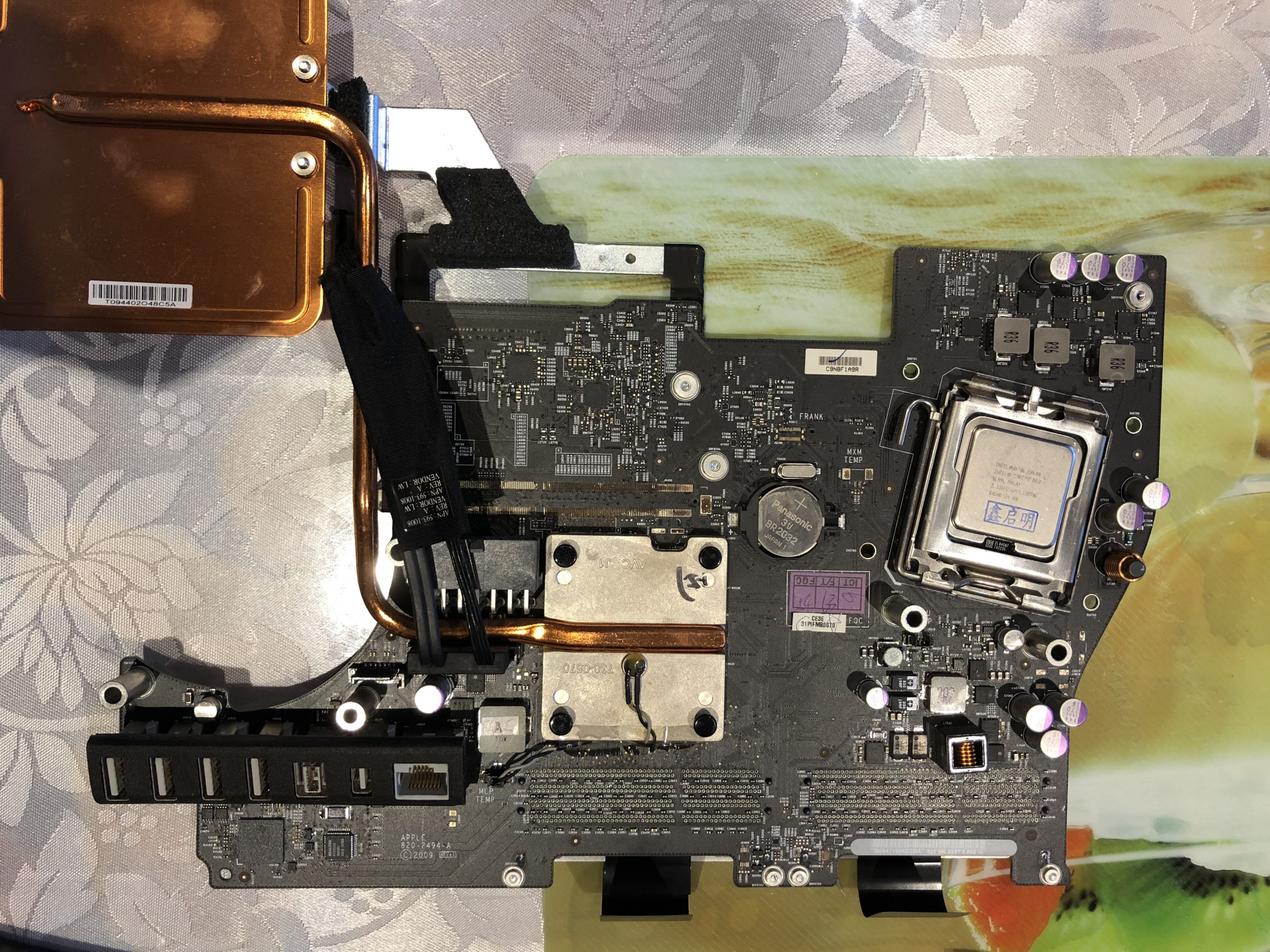

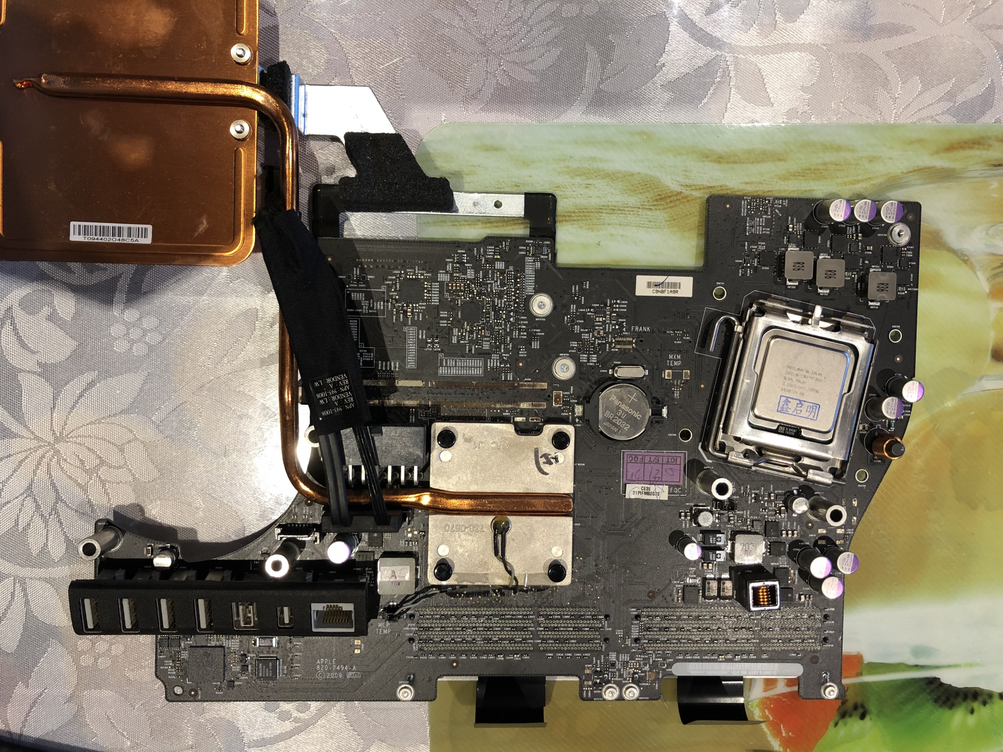

slightly off topic:
So you have a 27 iMac10,1 late 2009 - so adding a metal card might work. Try a K610M or (red) Dell M5100 - would be really interested in results 🙂
Thanks for your encouragement 😀 it‘s a 21.5” late-2009 iMac which has the onboard graphics chip.
I do have another 27” 2011 iMac for which I’ve ordered a K3100M card and eagerly waiting for the arrival😅
wish me luck 😀🎉🍾
Reactions: Pri-est

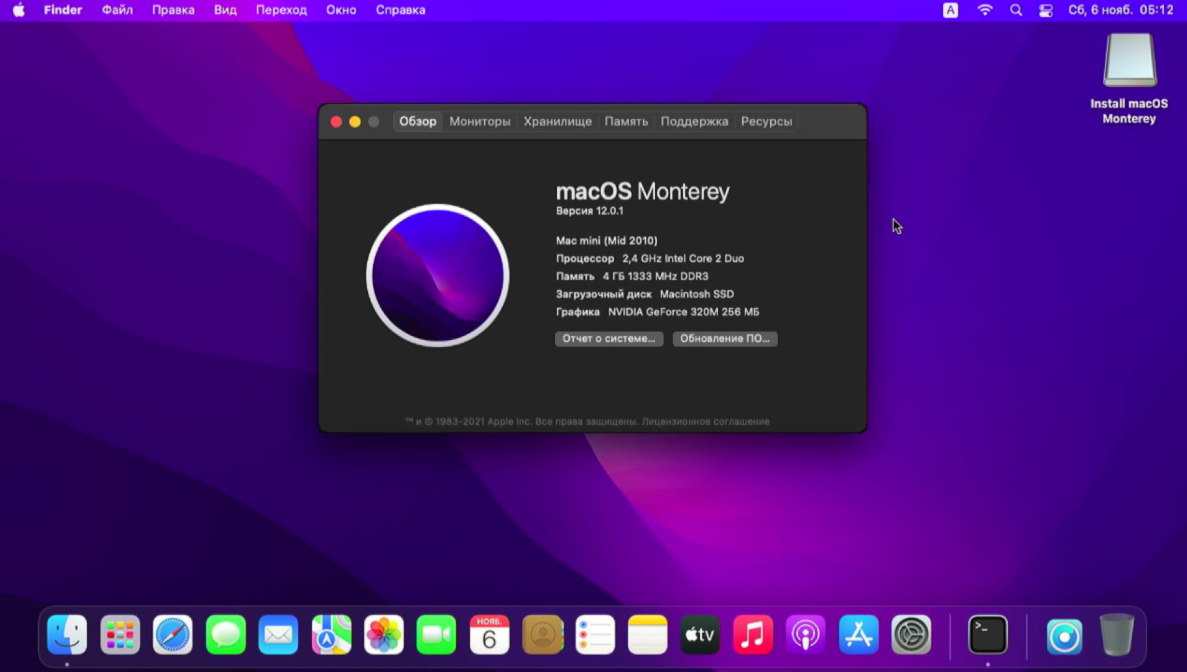

Hello. Installed Monterey on MacMini 4,1. Wifi, graphics have, sound not have. How fix it?
Reinstall not fixed. USB sound card works.
Kext install HDA and Alc not work...
