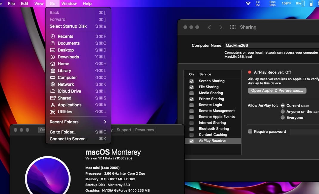

In before I am using OTA to upgrade to b2, the system preferences ->> share airplay receiver setting is disappear.
After I am cleaned install the b2 with OLCP 0.3.2, the system preferences ->> share airplay receiver setting is appear again, but I am using the iPadOS 15.2 beta 2 or 3, YouTube apps to play video the airplay is disconnected. It seems the macOS to drop the airplay stream. Is it the display driver problem. I am using MacBook Pro 2014.
