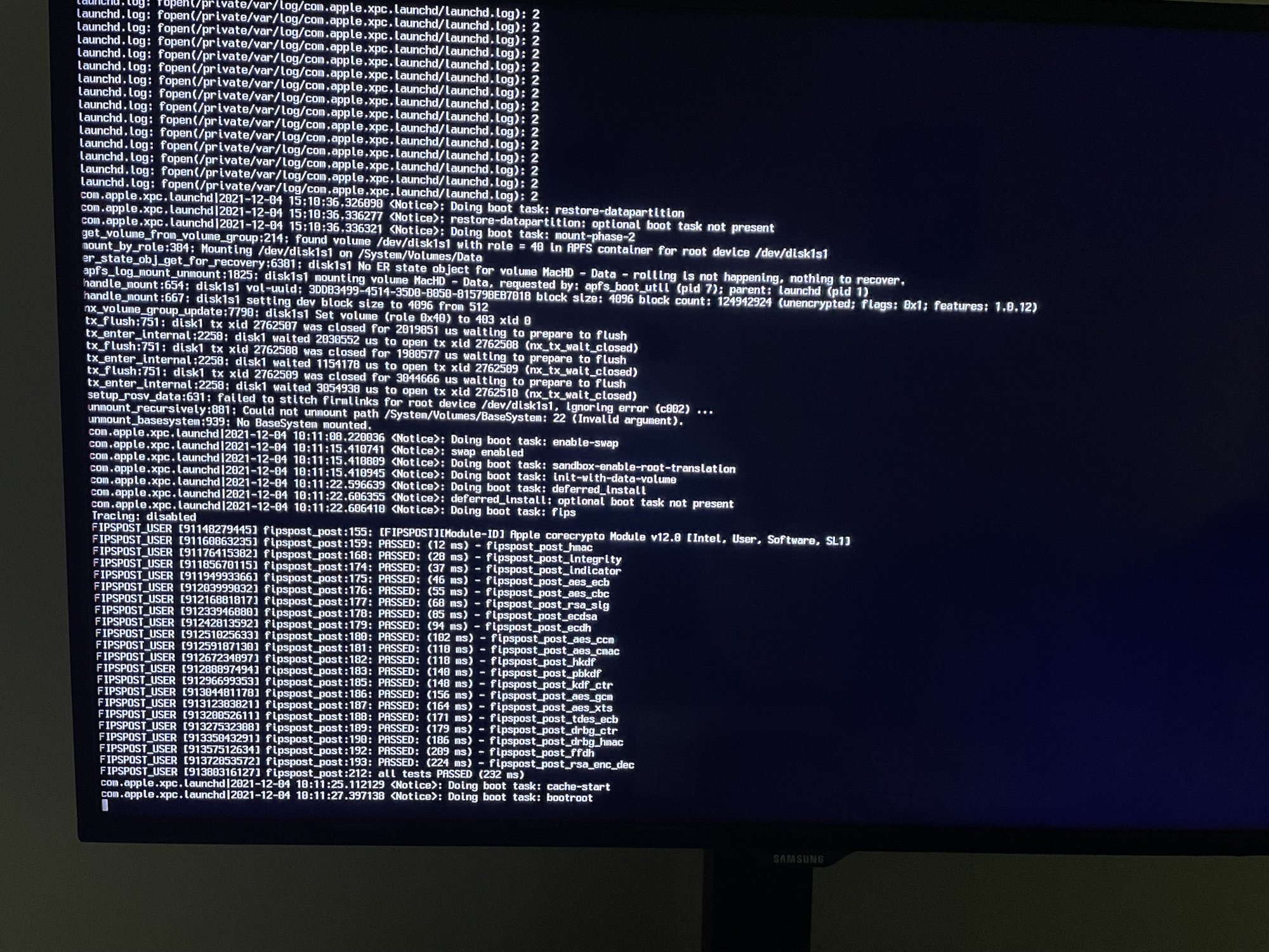

Enable verbose mode and check the logs on screen.

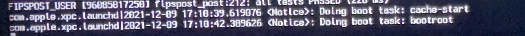

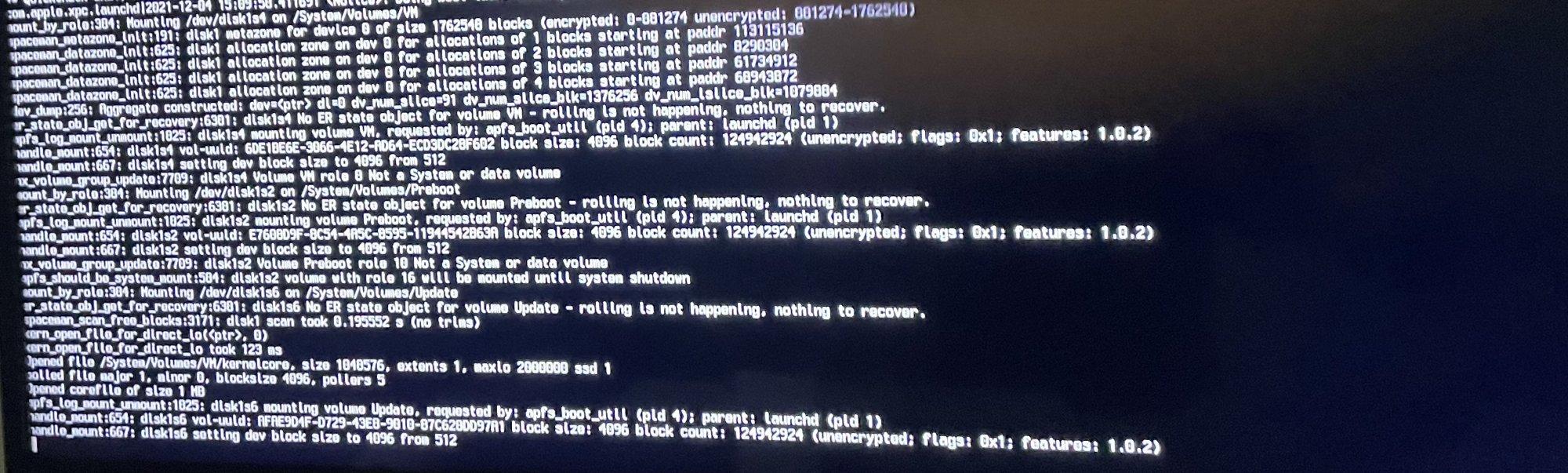

Here are two pictures from when the long pauses occur during boot. I don't see anything crucial, but hopefully someone with more experience can chime in.

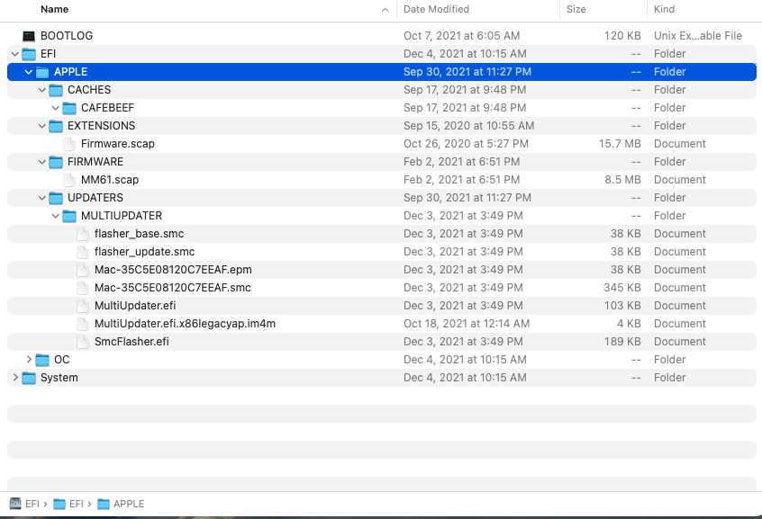

Here are the contents of EFI/Apple. Since I don't know what any of this is used for, I will simply ask, is it safe to delete EFI/APPLE as suggested?

It is full of firmware update files. Those updates will only run when booting into an supported macOS versions. Assuming that you Mac is still supported with Catalina you should (once in a while) boot Catalina and update Catalina from an internal disk to apply those firmware updates.
This rule of thumb is valid for all still supported system 2012 an later.

Hmm. I don't have Catalina on this machine anymore; only Monterey. That being the case, and looking at what has been suggested, can I safely delete these? I have zero plans to revert back to Catalina... ever. I'm more interested in solving my 4 minute boot issue.

This is not a smart plan. You should have a small 50GB APFS container just for Catalina and just to keep your system up to date.
You can delete all the contents of the Apple folder. Do not know if this solves you problem. Long boot times may also be a sign for failing hardware. The system tries hard during boot to get it working unless it gives up.

Regardless, I copied the EFI/APPLE folder to a USB stick and then removed the files from the internal drive. Nothing exploded, but it also didn't solve the long boot issue.
Before doing anything time consuming like reinstalling Catalina to update firmware etc. you should just make a backup of the EFI partition and then delete the firmware files from the EFI partition to test if its even the problem for not booting fast enough.

Hmm, ok. On which line does it stand still the longest? Btw, i also have that line with "SDXC card slot powering off...", but like i said mine only takes about 45 sec. to boot.
Okay. The bottom line (boot root) is where it stalled for a majority of the 4+ minute boot time
