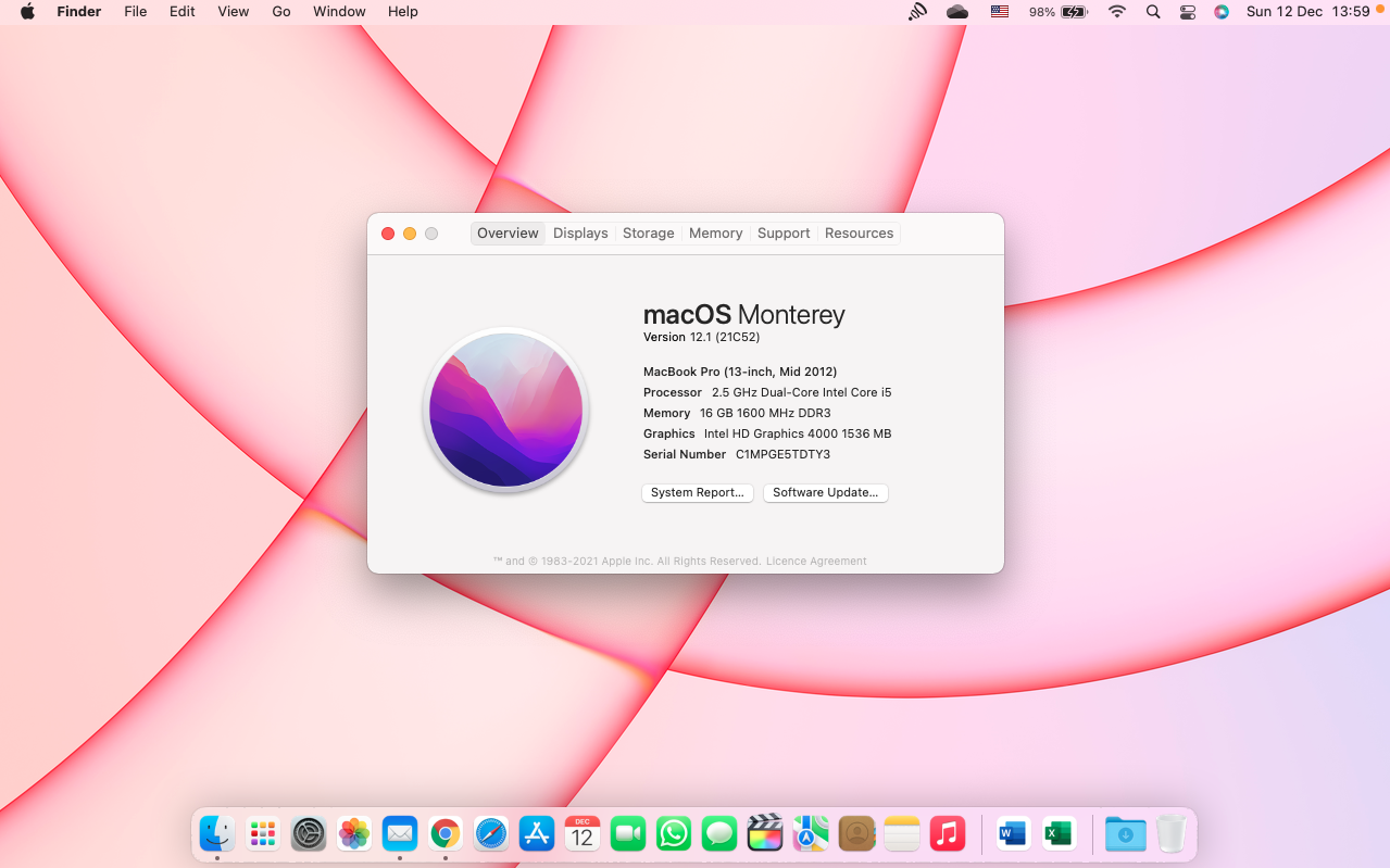

Succesfully updated my MBP 9,2 mid 2012 non retina to macOS Monterey 12.1 - 21C52. All working perfect and smooth. Have a great day everyone!

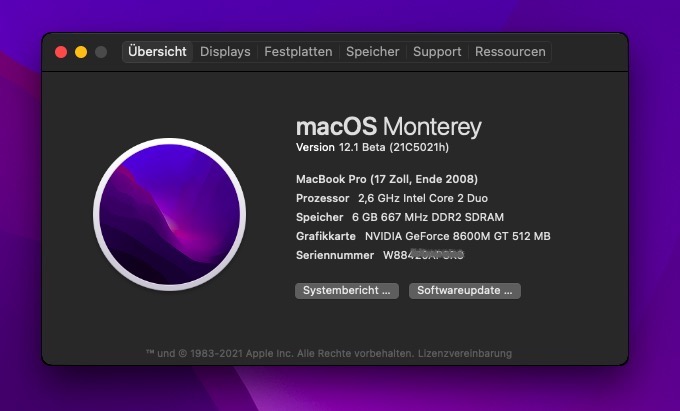

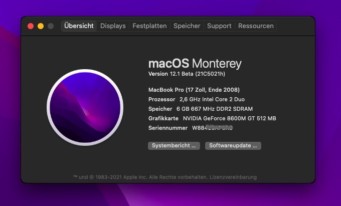

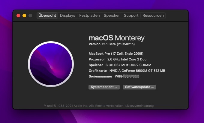

OCLP 0.3.2 (nightly) with RDRAND patch let me install 12.1b1 on my trusty old MBP4,1 (glossy highrez).
Thanks @Syncretic and team.
MBP4,1 Early 2008 17-inch Big Sur 11.6.2 with excellent performance, better than Catalina.
Can't complete the installation of Monterey 12.0.1 via OCLP 0.3.1. over external USB drive
Our machines share the same SMIOS identifier "MBP4,1".
Would you tell me, how you successfully installed 12.1b1?
Where can I get OCLP 0.3.2n with RDRAND patch (what is that btw, and do I need it also?) as per your post above?
(EDIT: I found OCLP 0.3.2 nightly build TUI via search in this thread, but no offline version, or GUI)
I was using OCLP 0.3.1 TUI (with Ethernet connection during installation) and TUI Offline with WLAN connection. I also tried OCLP 0.3.1 GUI... all providing the same result: after about 30mins. into Monterey installation, the MBP4,1 reboots, then is stuck. Once I reboot with alt-key, choose my Macintosh HD, I am on Big Sur 11.6.2 again, with 13.4GB of macOS Install Data leftovers in the System folder. I was able to delete the macOS Install data.
In all futile attemps, I chose to upgrade my existing Big Sur installation, I did not try a clean install yet.
Advice, how you bumped your MBP4,1 to Monterey 12.1b1 is highly appreciated.
Maybe @K two also has some tricks up his sleeve?
P.S.: I did n o t try to upgrade from the OTA update via System Preferences, as the update is "macOS Monterey beta 12.1". Is this the way, and if so, with which version of OCLP?

Now on Monterey 12.1RC in the meantime. The trick is to prepare a boot volume with OCLP including the RDRAND patch enabled. You will find this option in the 0.3.2n build (and probably also in 0.3.1, not sure, would have to DL and check again). Also make sure that either you have your EFI flash patched for APFS or also enable APFS boot through OCLP. (Can be ignored if you're still on HFS+ if this still supported at all for installation on Monterey).
The other hint: During the 2nd boot phase (and following ones !) it's advisable to boot in verbose mode to see if you're really stuck or it just takes long to run the installer stages. Actually, it can really take so long that ppl reported to let it run overnight!

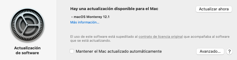

Is it safe to update OTA?
