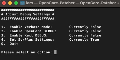

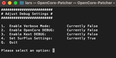

Where is the RDRAND patch located within OpenCore-Patcher?
What am I missing?
Hi, sorry, the nickname is SurPlus, the function it serves is RDRAND. Can be found here (see screenshot).
Also, can you take a photo of the few lines when your 2nd boot stalls?

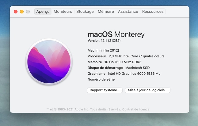

Successful 12.1 (21C52) update with software update (12 GB) on a Mac mini late 2012 2.3 GHz Intel Core i7 quad core. On this machine I of course used Chapter "3. Post-Install Volume Patch" to run my second screen, graphics acceleration and all the rest. OCLP version 0.3.1
** I just repatched it with OCLP 0.3.3 and everything is ok again.
