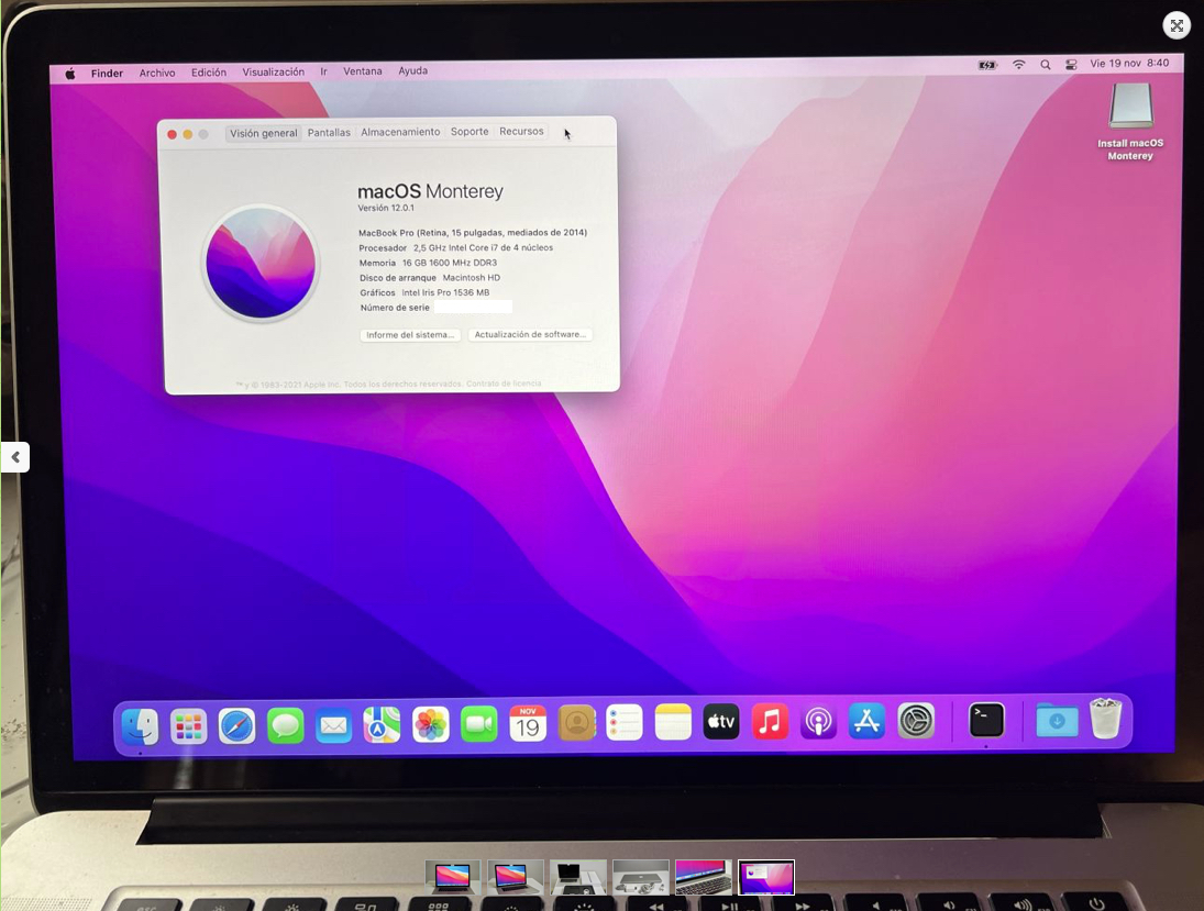

In my Macbook Pro 15" 2014 Monterey was perfect.
Reactions: Pri-est and K two

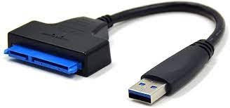

I have just remenbered one thing. Once I couldn´t see the "Macos Installer" volume after first part of installkation, after first reboot , I mean. I used then a SATA to USB and ,voilá, it was there.
Do you have one of these?
After installing in the SSD I cloned it to the NVME

Update from 12.0.1 to 12.1
02:04 auto restart into "Macintosh HD" through OpenCore to do update
02:09 auto restart into "Monterey" through OpenCore
In Macbook Pro 15" 2014 , after intalling you only can see a black screen, tough you can listen to asistant voice. Only after apply patches in safe mode you can see the normal screen.
