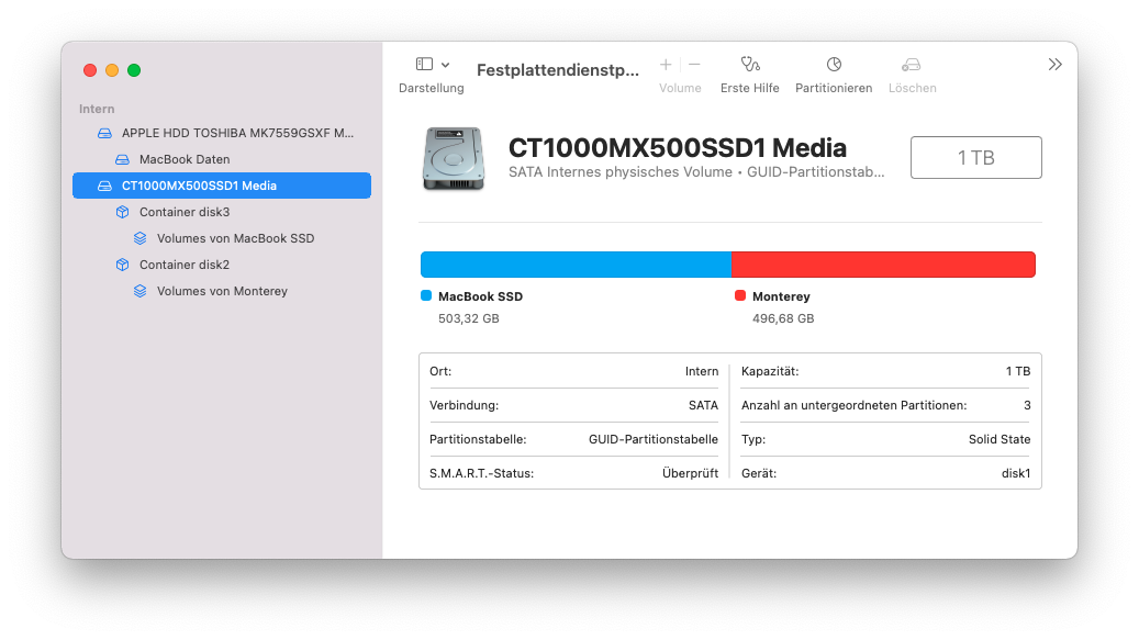

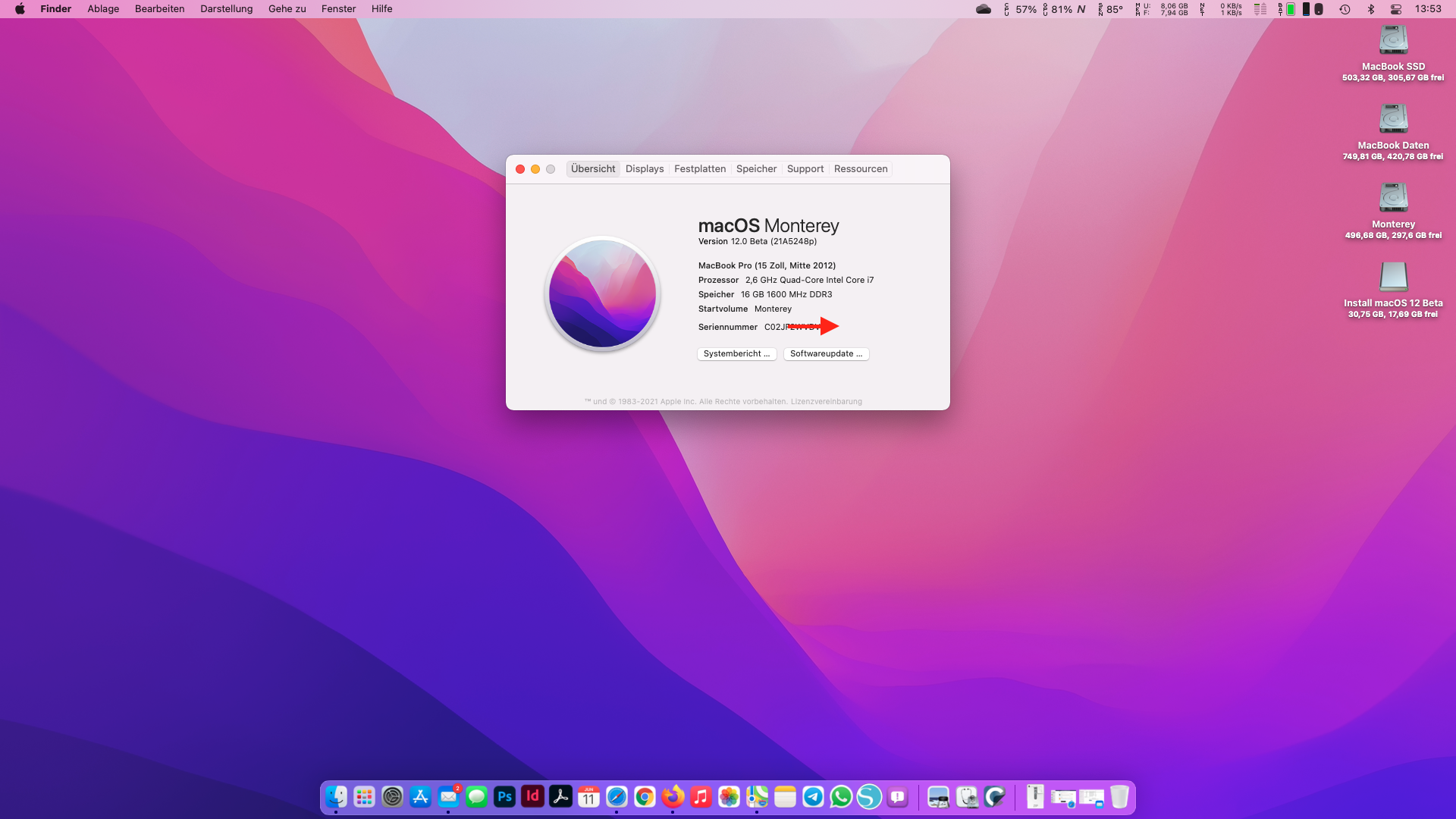

did not find if the MBP mid 2012 non retina works... so I tried my self.
My steps: MBP mid 2012 with BigSur (patched) SSD with BigSur (cloned for installation)
Download InstallAssistant Package from post#1
install InstallAssistant
open terminal type:
sudo /Applications/Install\ macOS\ 12\ Beta.app/Contents/Resources/createinstallmedia --volume /Volumes/USBNAME
Download and open Nightly OpenCore-Patcher
#1 build OpenCore
#2 Install OpenCore to internal Drive
reboot and choose opencore boot

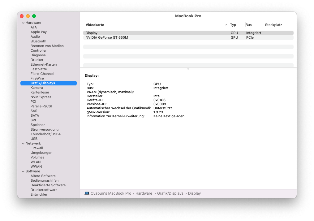

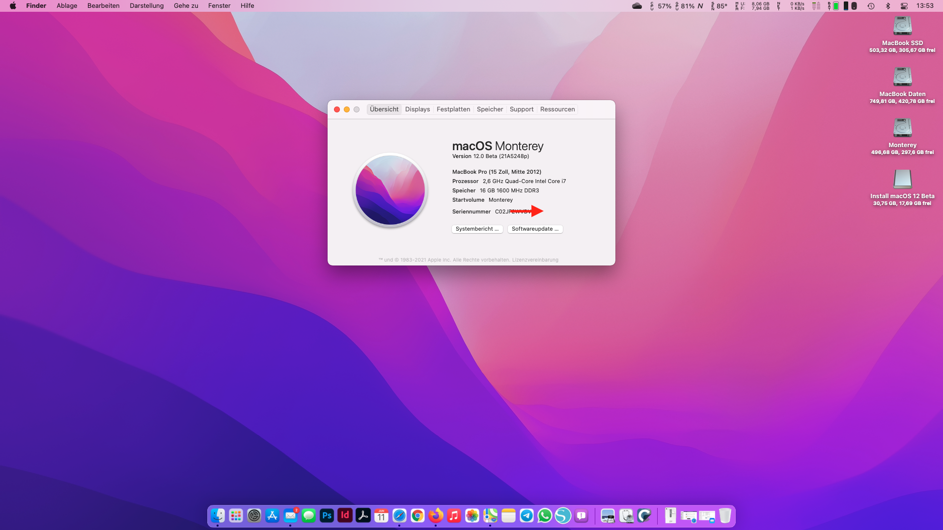

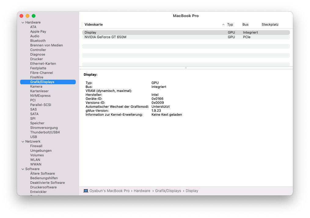

start installation MacOS 12 beta over MacOS 11 - after a while it's done and works. BUT only with the Nvidia GPU even if I disconnect the external Display - GPU is still active.
View attachment 1791244 View attachment 1791246
i have same model but i have intel hd 4000 :(
From what I read on pictures others posted, when Monterey on unsupported Metal Mac shows and detect "Graphics" on "About this Mac" then any IGPU feature should work as display mirroring.
If "Graphics" is hidden could mean there is an issue in detecting correctly the laptop built-in display, I'd exclude that this depends from any kext, rather I guess in some Display* or MonitorPanel framework so also on /System/Library/MonitorPanels/ where there is the Arrange.monitorPanel , the "Arrangement tab" is automatically added to Displays.prefpane when plug to an external video output signal.

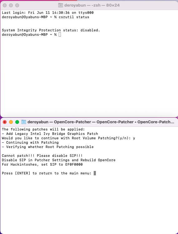

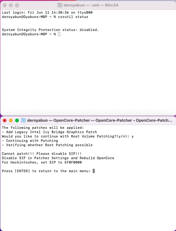

Post patching with open core patcher does not work.
SIP deactivated but still receive "cannot patch!!! please disable SIP!!!
Any idea why?

From what I notice on pictures others posted, when Monterey on unsupported Metal Mac shows and detect "Graphics" on "About this Mac" then any IGPU feature should work as display mirroring.
If "Graphics" is hidden could mean there is an issue in detecting correctly the laptop built-in display, I'd exclude that this depends from any kext because if I don't get wrong the wired HDMI display mirroring works also without acceleration , rather I guess apple removed some references in Display* or MonitorPanel framework so also on /System/Library/MonitorPanels/ where there is the Arrange.monitorPanel , the "Arrangement tab" is automatically added to Displays.prefpane when plug to an external video output signal.
Any idea why?
You may add a signature, we cannot guess which system you are attempting to patch and nobody wants to search back several pages just to gather all information a user has spreads over several posts.
Patching for the 2012 was not necessary with Big Sur. So there will be no gain in trying it because it was meant - so far - for legacy pre metal video patching.
The code base of the upcoming OCLP 0.1.7 is the same as the Big Sur patcher and to my knowledge there has nothing added regarding the HD4000 so far. Please join Discord and check the online docs about the support list for post install patching.
The code base of the OCLP 0.1.7 is the same Big Sur patcher and to my knowledge there has nothing added regarding the HD4000 so far. Please join Discord and check the online docs about the support list for post install patching.
Yeah okay. I will add signature. But: Patching was not necessary with Big Sur? Graphics yes - no need but for wifi i used the Big Sur patcher for sure..
the problem is that I can't use the internal graphics. I can't regulate the brightness for the internal display.
I tried to patch with the open core patcher nightly disabled SIP and SSV bt still not working.

Monterey dropped HD4000 support (and it is not only the HD4000.kext missing). To get this back one has to find out what Apple has pulled from the system and what and how to patch it back without getting linking errors and brewing other things. This is not a 60 minutes effort.
The WiFi functionality came back in through pre-boot injection of legacy kernel extensions. There was no patching, i.e. no adding or changing of kernel extensions on disk( unless you had to do the video legacy patching).
This is the great beauty of OpenCore: No changes on disk, no broken seals, Apple software updates works as Filevault, until you start patching.

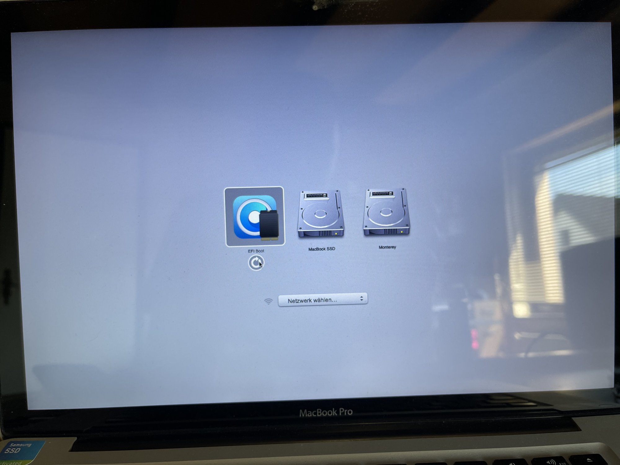

of course.. I see. it's not a big issue for me at the moment. right now I have a bigger issue :-D I tried to use my Big Sur partition but this is not starting anymore. I have one disk, 2 partitions. Monterey starts but when I choose Big Sur I receive a forbidden 🚫 sign. After a reboot with the alt key internet recovery starts.
now I have to figure out how to use my "old" Big Sur partition.
if someone has a hint that would be great 😂
Installing, starting and using OpenCore is covered in the online docs linked in on post #1. After reboot with the alt key you should pre select (using the CRTL key) the OpenCore EFI, boot into it, select the Big Sur partition and start it. You cannot boot directly into an unsupported macOS version unless you use at least some technology to allow starting it up.

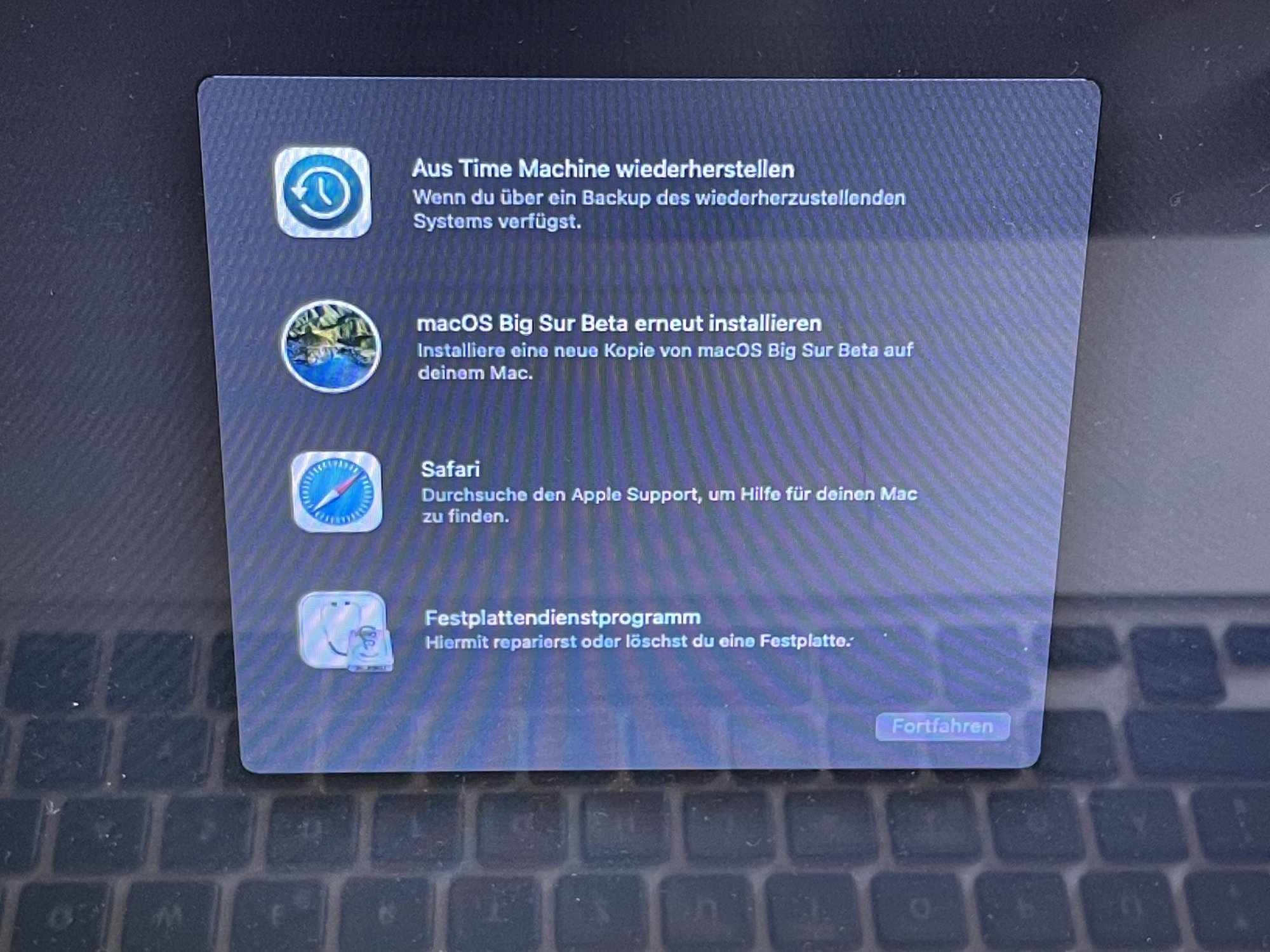

I guess I’m to stupid 😂

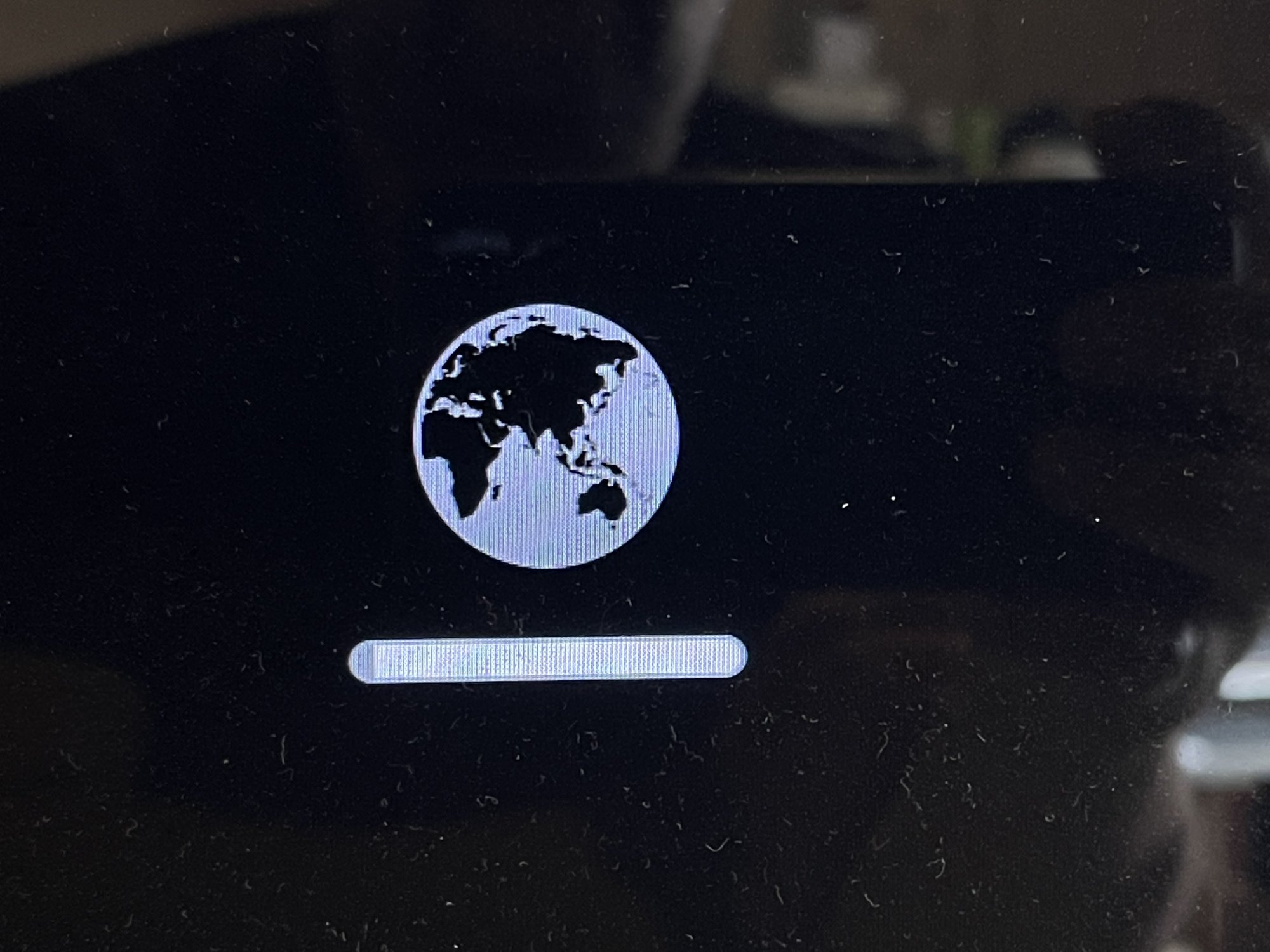

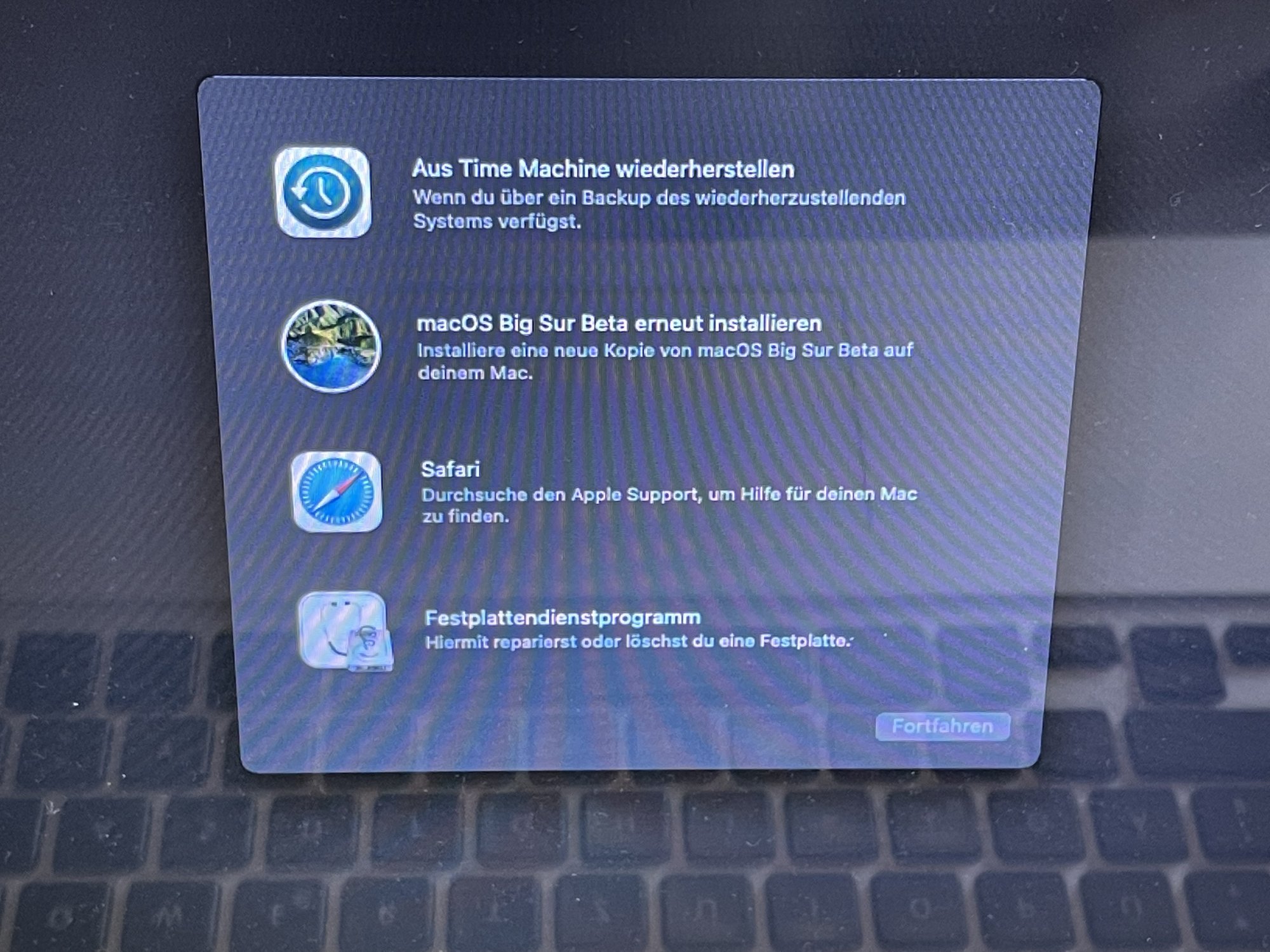

Tried what you said - then I received the internet recover. After another reboot Big Sur recovery starts automatically.

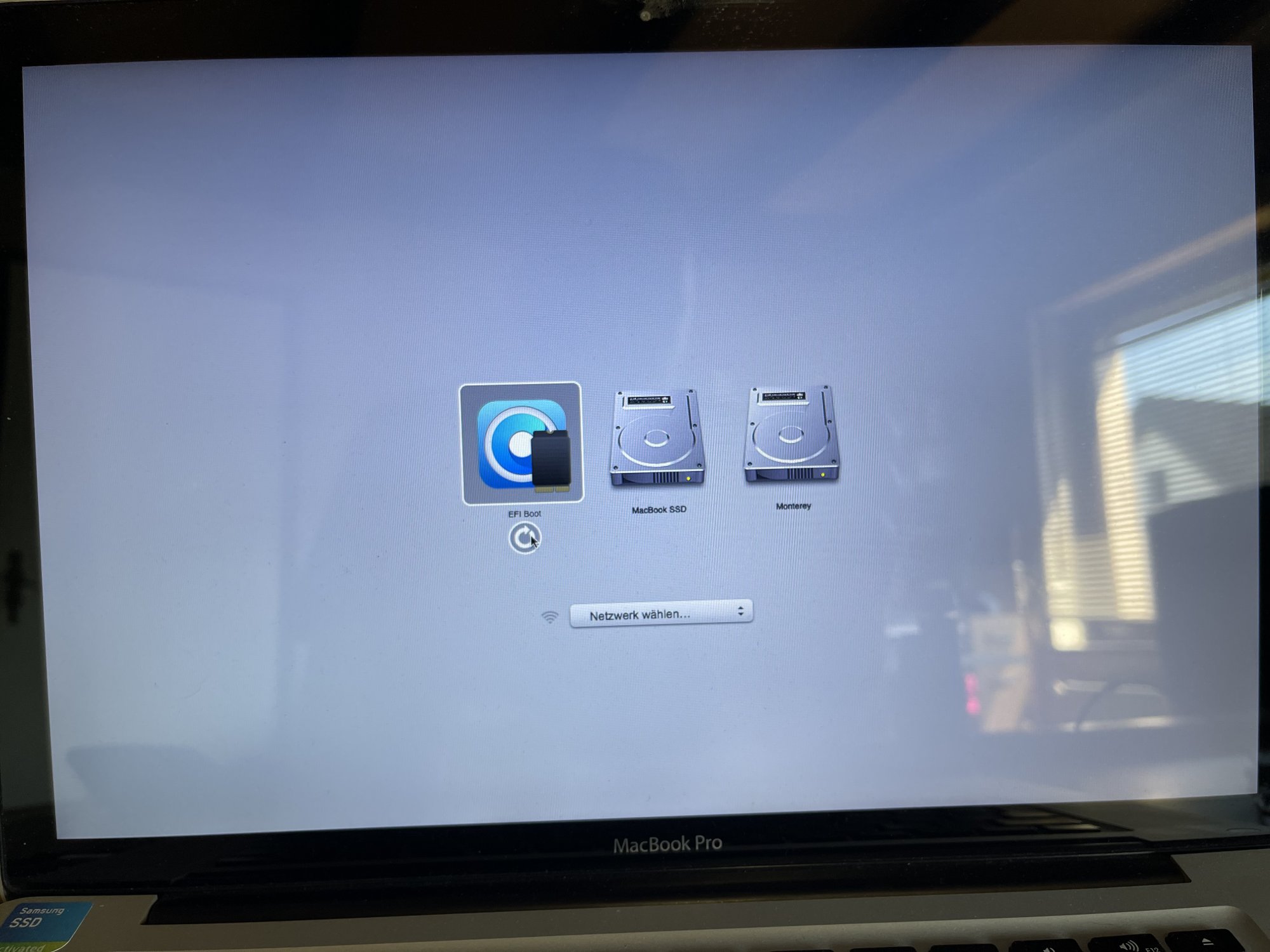

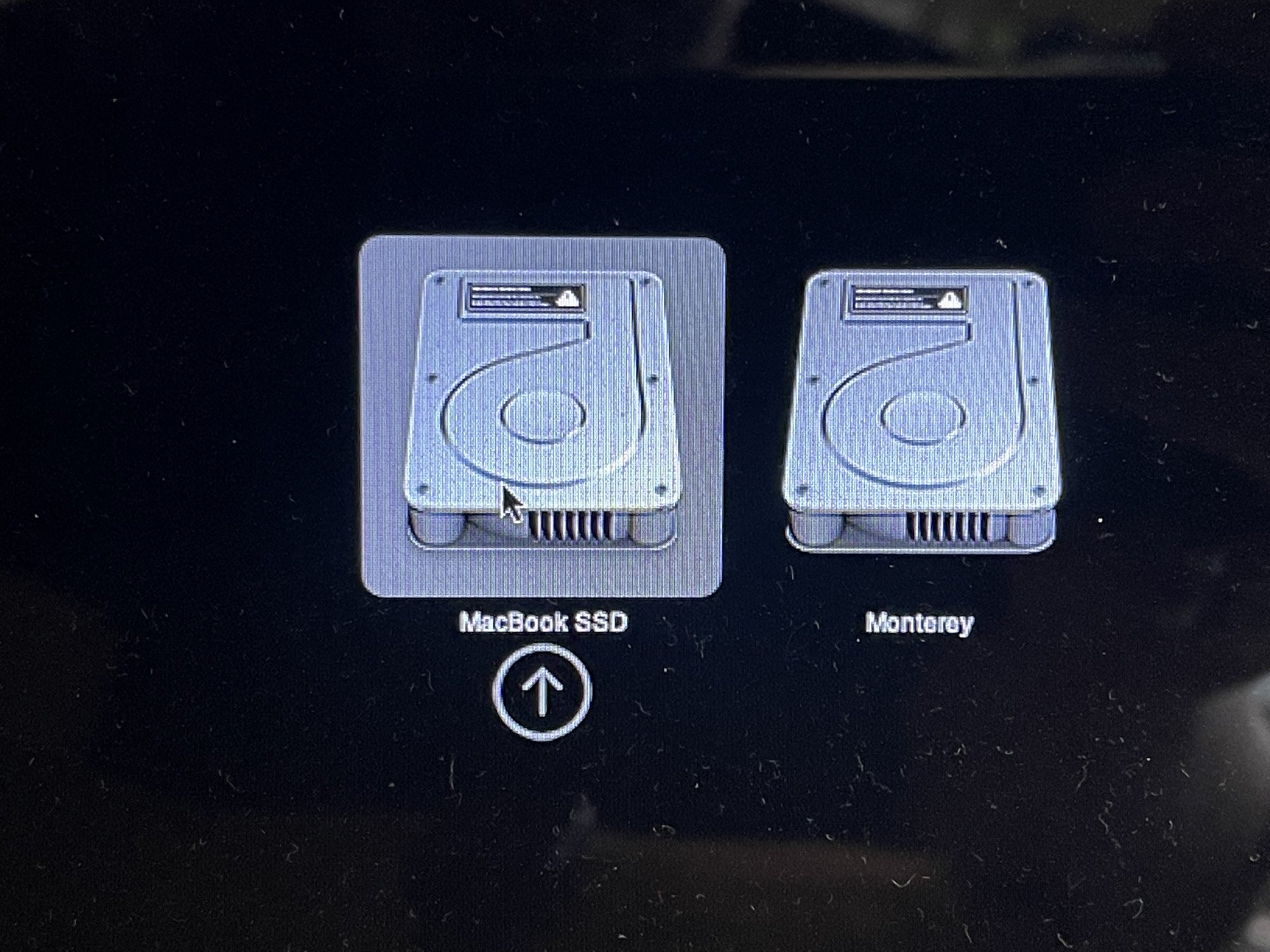

4743F165-E03E-44FF-BE89-F366DFA9389F.jpegD30C4D01-5D96-4621-AAD9-FB3B35868537.jpegD6243C3B-F35A-444E-9E0D-F34CF6336E53.jpeg836E6A4C-AD87-4B84-83B4-C0538C921AEE.jpeg
View attachment 1791313View attachment 1791315View attachment 1791314View attachment 1791316
You have installed a Big Sur Beta? You may just take your Big Sur installer and reinstall the very same version (or a more recent one) on top of the existing one. This way your are keeping your data.
Something broke possibly the preboot volume, I do not know. When installing new Beta versions of macOS like the current Monterey I would strongly recommend to use a different partition on your SSD or a second external disk, not just an APFS container.
Reactions: iMac-iPad

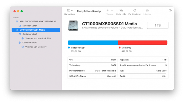

yes. but im sure its the lastest Big Sur beta 11.4.
however I split my ssd 50/50 cloned the Big Sur and installed Monterey over.
monterey still starts.. so I need to reinstall Big Sur and then both will work (maybe?)?
