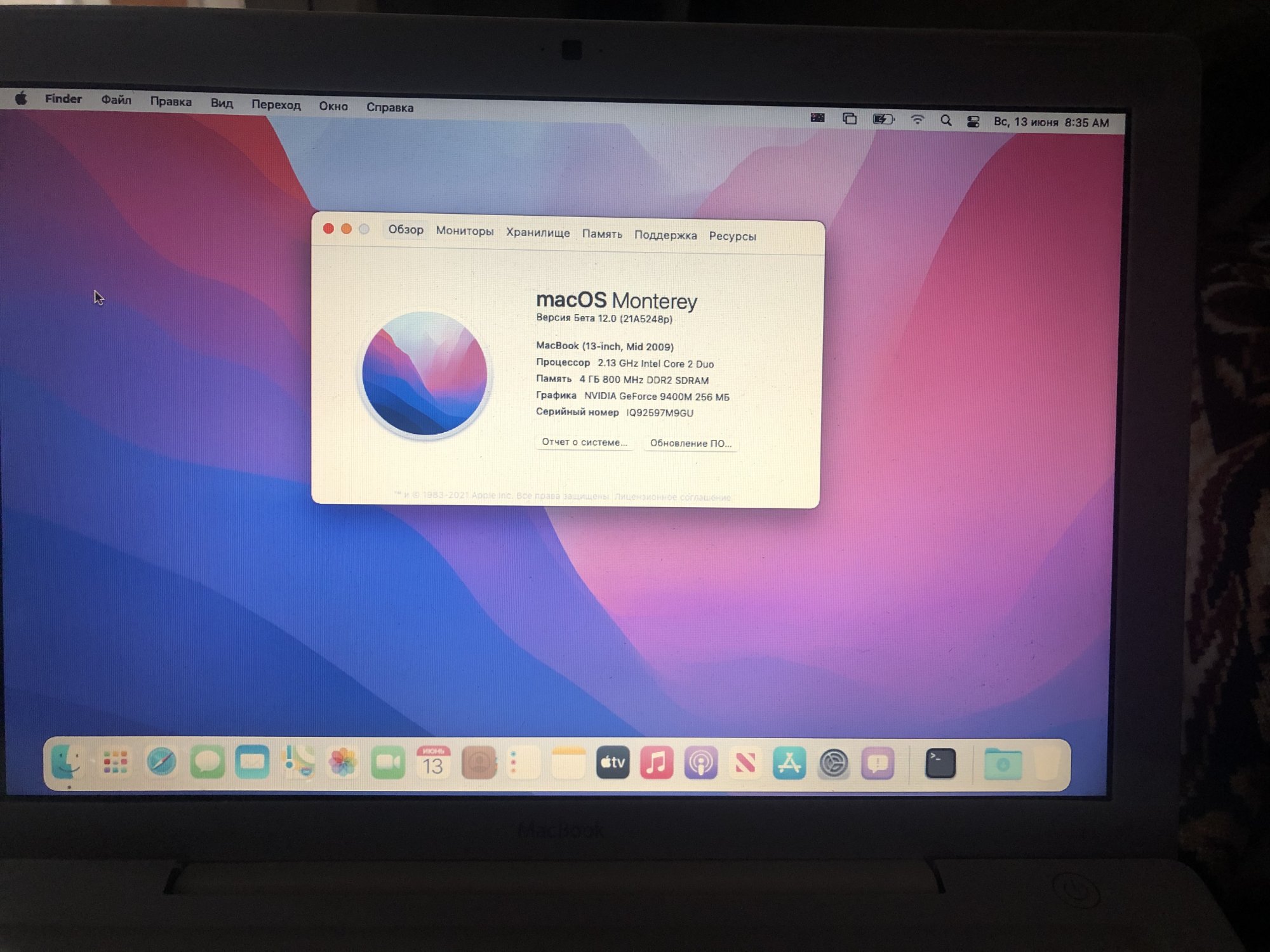

I'm here to try using Nvidia GT320M with QE/CI on MonteRey

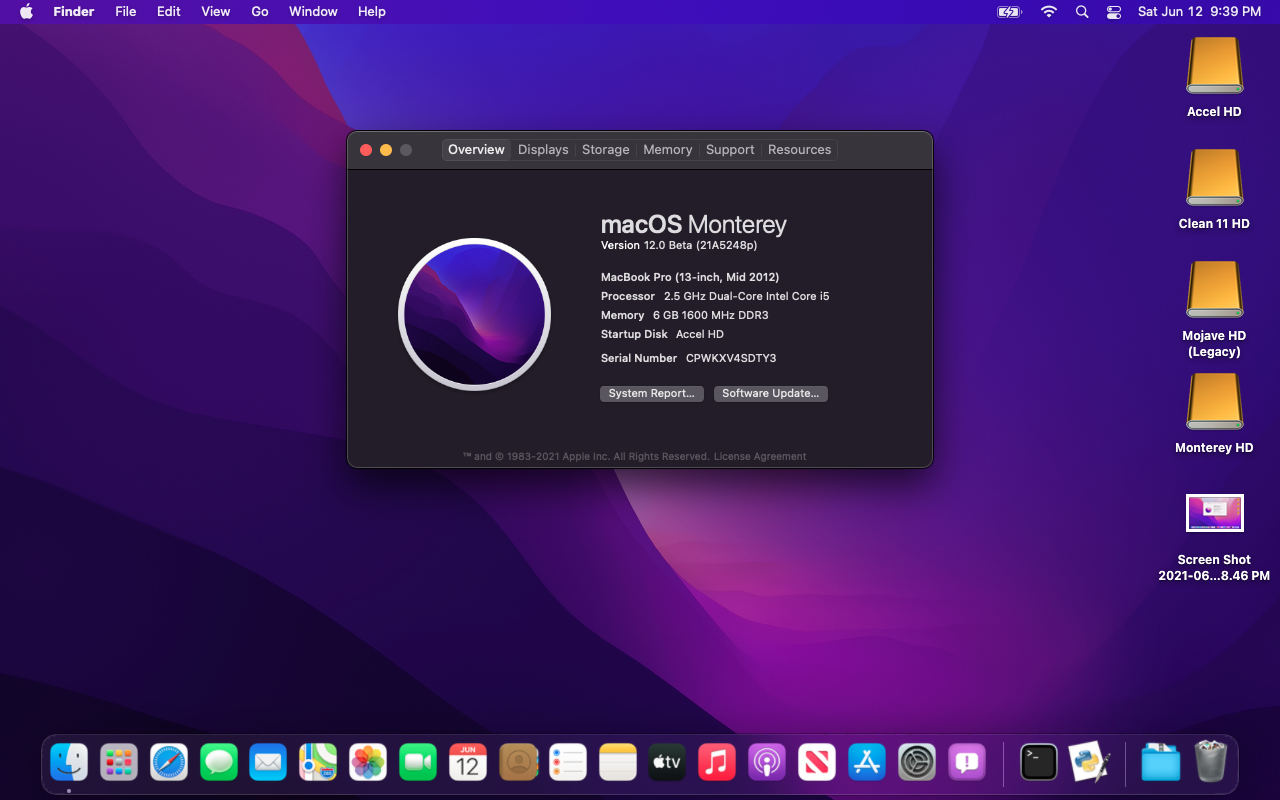

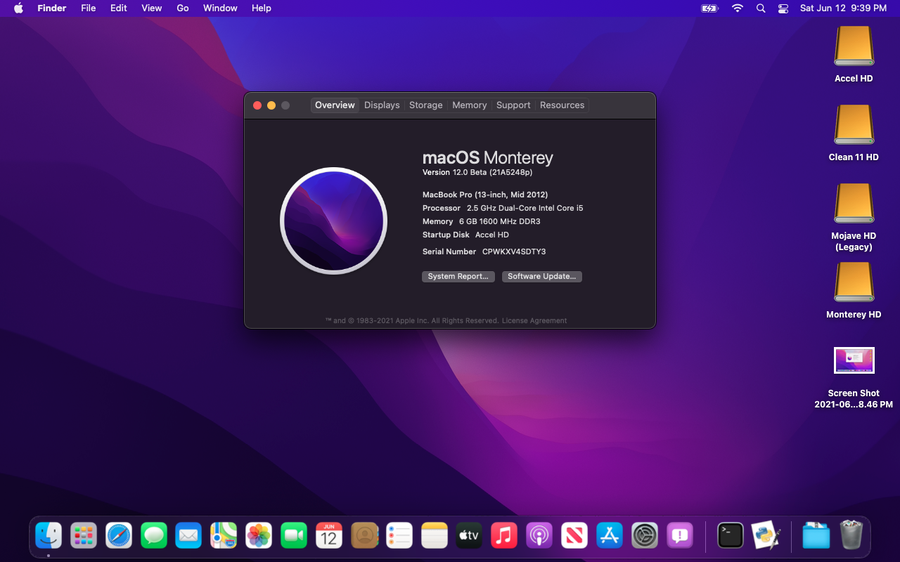

1. Start OCLP 0.1.7.
2. Choose "Create OpenCore configuration" option.
3. Choose "Copy EFI on Internal disk".
4. Restart your Mac.
5. Start "Software Update" in System Preferences.
6. Choose "Install MacOS 12 beta".
7. Profit 😉

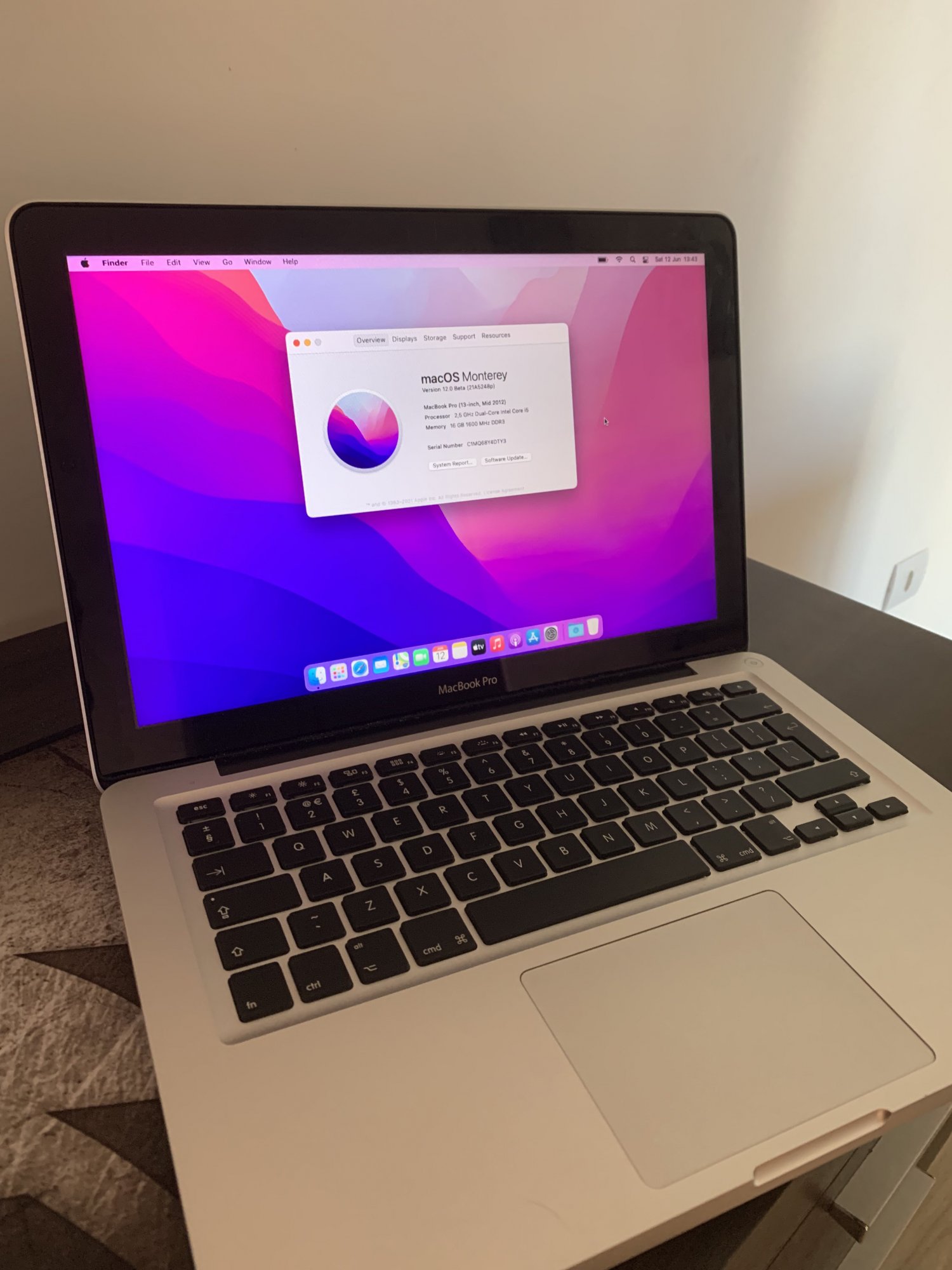

Here is another test on MacBookPro6,2 dualnonmetalGPUs in booting Monterey, without acceleration of course and without Wifi , this is made possible again thanks to @ASentientBot who found the workaround to set "auto login", because the multiuser loginwindow crash without Metal, but applying this is not so simple because you need to complete the apple setup assistant that is very slow, then after the login loop, remove the .AppleSetupDone then reboot to setup assistant from there using a keyboard shortcut key (discussed on discord) to change the login options (setting a blank password won't work properly), more easier if you can boot from a Metal Mac and set the admin user with "auto login".
I am trying to make some LaunchAgents plist to automatically open Accounts.prefpane on setup but it's not easy.
For network ethernet fix using the Catalina AppleBCM5701Ethernet.kext worked as BigSur.
Third party USB Bluetooth CSR still work with stock Monterey drivers.
HighSierra AppleHDA still fix sound and mic (the new siri works), generic IntelHDGraphics kext (without GLdriver) and ASentientBot Nvidia ResmanTesla fixes (without GLDriver) also fixed framebuffer, brightness control and dualGPU switching.

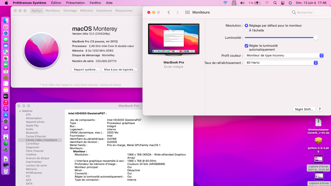

With some impressive finding from @jackluke, we were able to get HD 4000 acceleration in macOS Monterey on our Discord with EduCovas! We will be pushing these changes to OpenCore Legacy Patcher shortly:
Wow...WOW.
This is amazing, so there was/is hope for the HD4000 Graphics.

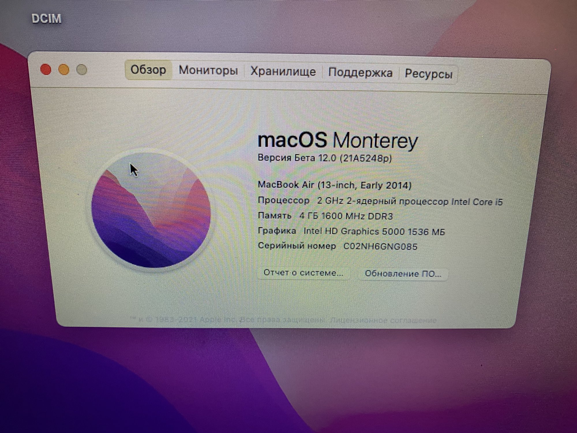

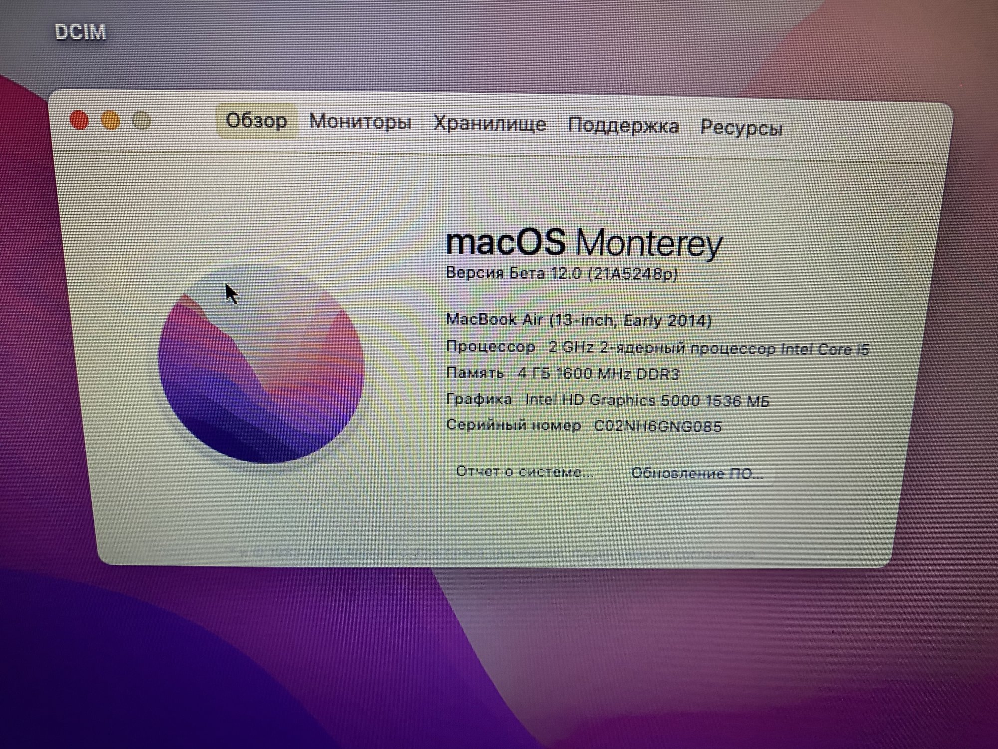

Hello everyone. installed the beta version on my old macbook:apple:🙂🙂

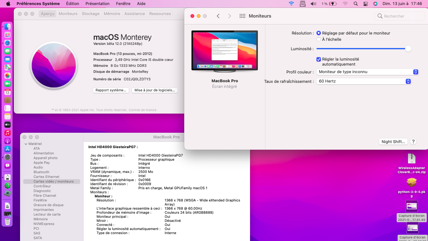

Did more tests with HD 4000, we can comfortably say that HD 4000 support is doing great on my personal MacBookPro9,2. Will note, Delta updates will unfortunately break the moment you root patch the system. Additionally FileVault and SIP will be unsupported however all other features should work wonderfully like WPA Network support, OTA updates, etc
OpenCore Legacy Patcher has been updated to set these patches however we recommend users wait till official release of v0.1.7 to mess with out patch set.
Additionally while we will not provide support for non-OpenCore Legacy Patcher setups, our root volume patch have no requirements of OCLP and therefore could be run on either a Micropatched Mac or a Hackintosh. Note you must ensure SIP is properly disabled. For HD 4000 patching in Monterey, we check the follow csr-active-config (SIP) bits are flipped:
