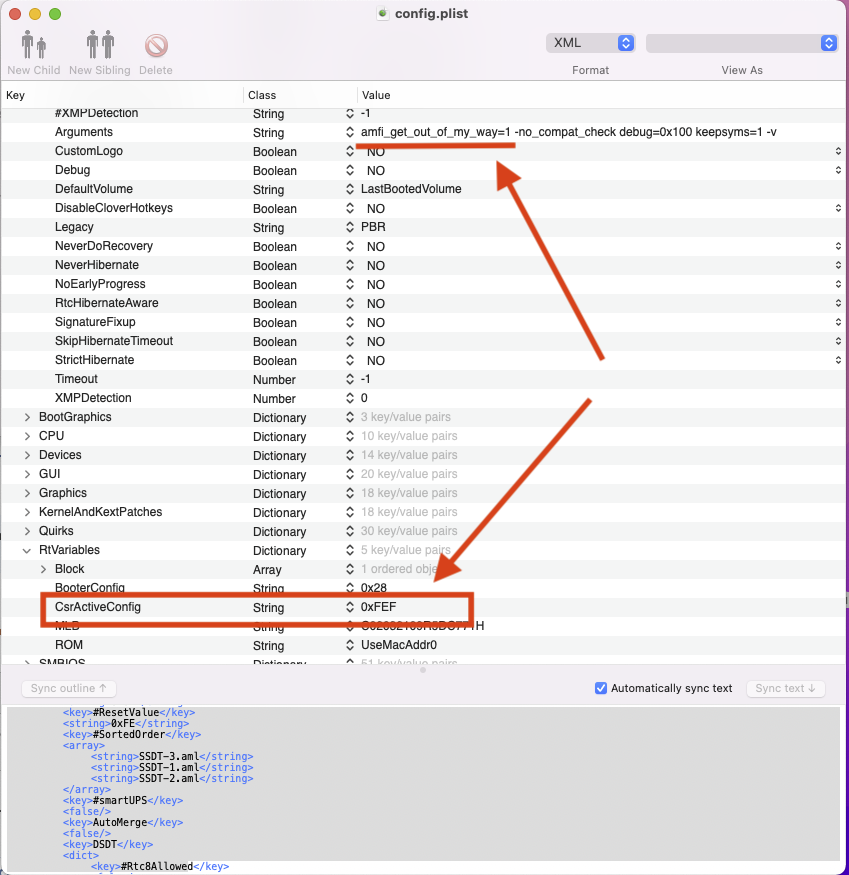

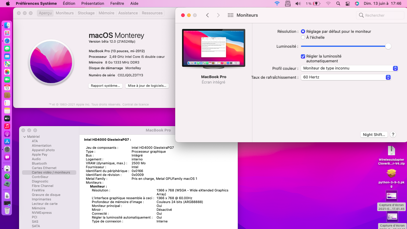

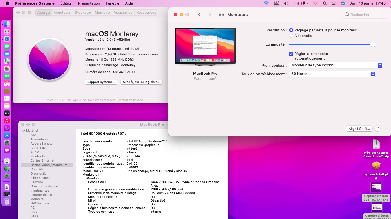

@chris1111
this one is a Dell Vostro 2520
with an i5-3210M
intel HD4000
Clover boot
Patch kext video OpenCore Legacy Patcher
Audio AppleHDA,kext modified by Mirone and installed via BigSurMountSRW (Thanks JakeLuke)
direct functional without modified kernel

@chris1111
with an i5-3210M
intel HD4000
Clover boot

@chris1111
with an i5-3210M
intel HD4000
Clover boot

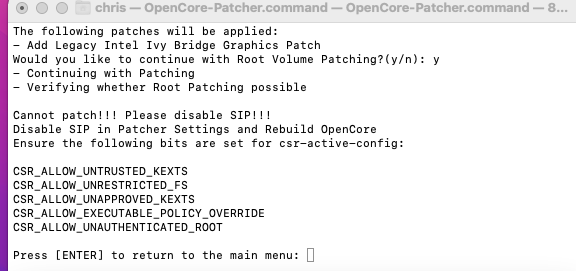

how does it run? did u have ti disable auto login?
see my picture from Monterey trying OCL patcher multiple try and same message, SIP is not disable but in reality is Fully disable see picture
I don't need to see pictures that you have succeeded to solve my problem
config.plist -> ARGS -> "amfi_get_out_of_my_way=1" (Clover & OpenCore) + "-no_compat_check"
CsrActiveConfig -> 0xFEF
SMBIOS -> MacBookPro9,1 / MacBookPro9,2 (Install SMBIOS MacBookPro12,1)
Patch kext = OpenCore Legacy Patcher V 0.1.7 Last commit
mandatory Ethernet
Thanks @JakeLuke + Team OCLP
OPLP = https://forums.macrumors.com/thread...unsupported-macs-thread.2299557/post-29991838
