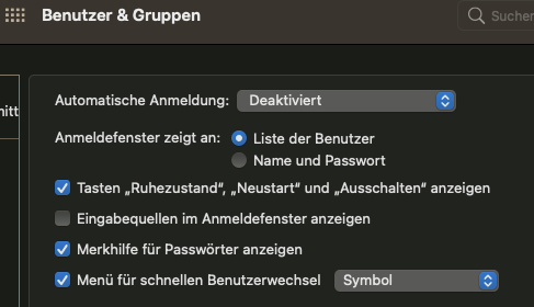

I read the post but i don’t understand how make the autologin of monterey, i have another partition with Catalina, maybe from there i can try to modify the files of Monterey?
The trick is to make the system assume setup isn't done yet, by deleting the file
/<your Monterey volume>/private/var/db/.AppleSetupDone
(these hidden files are shown in Finder windows with SHIFT-CMD-.).
On next reboot it will enter setup again; slow unfortunately on machines without graphics acceleration.
When logged in as a (new) admin user, under system preferences / accounts, activate auto-login for your preferred user. Then on subsequent boots it should proceed right to this user's desktop.
//private/var/db/.AppleSetupDone
Thanks, this work, now with your and others help i’ve a mac mini 2012 full working with wifi and bluetooth.
