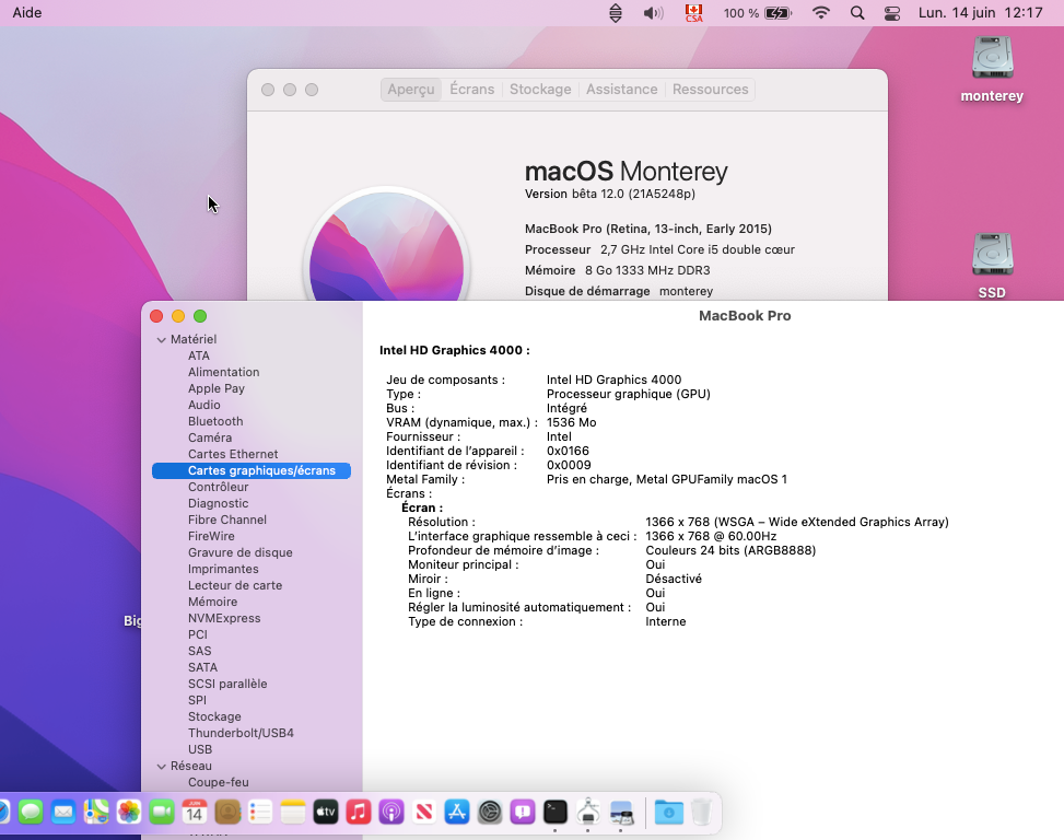

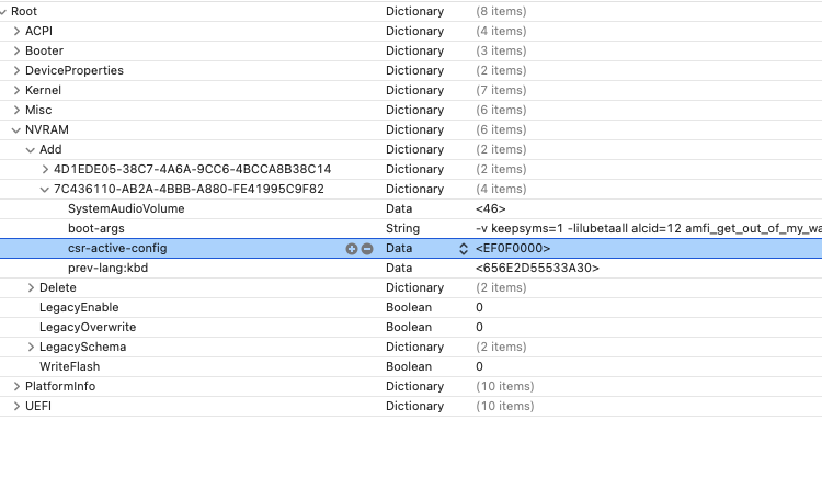

see my picture from Monterey trying OCL patcher multiple try and same message, SIP is not disable but in reality is Fully disable see picture

Big Sur has extended SIP bits split into 2 sections. Specifically csrutil disable and csrutil authenticated-root disable. OpenCore Patcher correctly shows you which bits you need to set including authenticated-root

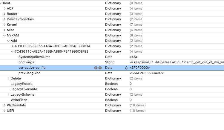

show me please a correct config setting because I have this and that's the result in my previous post

EF0F0000(or 0xFEF) would be correct, ensure the variable is correctly applied by resetting NVRAM so OpenCore will repopulate csr-active-config with the updated value
Good thanks probably forget to reset NVRAM I will try then report

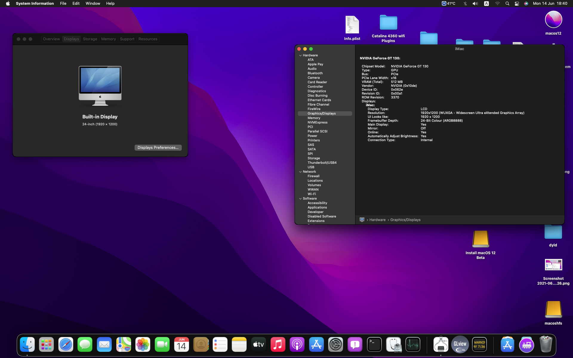

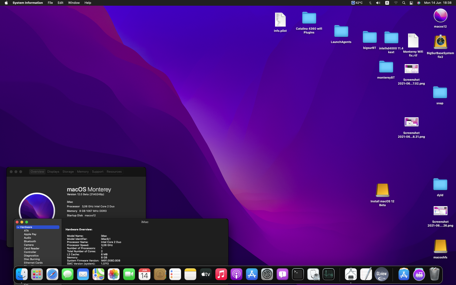

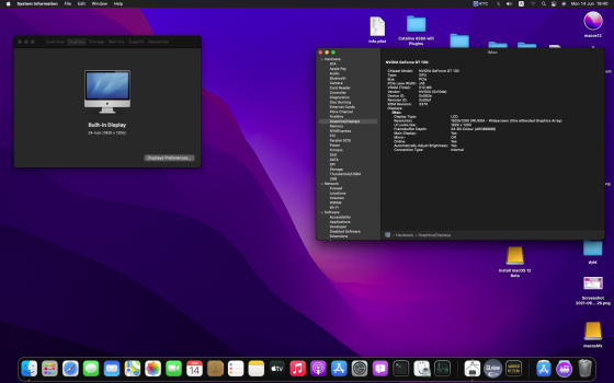

I just made another test non metal Monterey, it's an iMac9,1 , of course no graphics acceleration, no wifi and no bluetooth, so nothing new, but for many already know, this is a legacy USB non APFS Mac, booting an external USB legacy root device, I know and tested OC and OCLP for booting legacy USB machines, but in this case I used an OC setup with apfs driver and without patches, instead I applied my previous BigSurFixes legacy USB patches to this Monterey and they worked.
From picture can notice that brightness control doesn't work even if are installed the ASentientBot Nvidia Tesla framebuffer fixes (also nvenet.kext works for ethernet), probably because this is a legacy monitorpanel, also webcam doesn't turn on the green led (I guess linked to graphics patches or IOHID).
For legacy USB patches (that I made on BigSurFixes) thanks to:
@parrotgeek1 (LegacyUSBInjector.kext) , @Syncretic (for pointing where merge the legacy USB properties) and @ASentientBot (IOHIDFamily to avoid booting through CMD+S and exit).

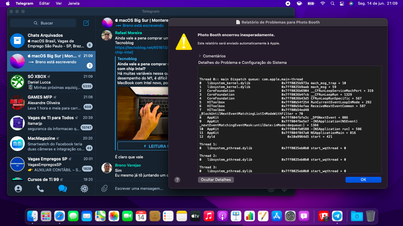

Running macOS Monterey thanks to OpenCore Patcher Legacy.
Thanks guys, You are awesome.
I noticed that maybe we will have to bring more parts of Big Sur Kexts to Monterey
Mainly things that use graphics, like PhotoBooth.
