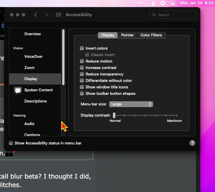

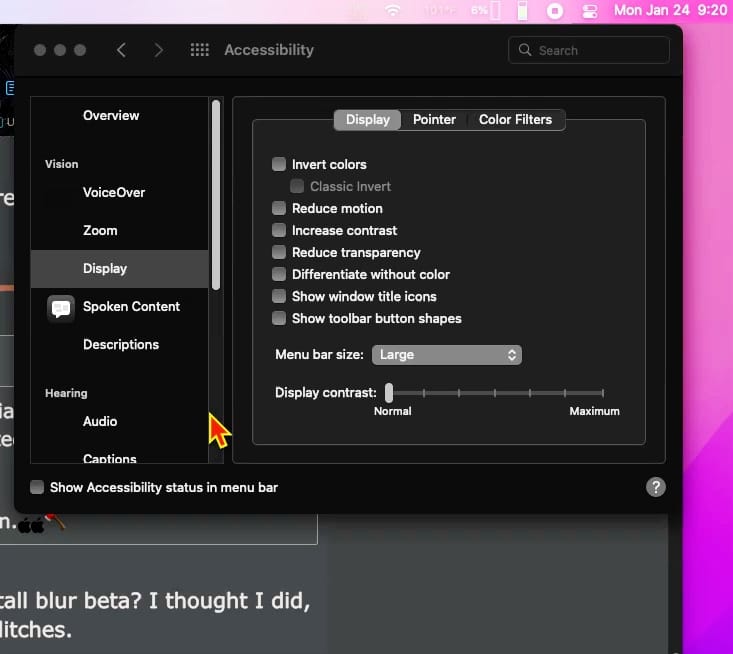

I have the same Mini. Did you install blur beta? I thought I did, but I still get the same graphics glitches.
No, what graphics glitches? 🤷‍♂️

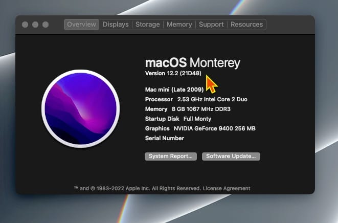

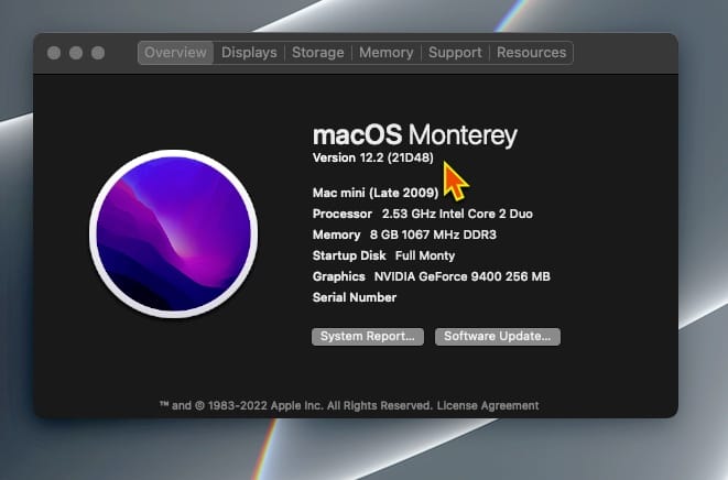

The current 12.2 is a Release Candidate(RC). Build 21D48 :cool:
New product in asset audience(s)!
macOS122RC: macOS Monterey 12.2
Version 12.2 added January 19, 2022 6:00 PM
Additional:
During 12.0b6 this script was run but not since.🤷‍♂️
Code:
defaults write -g ASB_BlurBeta -bool true
I figured it out soon after I posted (but lost my internet connection for awhile). I just ran the GUI version, selected Beta Blur, logged out and back in, and all is good now :)
