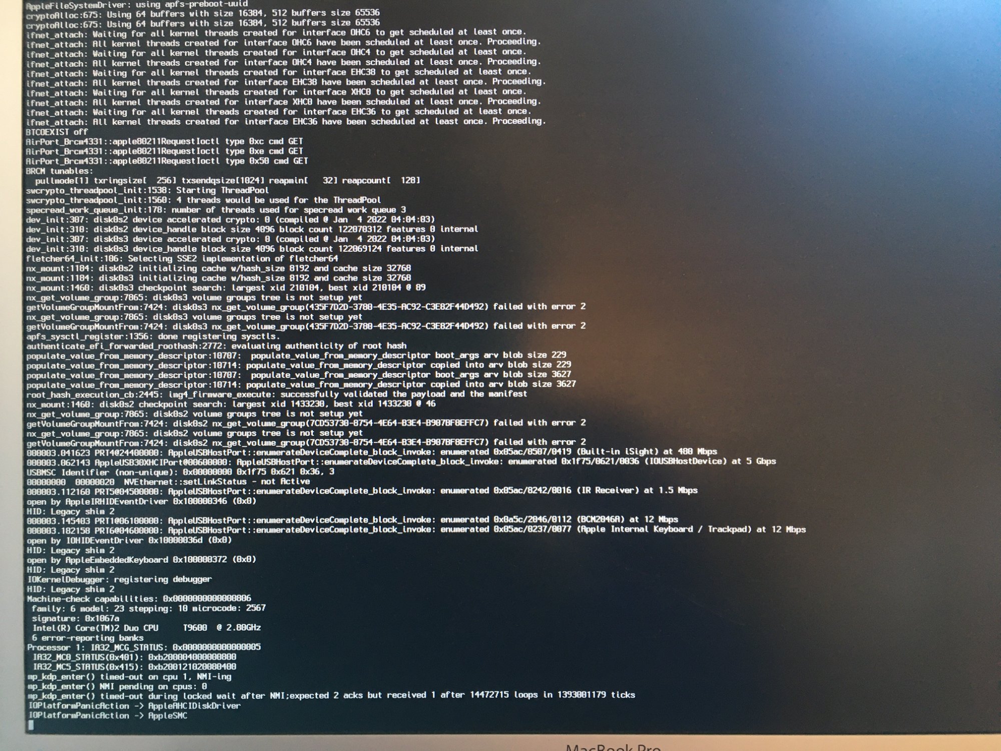

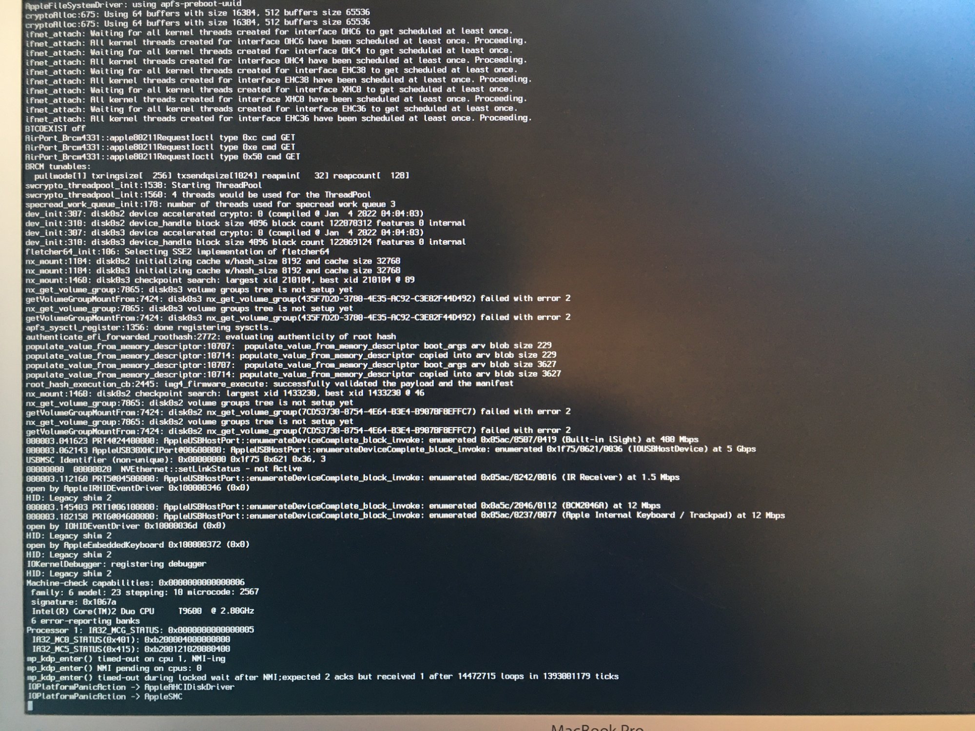

The new OCLP 0.4.1 provides support for booting from USB3. And it works well in BigSur which is very useful, see post https://forums.macrumors.com/thread...unsupported-macs-thread.2242172/post-30795183 .
An SSD with Monterey, connected via USB3, is correctly seen by OCLP, but then booting fails - has to fail, because it fails the same way when the SSD is on an on-board USB port and any USB storage medium (a memory stick e.g.) is connected to USB3. - A keyboard or mouse connected to USB3 work fine.
Attached is a verbose boot output which points to a missing NMI.
That is not a new problem for me. It happens with 12.0.1, 12.1, 12.2 betas, 12.2 RC. Tried with various OCLP versions. Feeding in some auxiliary power doesn't help. - It always works with 11.x.y.
Could be due to my specific nanoTECH card still. I know it works in Monterey for @macinfo, see post #3364.
If anyone else with a nanoTECH USB3 board (or similar with the FL1100 chipset) could confirm one way or the other, that would be great. If others see the problem as well I would follow up for a potential patch. A working USB3 will be even more useful now with 0.4.1’s booting capability.

About a USB3 expresscard (nanoTECH) again after a while.

I looked at it end-to-end (hardwarewise), ie SSD connected to USB3 on pcie, to macOS user interface working with that disk. It works when BigSur is on the disk, fails with Monterey on the disk.
I forgot to mention: when running Monterey, booted from an on-board USB or SATA, and then plugging any memory device into USB3 on pcie, macOS freezes after ~20sec. Hard for me to diagnose at this point, but it could well be a missing interrupt. And as I said, USB3 works fine with a mouse or keyboard connected to it. Should be something around the Monterey disk driver for XHCI. Or my card (unlikely as it works with BigSur).
