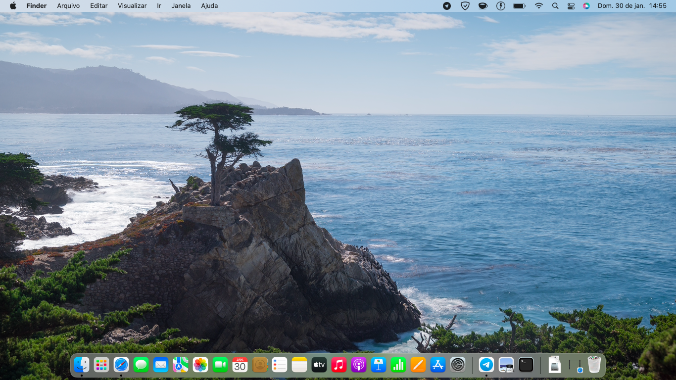

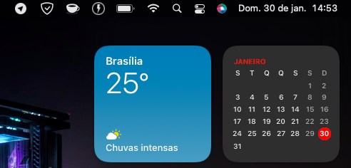

Fixed after update to 12.3 beta
Working perfect
Intel HD Graphics 4000

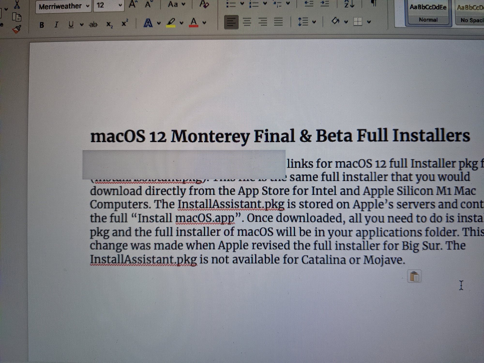

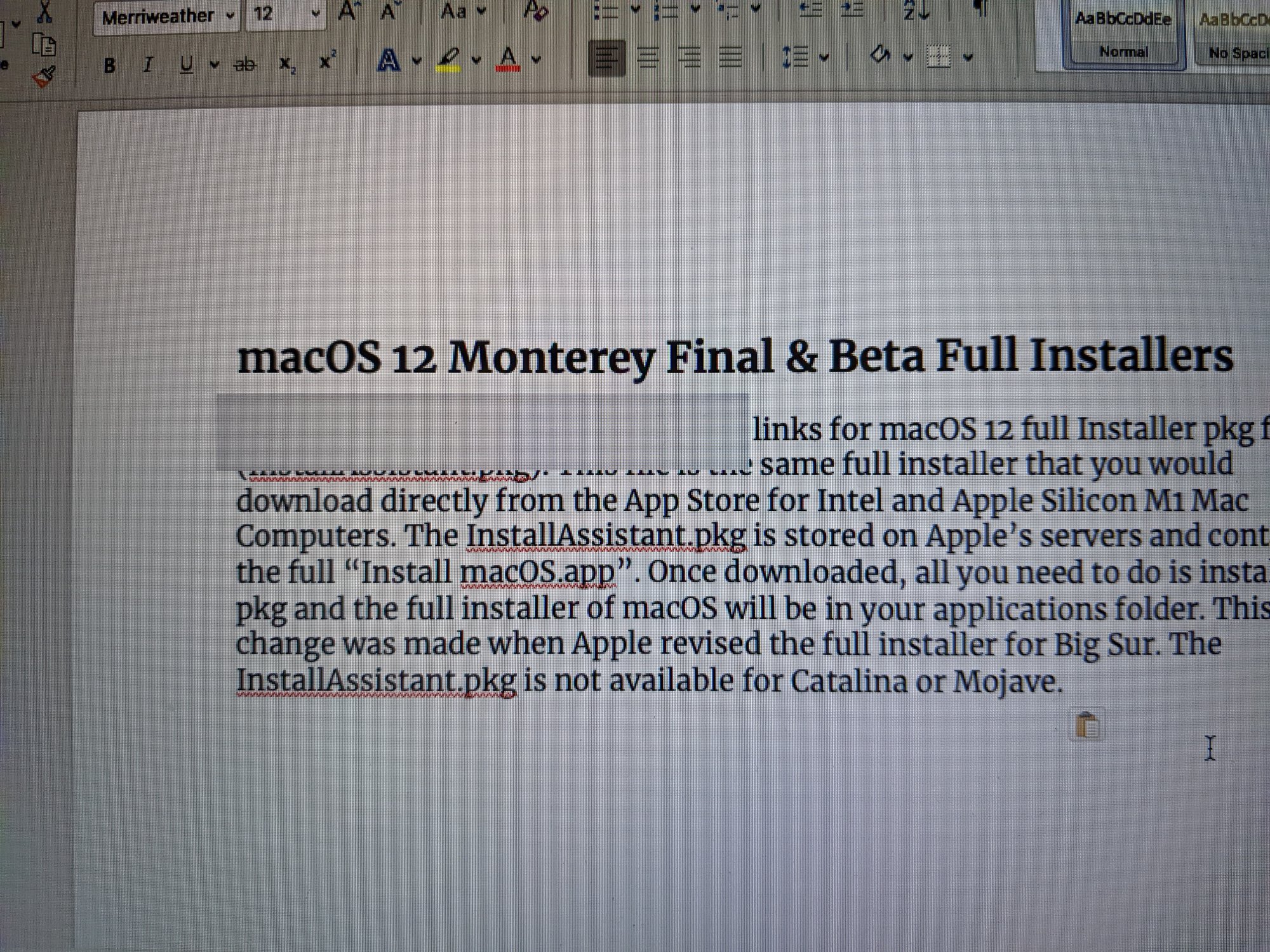

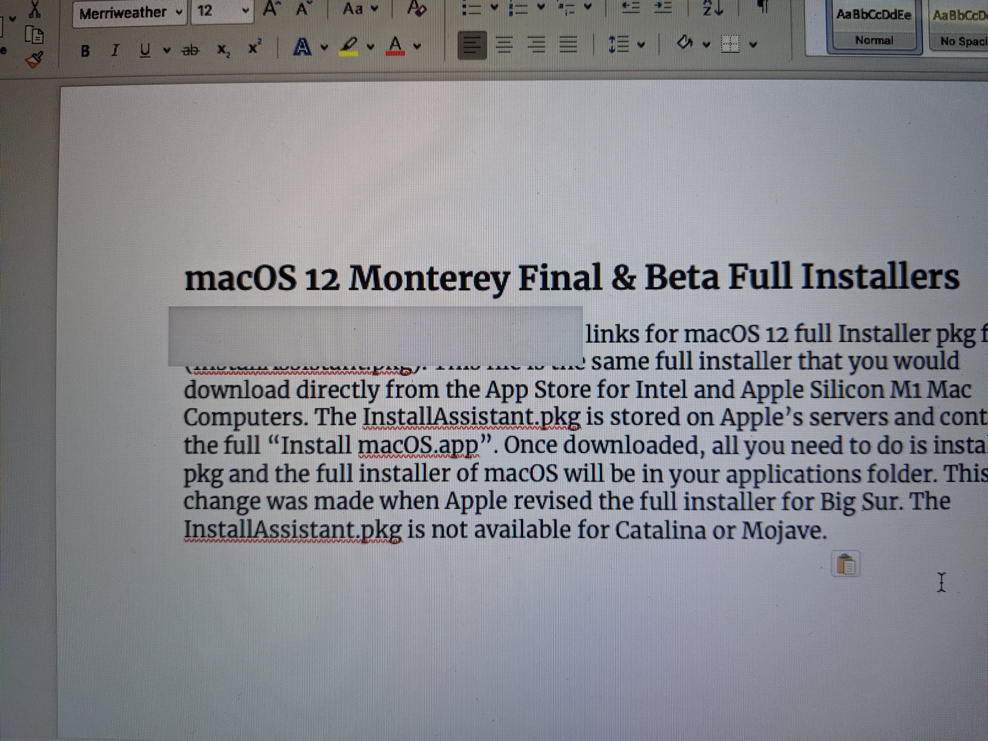

I have a highlight problem in Word under Monterey 12.2. Any one knows the solution to come back to normal? Thank you so much!​
No real solution. Since not everybody in the non-metal community has seen these gray boxes: Do all your machines act like that? I've tested very much with Big Sur and Monterey on my MBP8,1 and different versions of Word - without success. Then yesterday Jazzzny suggested on Discord to try Word 16.43 (November 2020, I guess). That works for me! But of course it would be great if this issue could be solved at some stage.
EDIT: I testet a bit today. I got as far as 16.49. 16.50 is the first version to produce gray boxes. I know that older versions do that as well. But I won't bother testing when the good times started. I'm satisfied to have found the most recent version that works for the time being.
