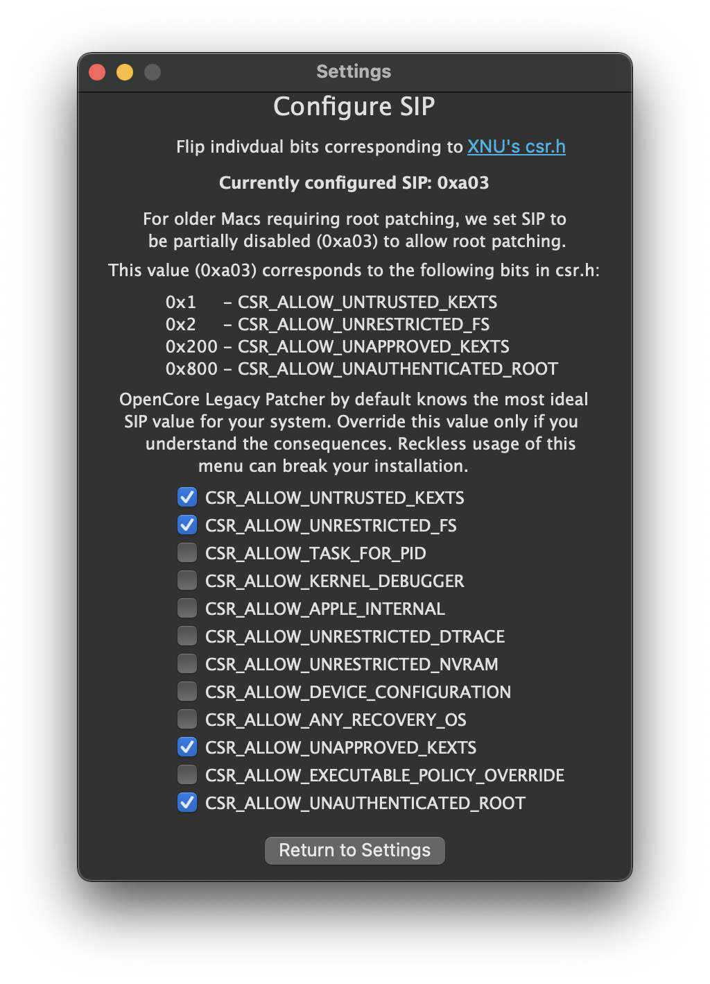

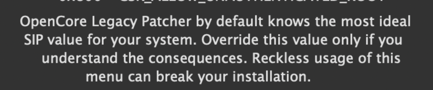

… And when SIP is only partially disabled (or lowered, as required for root patching: see the picture above)…? Does TCC work, in this case, or not? Thanks…
I don’t know? I did an upgrade of Monterey to 12.3 with latest OCLP and apps now prompt for permission to access camera, mic etc... so I would assume yes?

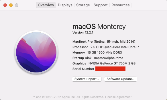

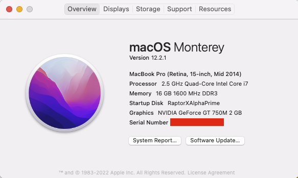

As of this post, I'm currently running Monterey 12.2.1 with OCLP 0.4.3 (Opencore Legacy Patcher) on an external-mounted 2TB Kingston NV1 on my MBP 2014 (11.3).
I've been trying OCLP for the last couple of weekends or so, met with failure at all attempts to get Monterey to install (stuck in startup loop) until I figured out that it was the graphics driver causing the problem. I also screwed up the OCLP install, as such it restarts back into my hard drive (which also has OCLP) in each stage of the install, so I had to restart and force an EFI boot (sounds ominous, but it's just the Option key startup) each time the install goes through a stage. So I see the drive changing name from "untitled" to "Mac OS Install" to the drive name I assigned. That's when I know to force a restart in Safe Mode.
I was able to install 12.2.1 last night, twice, but now, the problem is when migrating Data from my internal drive. Each time, I had to redo the process of installing OCLP and Monterey installer on a USB install drive because it gets screwed up after the failed migrate (which shouldn't have happened if I did not reset the NVRAM/PRAM, but now I know better).
After a relatively quick and successful install (because I already know the cycle) I'm not going to attempt to migrate data from my Internal (1TB Kingston A2000) since it's been causing problems somewhat, at least not right now while testing it. I'm going to have to test Adobe CC as well as my other apps for design and teaching, by signing into my CC account and installing the necessary apps I use for Graphic Design: AI, PS, ID.
I've already set my iCloud account up, which is the easy part, but I would have to manually install Adobe CC. My other settings (web browser and stuff) will have to wait as a I fully test Monterey with the apps I use. I'll install 12.3 later (point update), I think 12.3 still has a few bugs since it just got out of Beta.
But, everything's working, Bluetooth, WIFI, Graphics Acceleration, the Keyboard backlight and Display brightness. and for something running on an External SSD, it's relatively running fast (or, at least when I launch freshly installed CC apps).

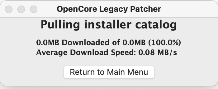

Eather you download the InstallAssistant from page 1 or you can use the terminal:
softwareupdate --list-full-installers
Which gives you a list. For instance to download 12.2.1 (to Applications folder):
softwareupdate --fetch-full-installer 'macOS Monterey 12.2.1-21D62'

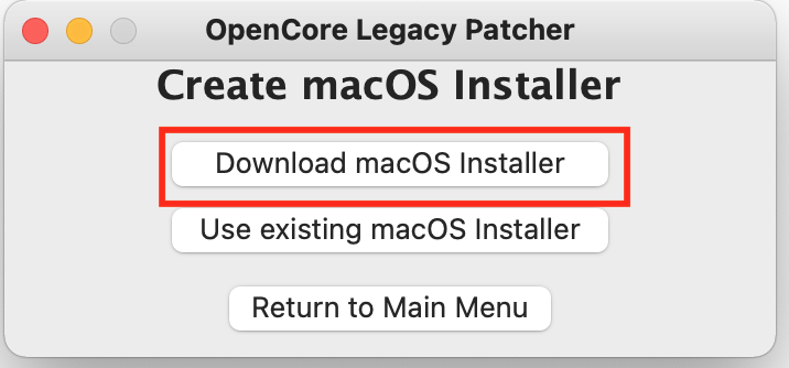

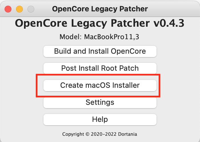

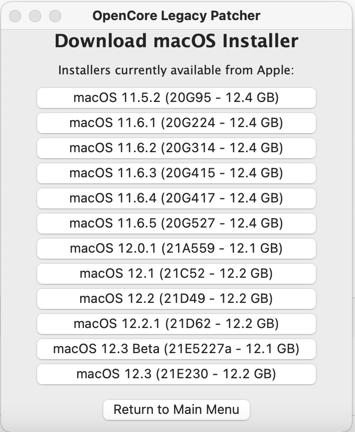

The most recent GUI versions of OCLP (0.4.2 and 0.4.3 offline) already provides a catalog of all the most recent MacOS releases and allows you to create the Installer from within OCLP. No more fussing over installer packages or creating the installer via Terminal, everything is now in OCLP.

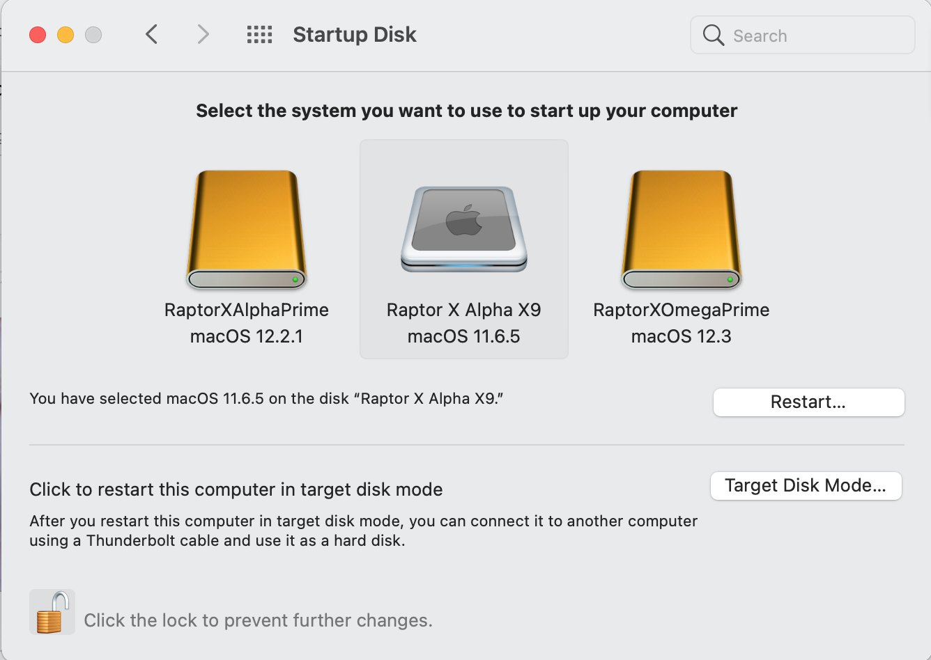

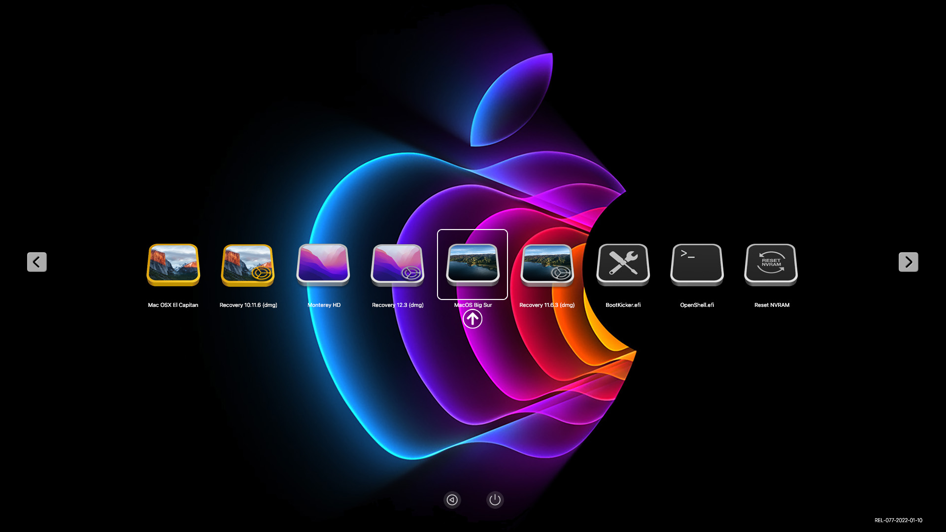

I now have three working startup drives. After AlphaPrime, Omega Prime was <cinch> to install, but I still had to patch post install. Since Omega Prime is a secondary Volume with Alpha Prime, I can simply <delete> it and start over if the Migration get screwed up again. I will still use X9 (A2000) as my main drive later on if everything goes well. The NV1 will remain a test bed for new OS and OCLP Versions, but I might get another A2000 and an enclosure for it.

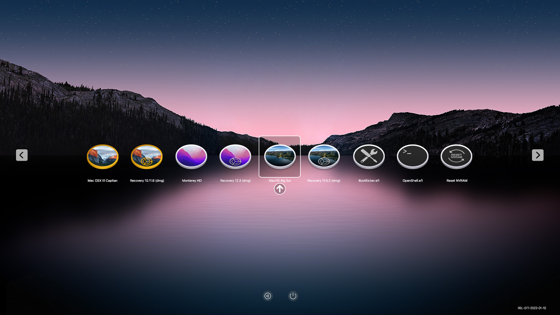

It's not OCLP 0.4.3, but Monterey 12.3. I did mention earlier that 12.3 is still buggy just coming out of Beta.
That's why I installed 12.2.1 on one volume and 12.3 on another so I can test both.

… Hmmm… Sadly, after some more experiments on my late 2013 MacBook Pro 11,3, I discovered that the TCC access prompts only partially work, in a root patched Monterey 12.3: some are indeed present (for example, prompting for access to calendar, photos, etc.), but others are strangely absent, when they should indeed be there; in particular, I installed Parallels Desktop (which on first run prompts for access to the Desktop, Downloads, Documents, etc. folders), both without (NVidia dGPU disabled and SIP fully enabled) and with root patching (dGPU enabled and SIP lowered), on freshly installed 12.3 systems (on external SSD): well, in the latter case, there were no prompts for approving access to those folders, which thus were accessed automatically, without asking. So, in this case, there seems to be an at least partial problem, with TCC not asking for approval to access files and folders (and thus nothing appears as approved in System Preferences: Privacy and Security: Privacy: Files and Folders): could this perhaps have to do with the “allow unrestricted filesystem” flag (see below), which is applied after root patching...? Anyway, it’s a rather serious security lowering, IMHO (YMMV): so, would it be possible to fix this glitch, in some way…?
(… Of course, a simple but not ideal workaround could be to disable the dGPU in NVRAM (with SIP fully enabled): but this would mean no screen brightness controls, which thus would have to be provided also for these more recent MBPs; which, if through kernel extensions, however would again require root patching. So, the ideal solution would probably be to maintain the dGPU enabled with root patching, and make some minor adjustment in order to fully enable TCC: but not sure if this is even possible, however…)
Reactions: macpro_mid2014
… Hmmm… Sadly, after some more experiments on my late 2013 MacBook Pro 11,3, I discovered that the TCC access prompts only partially work, in a root patched Monterey 12.3: some are indeed present (for example, prompting for access to calendar, photos, etc.), but others are strangely absent, when they should indeed be there; in particular, I installed Parallels Desktop (which on first run prompts for access to the Desktop, Downloads, Documents, etc. folders), both without (NVidia dGPU disabled and SIP fully enabled) and with root patching (dGPU enabled and SIP lowered), on freshly installed 12.3 systems (on external SSD): well, in the latter case, there were no prompts for approving access to those folders, which thus were accessed automatically, without asking. So, in this case, there seems to be an at least partial problem, with TCC not asking for approval to access files and folders (and thus nothing appears as approved in System Preferences): could this perhaps have to do with the “allow unrestricted filesystem” flag (see below), which is applied after root patching...? Anyway, a rather serious security lowering, IMHO (YMMV): so, would it be possible to fix this glitch, in some way…?
I wouldn't say it's a glitch, and this part should have clued you in. Just remember, anything that disables SIP in part or in full will always pose a risk to any system.

^^^ Yes, that’s true, of course: I just didn’t expect this to be visible at the user level (see the partially missing TCC prompts)…
