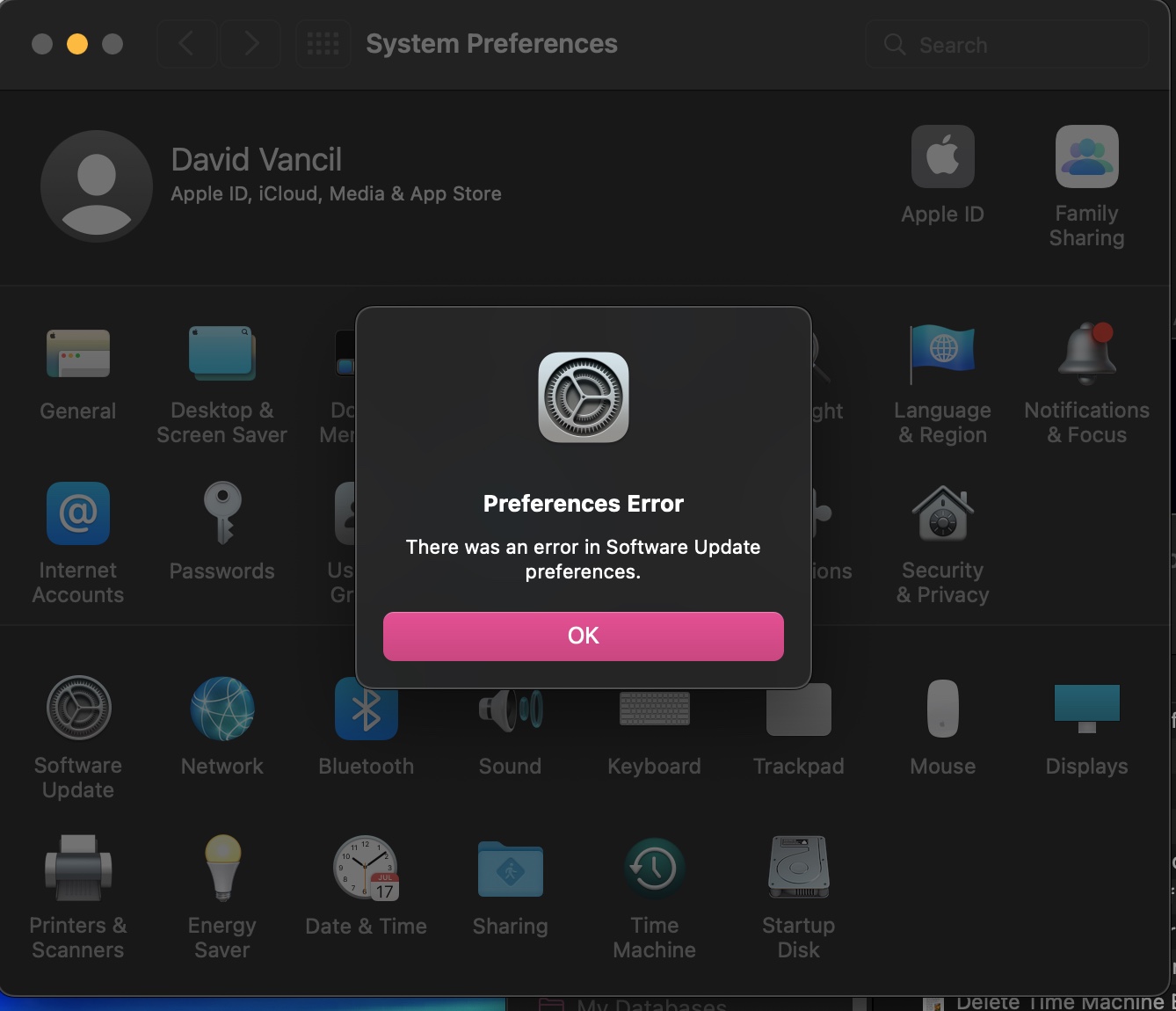

Now that 12.4 beta 4 has been released I tried to get it via the Developer seed program, but got that System Preferences Error message again, and for some reason your Download full Installer app only lists 12.4 beta 3.
Is there a way to get it to show beta 4?
Thanks
If you are on a non metal device you have to unpatch your system with OCLP. Than you will find the 1,9gb b4 with developer account. You can force this: sudo /System/Library/PrivateFrameworks/Seeding.framework/Versions/A/Resources/seedutil enroll DeveloperSeed
Thanks for taking the time and effort to reply, but did you read the whole post? This Mac is a 2014 iMac with a metal-capable GPU, and I did enroll in the DeveloperSeed program. When I tried to use the System Software Update preference pane, it throws a preferences error and does not show or get the b 4 update. That error has been persistent on this machine for years, and if you have any idea about how to correct it, fire away. I assume it is some file, perhaps a bom file somewhere in the receipts folder? that is the cause of that.
I assume that the Mr. Macintosh HP will show the b4 full installer in due time (it is not listed to date, May 4 2022).
I am wondering if the terminal fetch full installer command will work. I might try that later today, but I am not sure about the correct syntax to use:
softwareupdate --fetch-full-installer --full-installer-version 12.4 21F5071b
Does not work, "Update not found."
You can also use GibmacOSmaster script (search Github for it) to DL all (developer) betas. 12.4b4 is listed already, but somehow I get an "invalid install package" error currently. Will be fixed on Apple´s side shortly, I guess.
Thanks for the reply. I tried a search on Github, but, as usual, while that search does show the script, it is not obvious how to download it. Maybe it is just me, but I hate looking through a ton of text for a download link. Gave up on that.
Updated today, the Mr. Macintosh page has the Monterey 12.4 b4 download listed, as well as a Big Sur 11.6.6 RC b4 available.
Just to remind, it appears that Beta 4 has a build number of 21F5071b, as that's the latest version I was able to update to yesterday (I know it was posted last page.)
