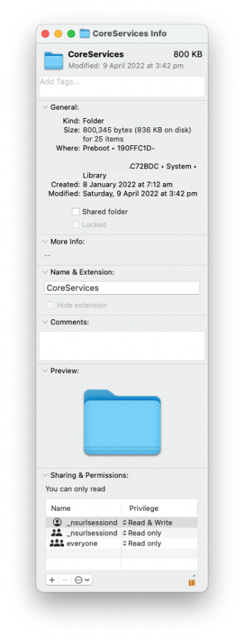

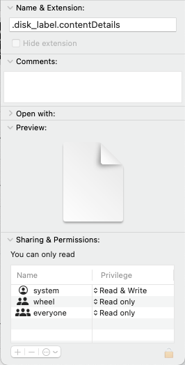

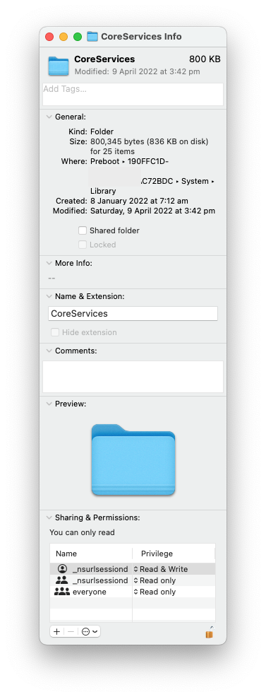

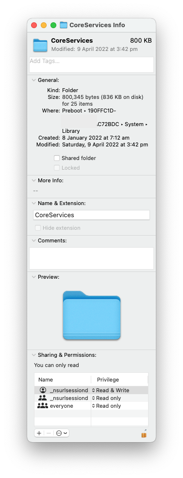

Hi joevt, Thank you so much for the info. I successfully changed name for my iMac12,2 (K3100M) with your instructions. The last 2 commands did the trick if I did not change the PickerAttribute in OCLP config.plist from 145 to 147. But the .disk_* files in my other 2 iMacs (M5100) can't be changed/deleted due to permission issue. I've noticed that all the folders under Preload for these 2 iMacs have the _nsurlsessiond Name instead of system and wheel. Not sure if this is the cause and what I need to do to get it working?
Note: permissions for all .disk_* files seems normal.
Solution: The permission issue has been resolved by ticking the "CSR_ALLOW_UNRESTRICTED_FS" in <SIP Settings> before <Build and Install OpenCore> in OCLP. You can untick this flag after the change of the label.

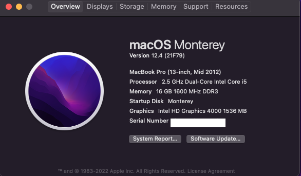

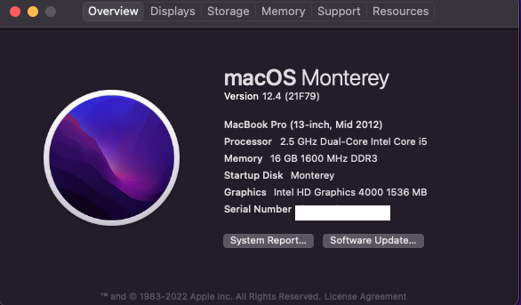

Monterey 12.4 (21F79) OCLP 0.4.5 no issues.

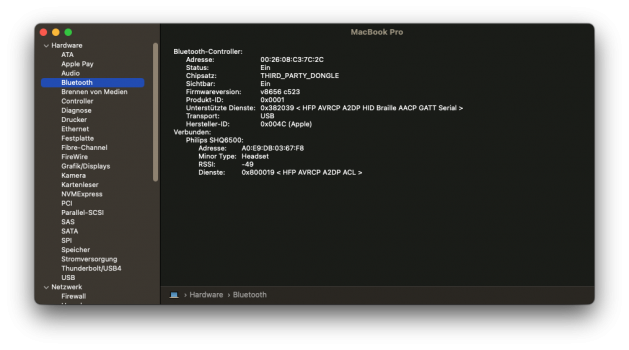

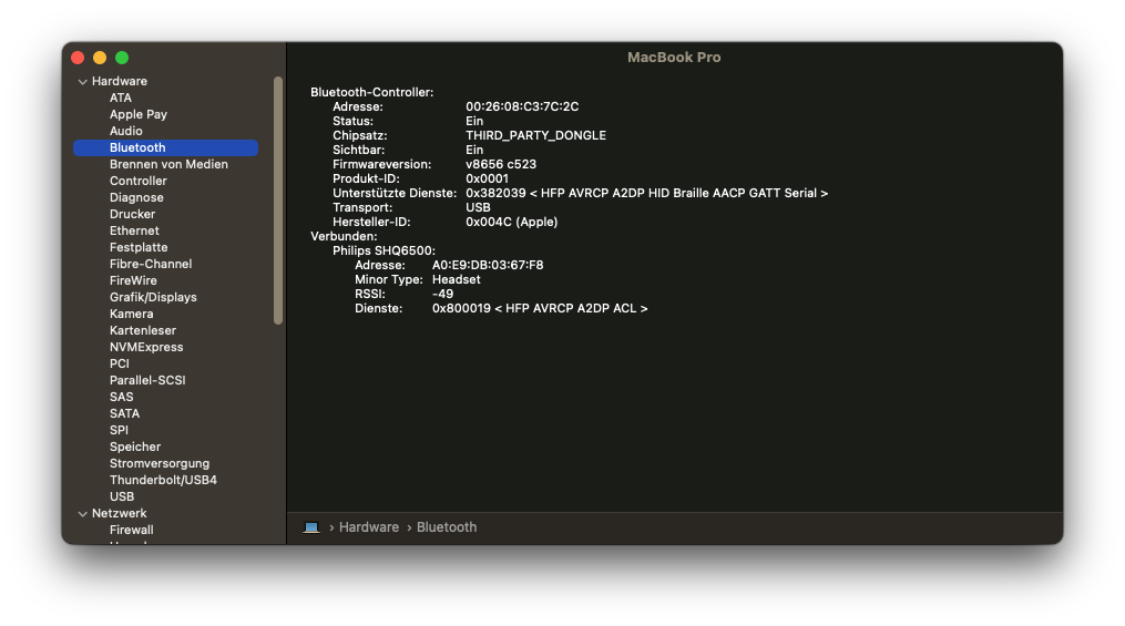

Same positive result here on MBP5,2 (17" Mid 2009). Today's OCLP 0.4.5n.
Just to mention that Wifi and Bluetooth work fine as before.
The machine isn't used in any fancy way. Xcode for C++, Python, and listening to Hotel California is about all I want.
It still does this very well. Thanks to the OCLP and non-Metal developers!!

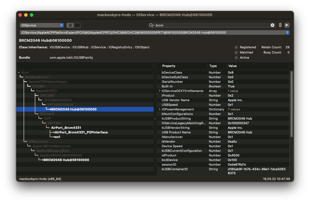

Hi, I'm using MacOS 12.3.1 with OLCP 0.4.4 on a MBP2010 6,2.
My question is regarding this issue, which is already mentioned on the OCLP website:
# Cannot press "Done" when editing a Sidebar Widget
Workaround: Press some combination of Tab, or Tab and then Shift-Tab, or just Shift-Tab until the "Done" button is highlighted. Then press spacebar to activate the button, the same as in any other dialog with a highlighted button halo.
I can't mange to get the Done-button highlighted, regardless of hitting several Tab-combinations!
Is this method working for anyone?
If yes, are there any tricks?
If no, are there any other other workarounds? I'd like to see e.g. the weather at my current position, not a pre-selected city 😉
Thanks!
