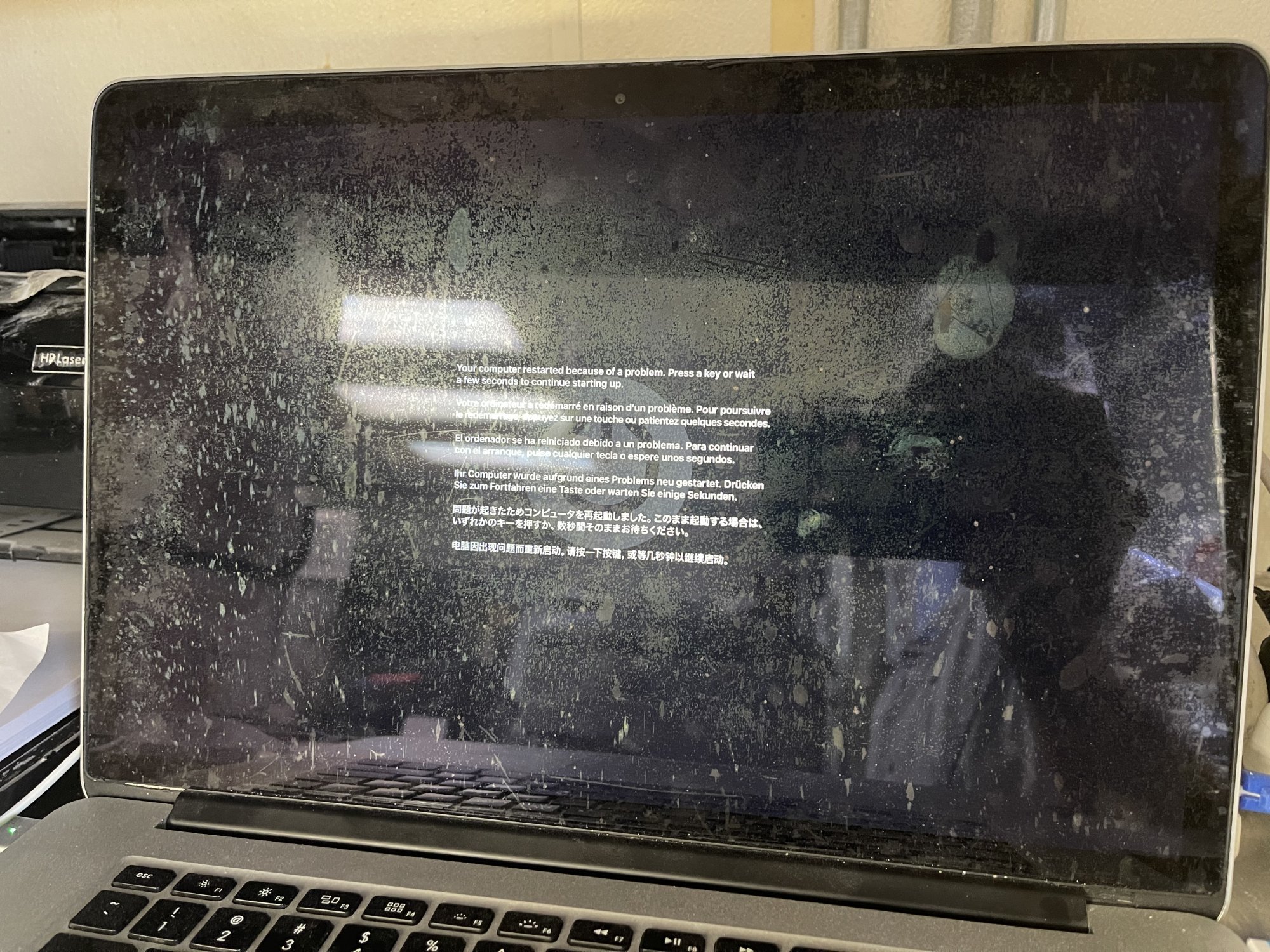

Good Morning, I tried to install the last RC on a 11.3, it worked good until beta 3 but now something happened, is not booting the right way and keeps saying The mac has been rebooted for an error.
I partially fixed following the command found on page 111 modifing the nvram, but again after the intruducuion screen is rebooting itself again.
Pathed with OPCL 0.4.5
Please do not let us guess and search which 11,3 you are writing about. I own an iMac11,3 running just perfectly with 12.4.
The update of an MacBookPro11,3 will always follow the same complex (safe mode boot and patch) approach unless you are doing a fresh new installation using OCLP 0.4.4 and later using the auto patching. In case you messed it up just install again on top of the existing one. This approach will preserve your own data.
(just in case you can edit your own posts please try to avoid single line and single word posts, this is no chat tool)
I can not get to safe mode... this problem is starting from a fresh install too...when i upgraded from beta 3 I had a server error and so i decided to backup my data with time machine and do a fresh start. 11.3 is a Macbook pro retina mid 2012 . Before Rc everything worked fine with ota updates.

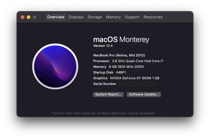

rMBP mid 2012 with original BT + wireless card very smooth update from production releases 12.3.1 to 12.4 (21F79).
As expected had to rerun OCLP 4.4 TUI option 3 Post install volume patch to get out of "tiny everything land" and my external monitor back.
MacBookPro11,3 is from late 2013 and mid-2014 (https://everymac.com/ultimate-mac-lookup/?search_keywords=MacBookPro11,3). The 2012 retina Macbook Pros are MacBookPro10,1 and MacBookPro10,2 (https://everymac.com/ultimate-mac-lookup/?search_keywords=MacBookPro10,1 and https://everymac.com/ultimate-mac-lookup/?search_keywords=MacBookPro10,2). So therefore ppl still cannot tell which machine. (Is it really 2012 and you got the model wrong? Is it really that model and you got the year wrong?)

Keeps rebooting like.that after restoring
From time machine backup....booting in safe mode.is freezing and again rebooting itself
