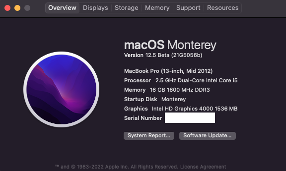

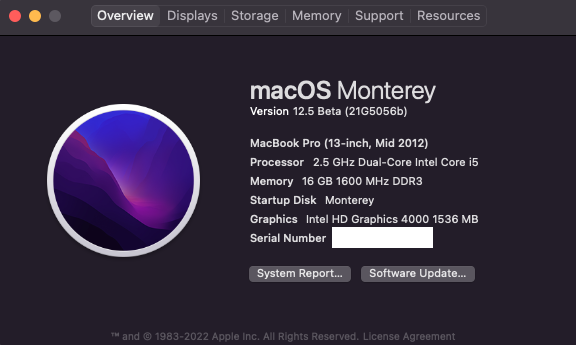

smooth upgrade to beta4 OCLP 0.48 no issues.

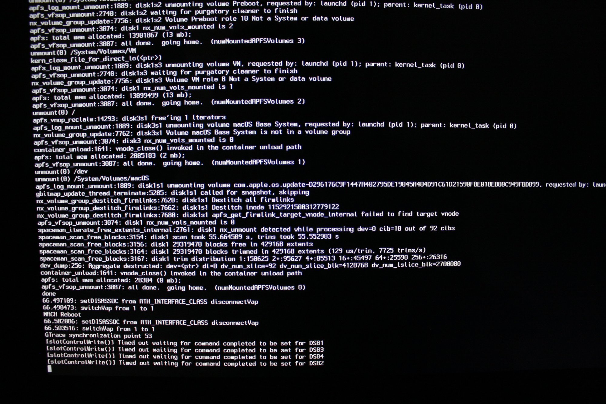

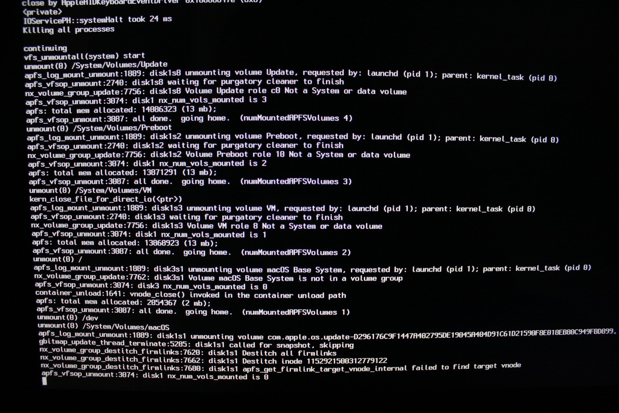

I'm having issues booting Monterey 12.4 on iMac 12,1 with k2100m GPU upgrade using OCLP 0.4.7.
I have Big Sur running perfectly on this machine. I installed Monterey onto a second volume on the same internal drive. Installation goes smoothly, but then when trying to boot it reboots halfway into macOS Recovery.
I tried enabling verbose mode in OCLP but the messages fly by so fast I can't see what they say just before it reboots. It doesn't hang on any message, it just suddenly reboots before I can see what happened.
I tried searching the thread but don't know what words to find if anyone has had this. Can anyone point me in the right direction?
Wondering if maybe I had a corrupted installer.

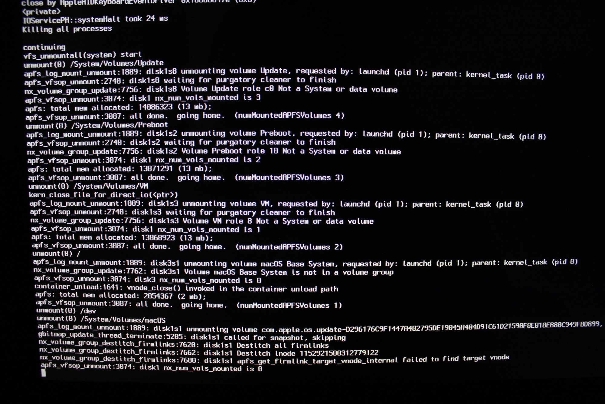

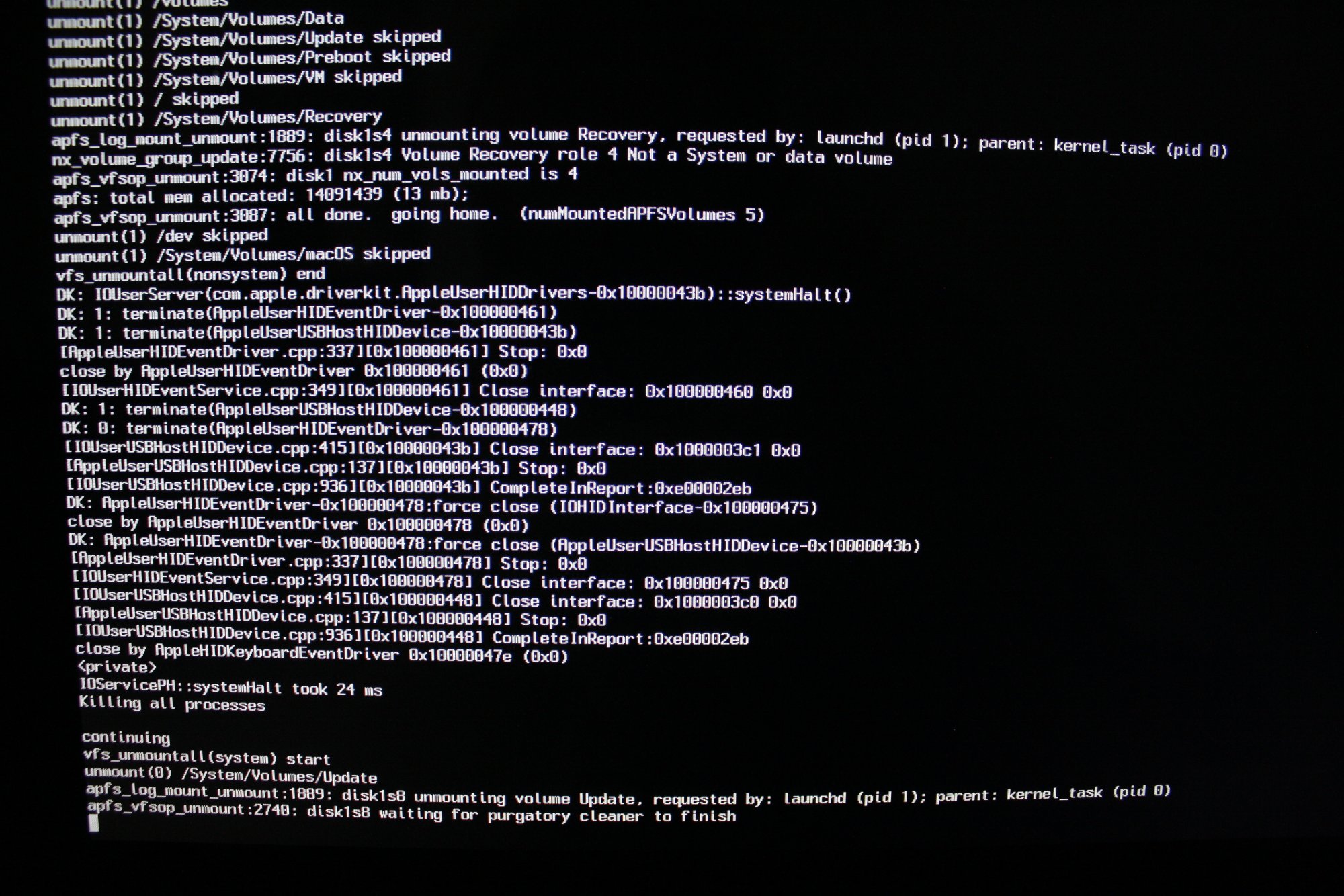

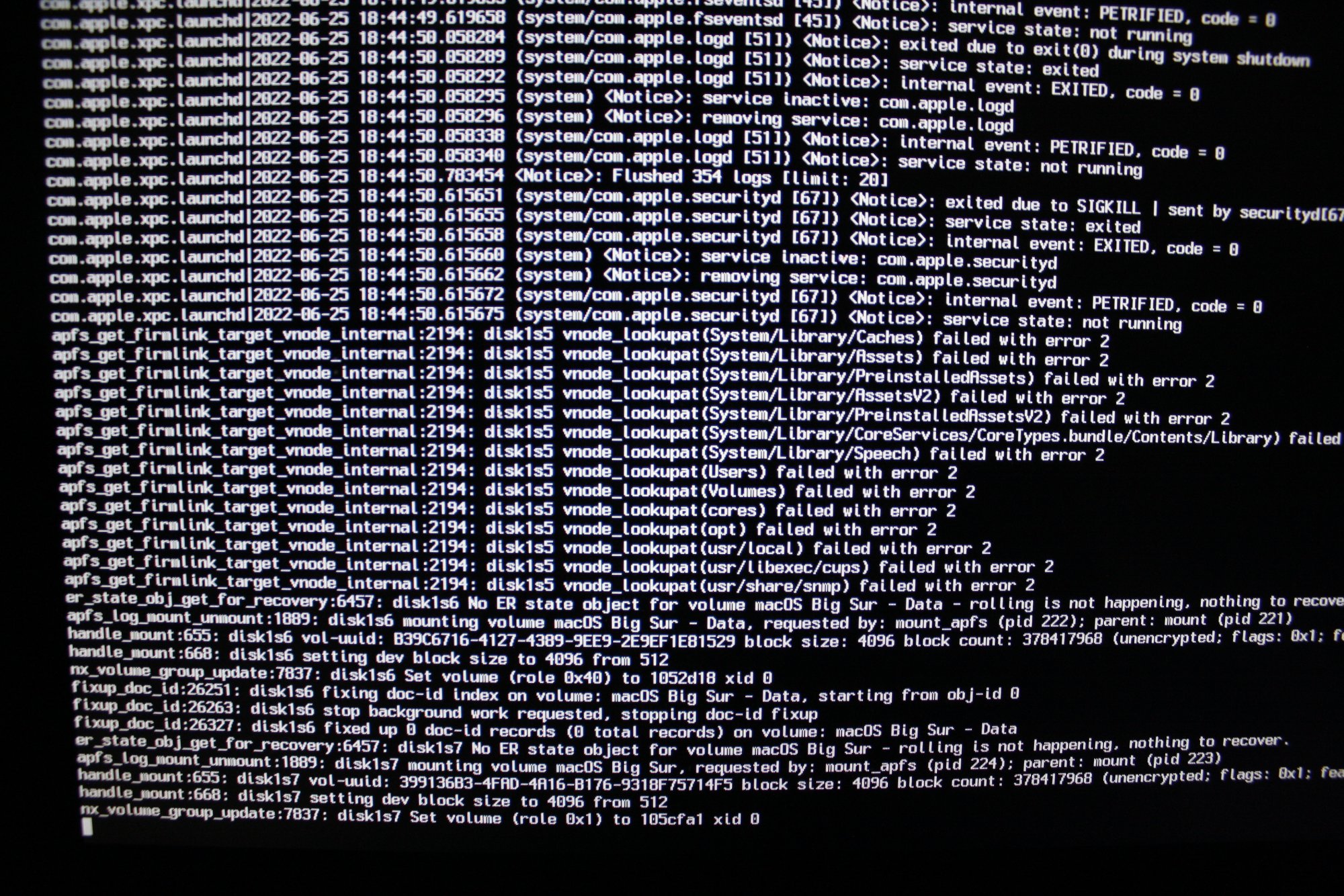

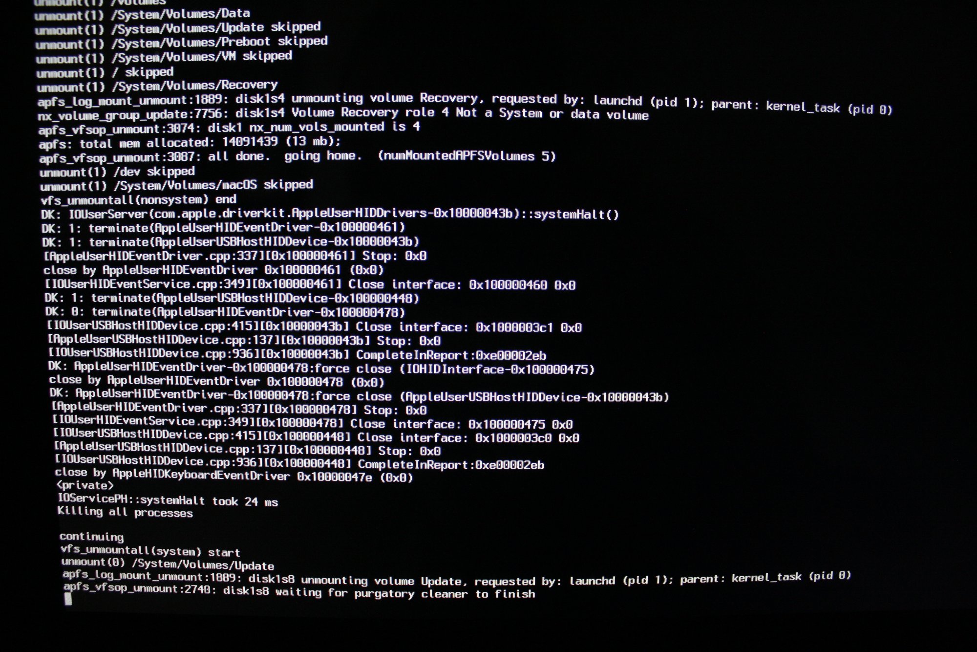

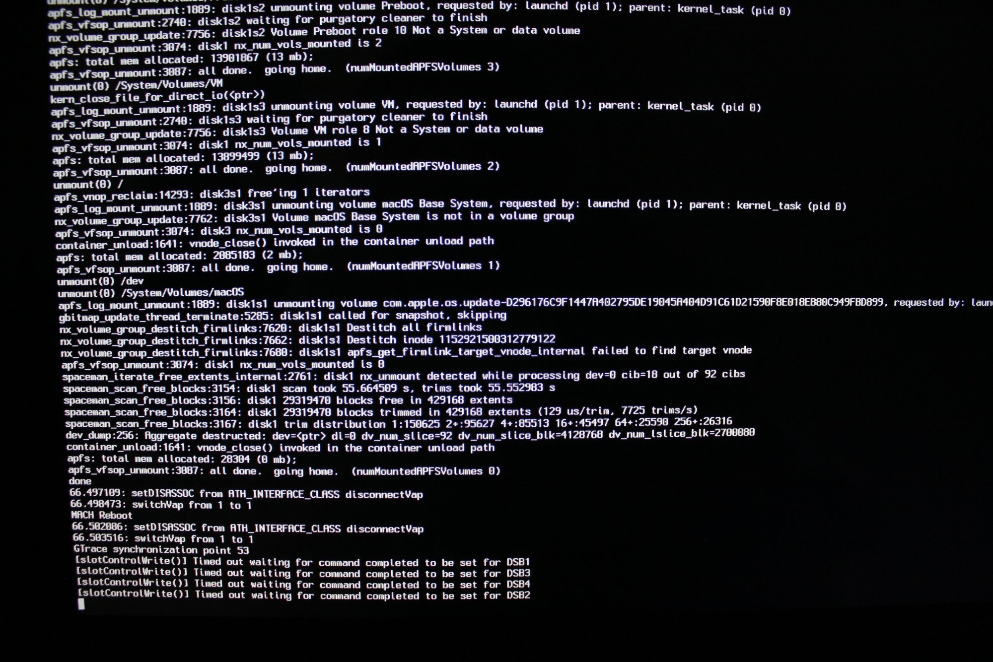

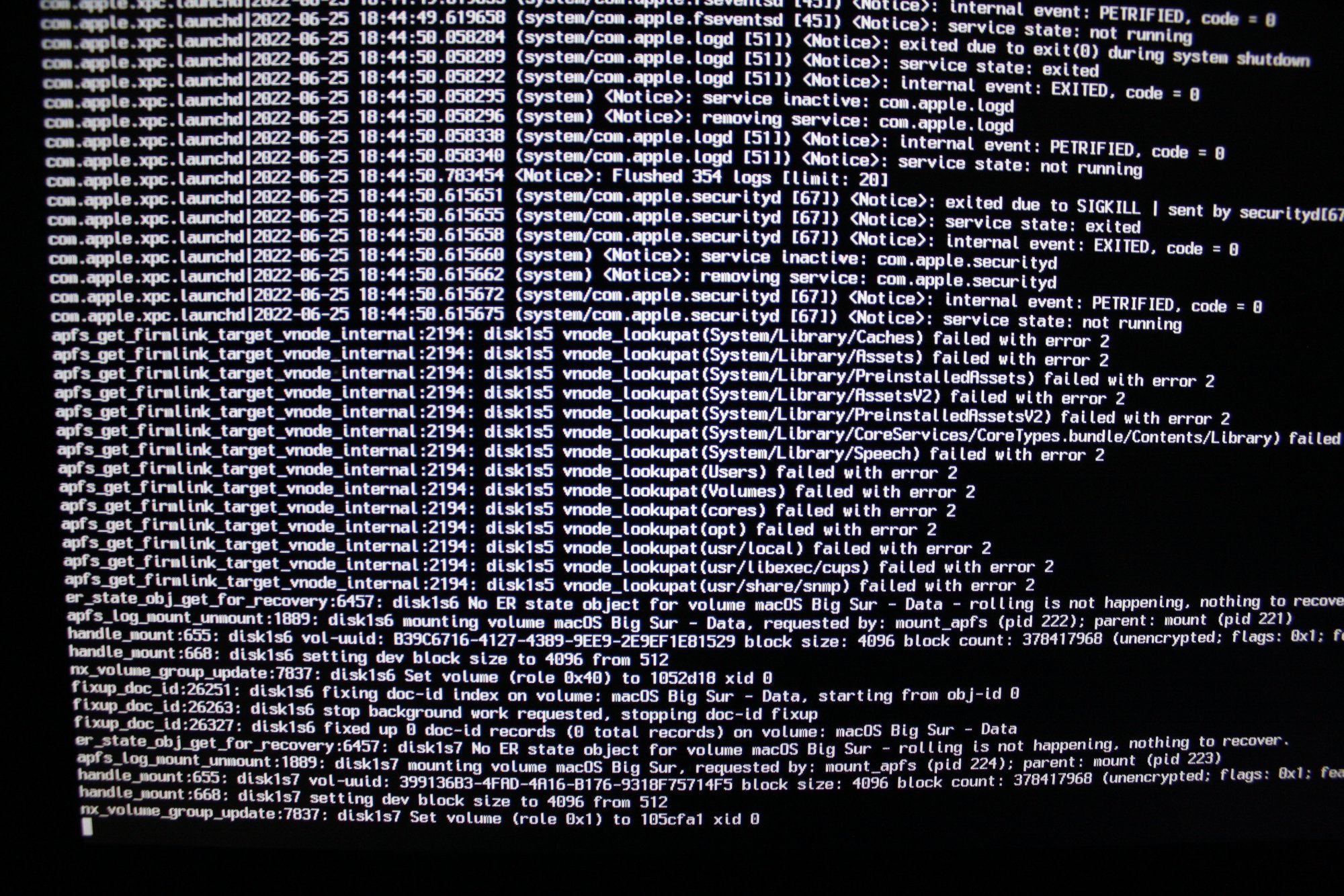

Here's what I was able to capture in the last few seconds before it reboots. The 4th image is the last thing I can see. In the second image it says "Killing all processes" which I don't know if that means it was supposed to shut down or if it shut down because of an error.
I wonder if maybe a shutdown was initiated sometime before this and the actual error happened earlier.
This is happening during first attempted boot into Monterey after installer has completed, but before root patches auto install themselves.
Edit: Added more images in correct order
