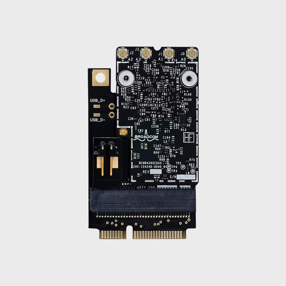

Hello,
Can anyone advise me which wifi card and adapter I should buy to update my original card from my CMP 3.1 from 2008. Is it the same as for 5.1… you have to have an extension cable? Thanks

You don´t need the extension cable por por the bluetooth part on the 3,1.
