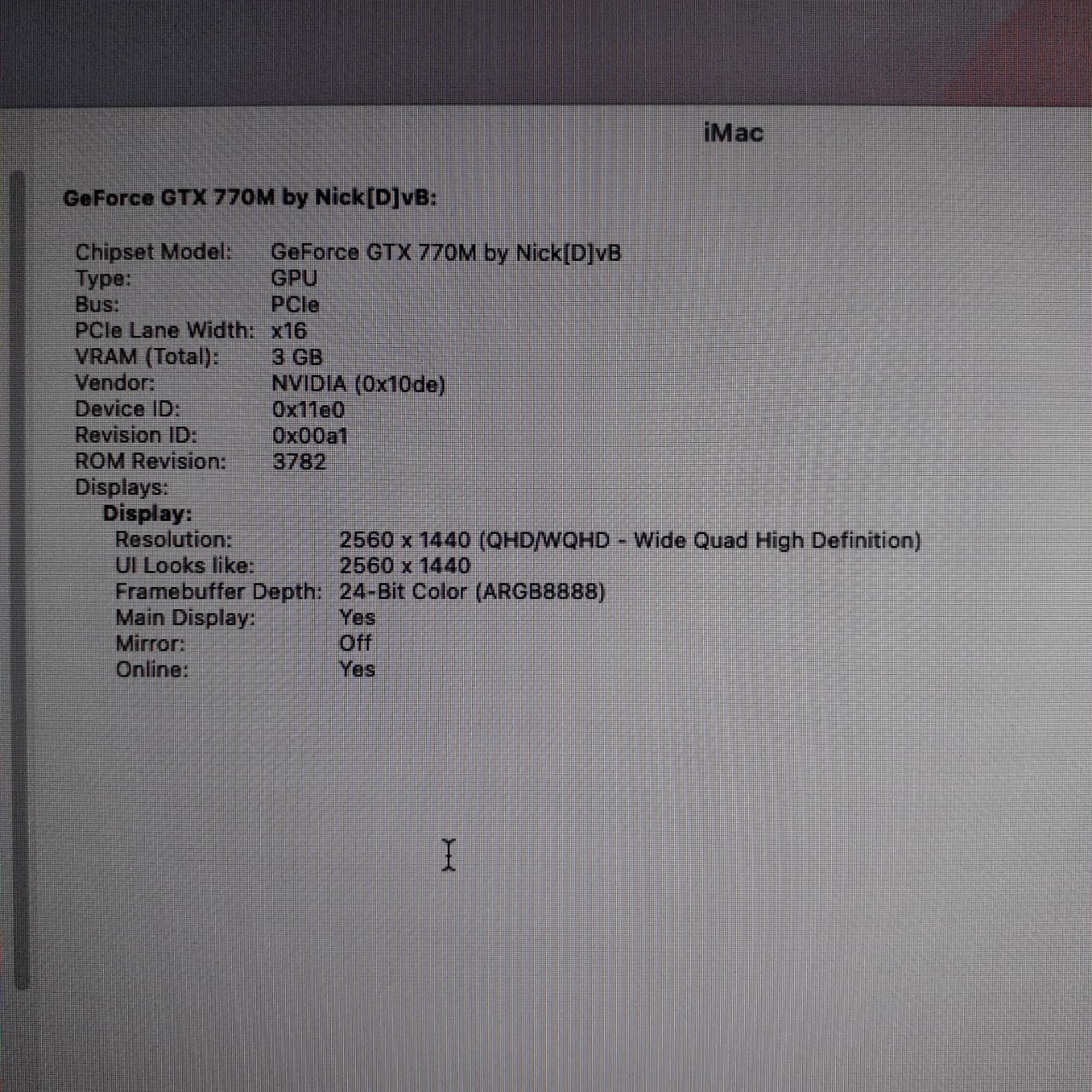

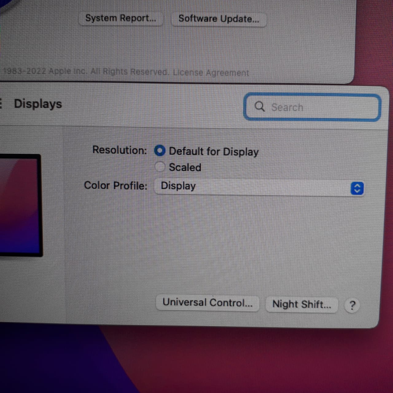

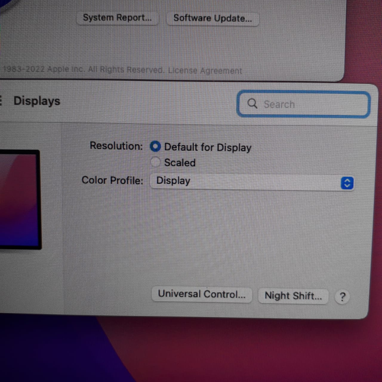

Which vBIOS version do you have installed? Does this version support brightness control on your system?
If not check back on the iMac GPU thread in case you missed the vBIOS update posted more than a year ago.
I don't know exactly which version. This version that is installed does not support native brightness control. I will revisit the topic about the iMac GPU and see how the vBios update procedure does. The current version installed on the GPU is well over 1 year old.

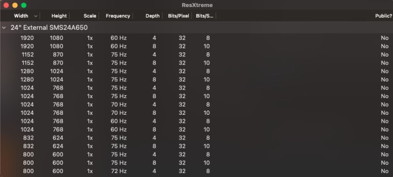

I want to get the gt630 working properly on my hack, the frame buffers are guessed at 4 HDMIs. The question I have for you is do you know if this is a patch on something like nvidia resman or something? In that case would be doable on a hack. Would even be happy staying on big sur if could get the correct FBs.
Was a MVC and tried flashing back to factory but that was not the right guess! Though expensive for what it was did not care since could now use the rx580 in the cMP haha... Plus had bought a gtx 780 thought to be regular for super cheap turned out to be MVC...

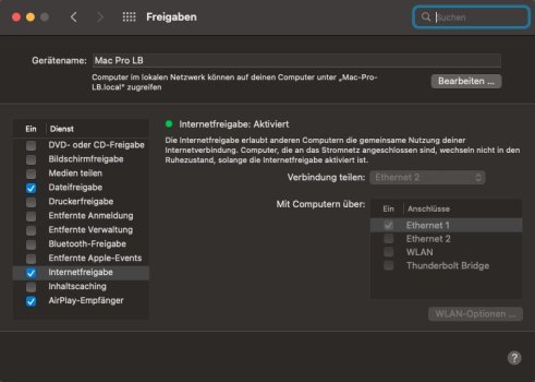

Hey all. I have 12.5.1 running under OCLP 0.4.10 on a mac pro 5,1. I just noticed that under system prefs->sharing->media sharing, nothing appears. The preference pane is missing. Also other computers on the LAN cannot load the music library. Any ideas?

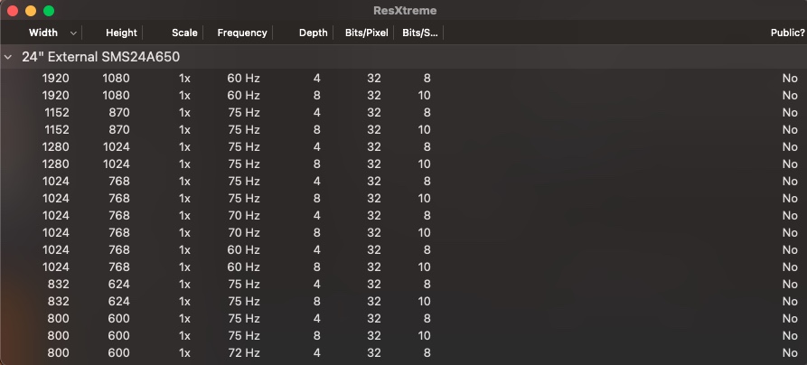

Don´t know exactly how you want to split the outputs to 4 displays, but I found the tool ResXtreme very helpful for modifying screen rez and colour depth/pixel. The tool still runs fine on Monterey. Perhaps contacting the author for source code or implementation of new features can be a way?

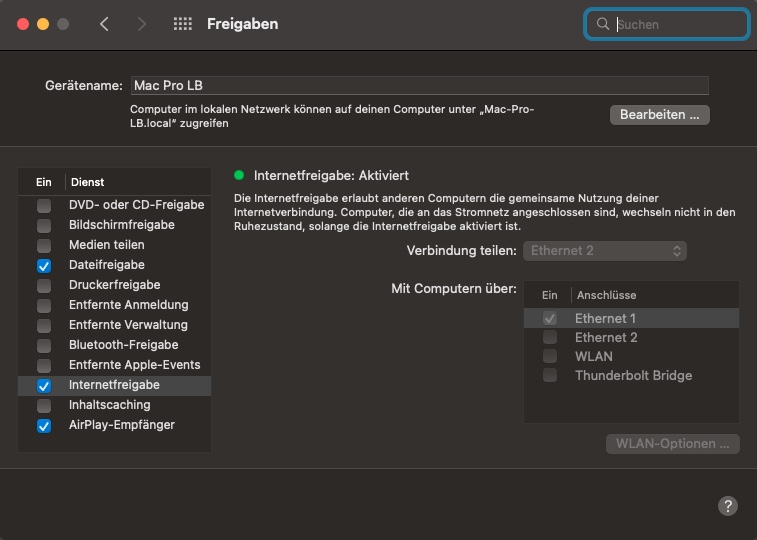

Hm. Just checked. Pane and entry (3rd from top) are there with my 12.5.1 on Mac Pro 5,1. Patched also with 0.4.10.

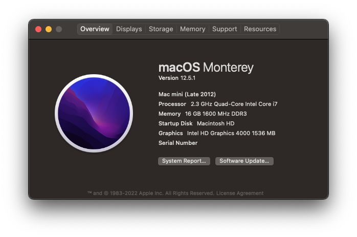

12.5.1 runs just fine on my Ivy Bridge mini.
I ended up going back to Big Sur on my MM6,1. I have the i5 one. 12.5 worked perfectly but the 12.5.1 did something weird. After the install it was continually blue screening on boot - got into safe mode to re-install the Root Volume patches and it would not accept my password to elevate to root privileges even though it works everywhere else. Downloaded the TUI version from the github but even though it said it was installing the patches it still would only boot in safe mode except for the occasional random time. Plus the Time Machine Migration Assistant (when it did boot) would go through the motions of reinstalling all apps and user data but after reboot - nothing was copied off and it wouldn't boot unless in safe mode. TBH it's no longer an important mac - I only run Logic on it!
