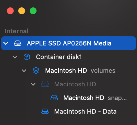

Thanks! Just so I'm clear, wiping the blade SSD and reformatting as GUID with Disk Utility will be sufficient to remove OC? i.e. I don't need to use this terminal technique?
This is a removal procedure, not cleaning your disk procedure. It merely removes OC from the disk leaving all data intact apart from the OC being removed.
By reformatting the drive (not the volume, mind you, click on the hardware drive in Disk Utility and not on the volume in Disk Utility):
you wipe the disk clean wholesale and two partitions are created from scratch, the invisible EFI partition and the partition containing APFS... well, containers, that constitute the usual volumes.
