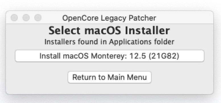

The first item definitely addresses the duplicate OS issue- nice. I wonder if that second item addresses the "anomalous" OS build issue that I observed? i.e. installing a different OS version and build than the one selected for download. I'm still trying to figure out where OCLP came up with Monterey 12.5 (21G82).
This picture says it found the installer in your Applications folder, meaning it’s already an installer you had on your machine. Try deleting that from the apps folder and see if it will let you download the newer 12.5.1 installer.

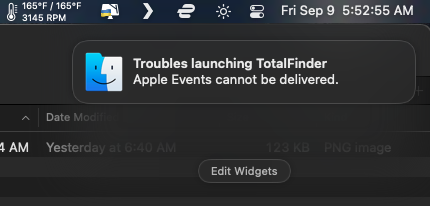

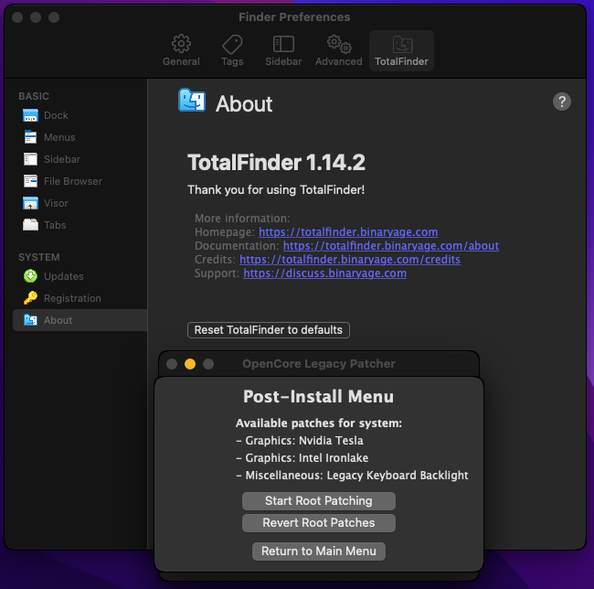

Weird issue with OCLP post-install root patches. Applying them causes TotalFinder to throw the "Apple Events cannot be delivered" error message.
Post-root patch:

What in these 3 patches would cause that?
Pre-root patch:
Any thoughts or help would be appreciated. Thank You.

Did you make sure to disable SIP? SIP needs to be disabled fully for using totalfinder iirc
SIP settings aren't an issue as I am still booted into macOS with OCLP SIP settings. In any case, per the BinaryAge dev,
TotalFinder requires that you have at least CSR_ALLOW_TASK_FOR_PID and CSR_ALLOW_UNRESTRICTED_FS disabled, in addition to whatever else may already have been disabled for you.
OCLP by default has Unrestricted_FS and Unauthenticated_ROOT on my machine, I'm simply adding Task_for_PID
Regardless, I have already tried fully disabling SIP in both the GUI and TUI versions of OCLP. Reset NVRAM, rebooted etc etc. The only way to have TF show up is to revert the post-install root patches. Again for my machine.
