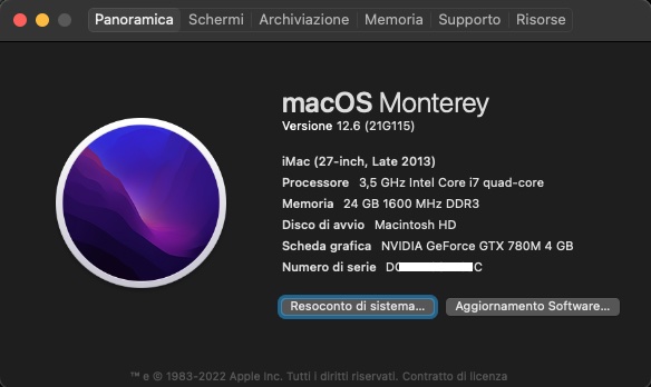

I just updated macOS to version 12.6, via OTA, in my iMac 14,2 (late 2013)
with i7 CPU and nNvidia video card ("Kepler" series).
110% SUCCESS!
After rebooting, OpenCore Legacy Patcher asks me to install the Post Install Patch.
I agree, OCLP proceeds to patch the System and after the new reboot everything works perfectly.

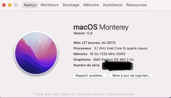

Hello,
I have upgraded (OTA upgrade) my test iMac 27 mi 2011 (WX4130 + BCM94360CD) from Monterey 12.5.1 to Monterey 12.6 without problem:
Thank you to the various people on this forum who advised, a few years ago, the right graphics card (AMD 🙂)

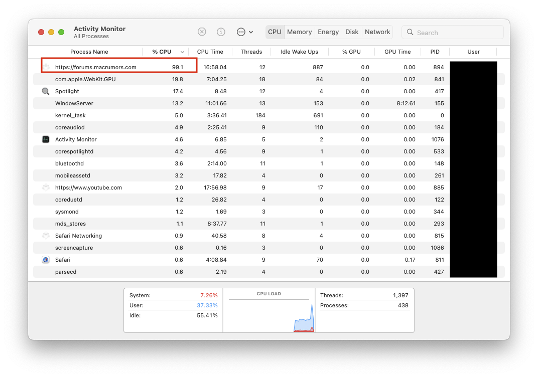

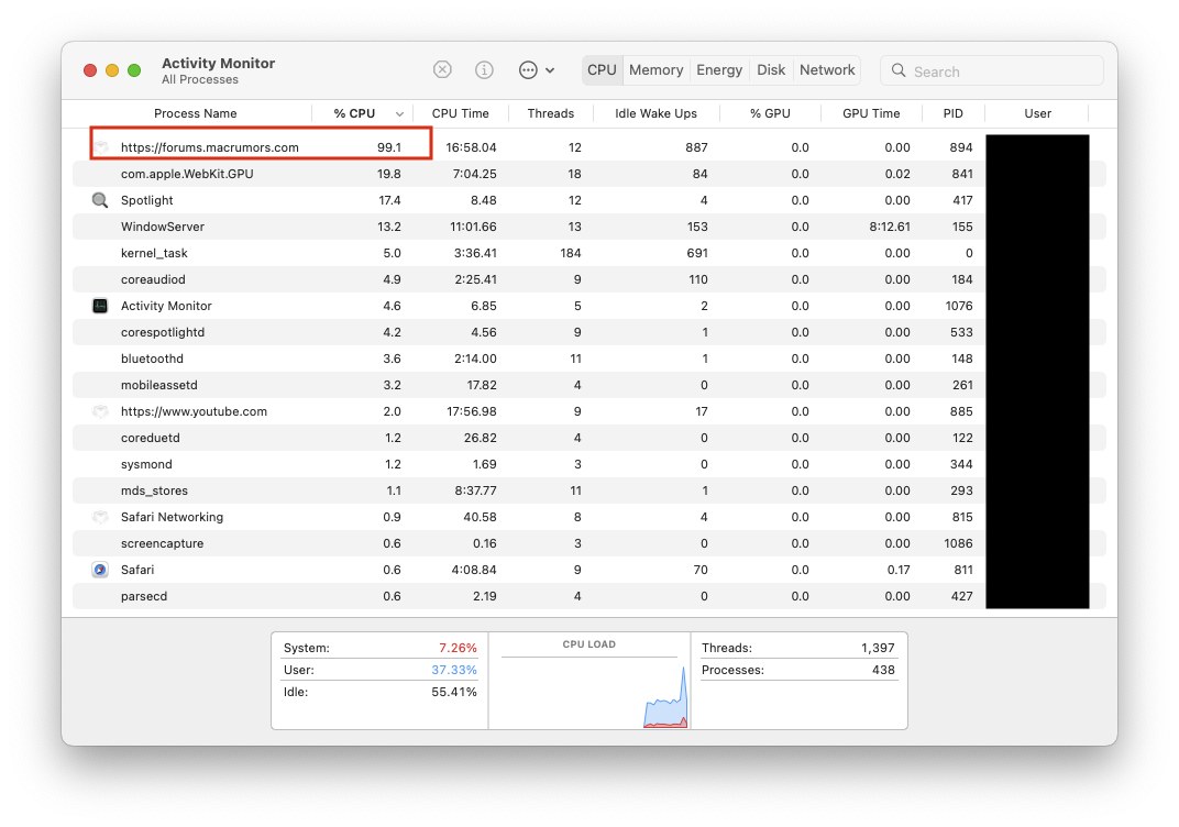

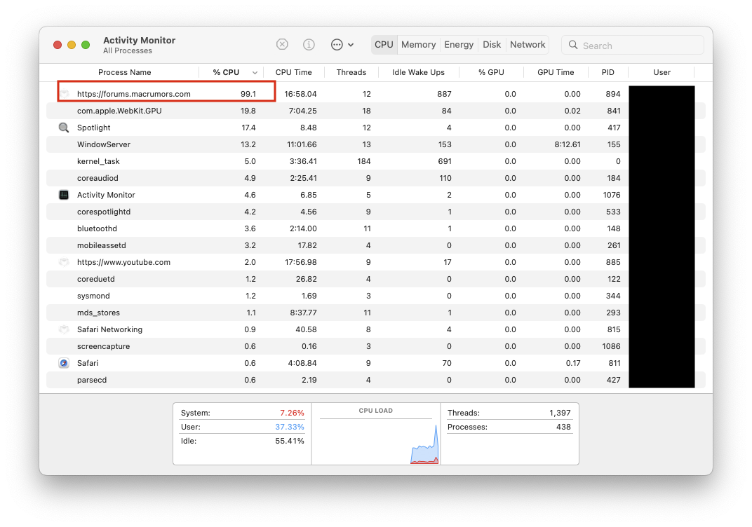

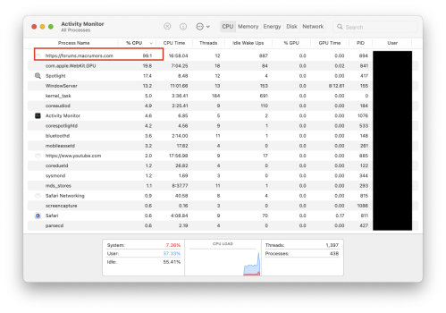

I hear you. I'm getting the lovely banner "This webpage is using significant energy. Closing it may improve the responsiveness of your Mac" on EVERY tab (even though I only have two tabs open.) I've had eight tabs open on the previous Safari with no lag whatsoever.
Check this out. Typing this post takes about ten minutes because the typing appears one letter at a time very slowly.
I'm not seeing any issues so far today. The "significant energy" error is common even on supported Macs. Long-time problem.
